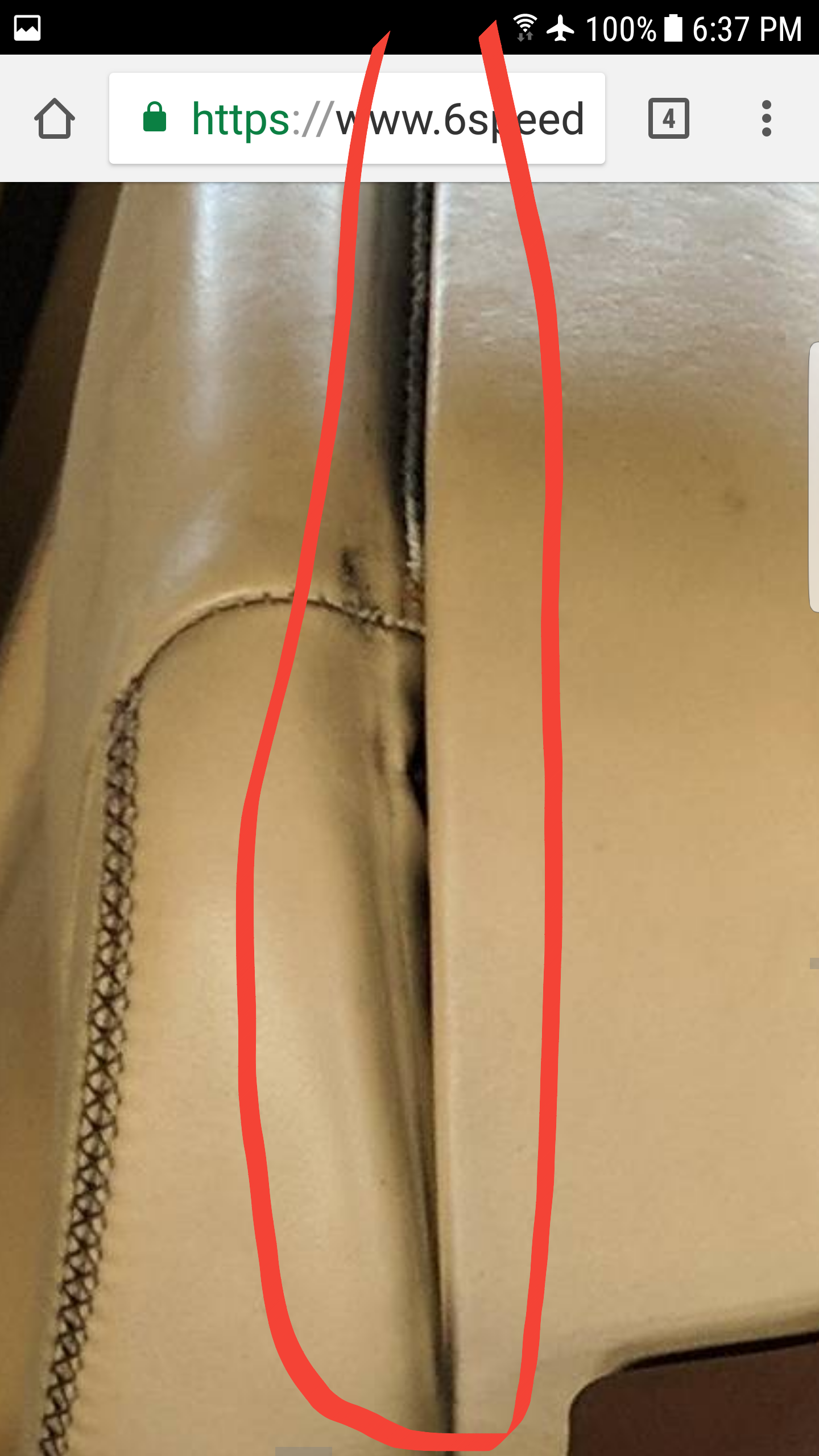

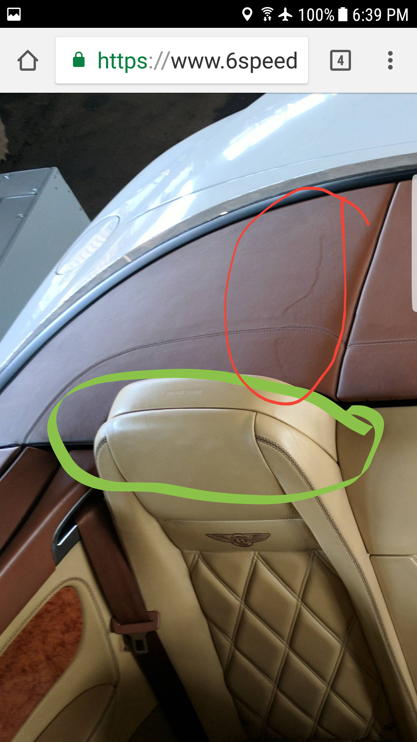

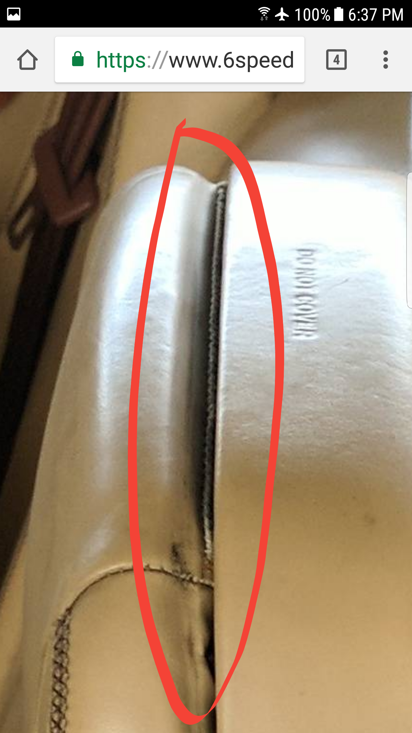

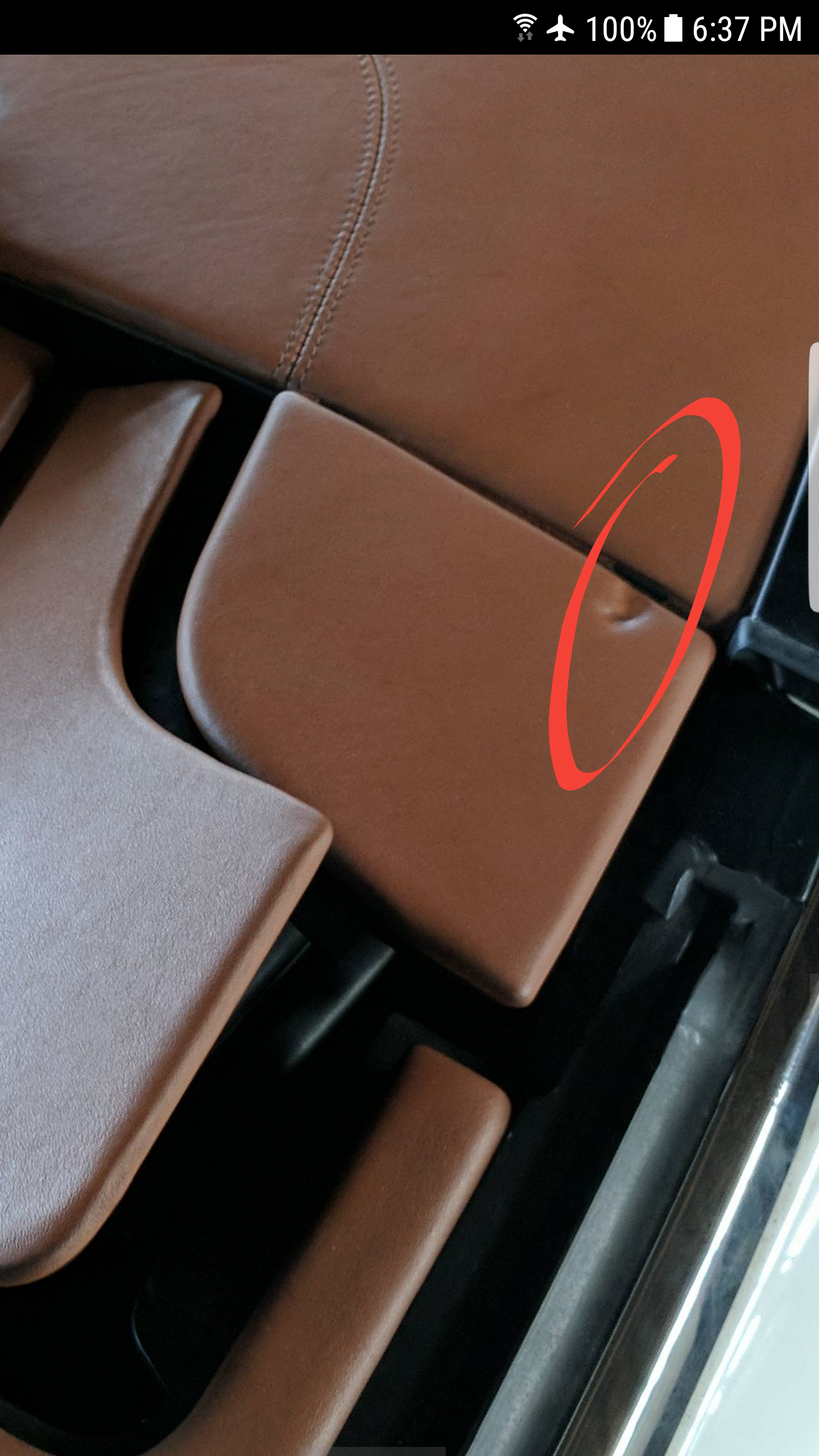

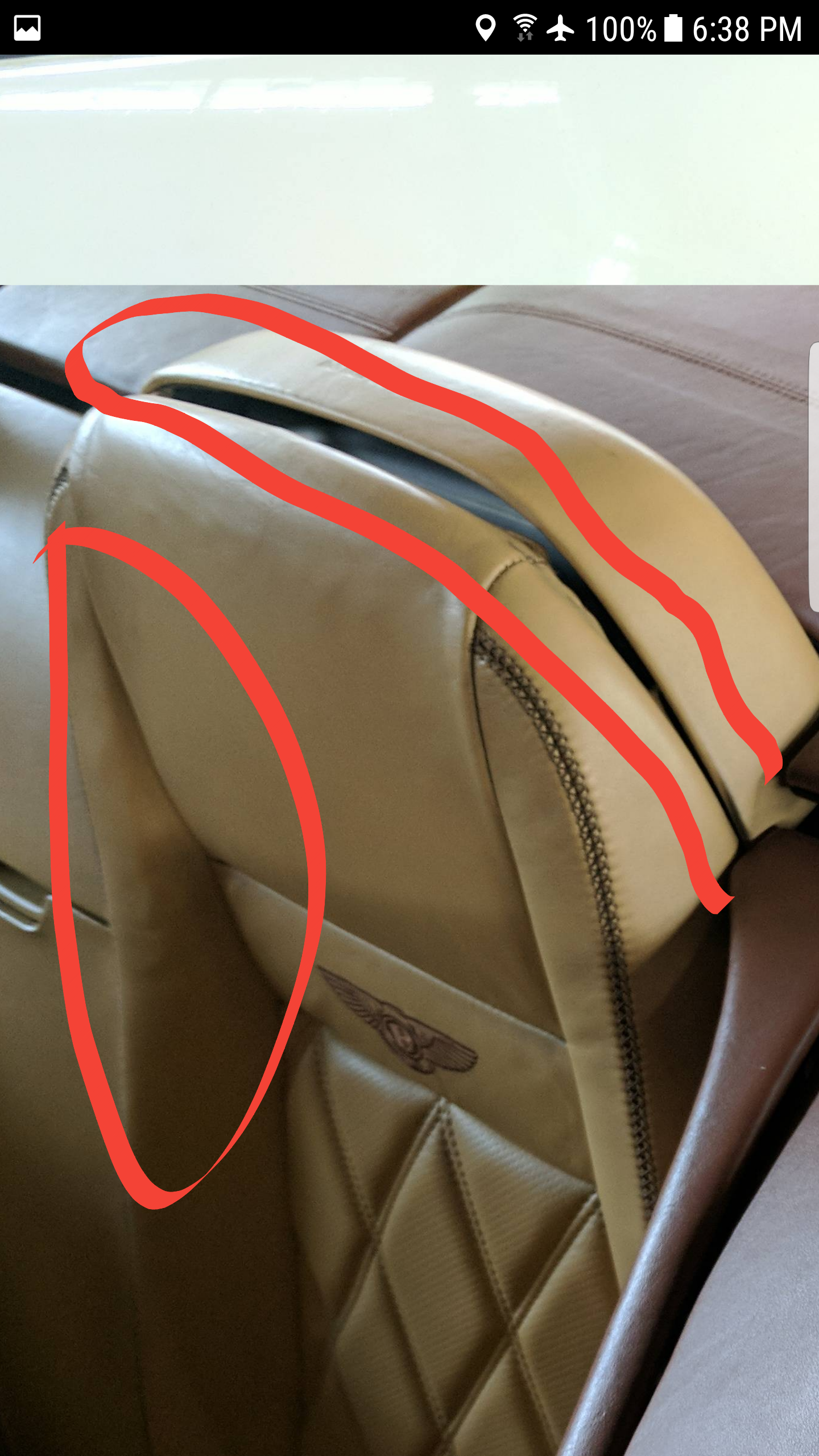

Hello Darkostoj,
May I ask how long you have had the vehicle, how long has it been doing this, and to your knowledge has the vehicle been in any type of collision ?
I ask because of the condition of the seat, and the deck, along with the flap, see pictures, red circles = bad, green = good.
Just a note, I did see what you described once in a YouTube video of a brand-new GTC, the same exact drivers side flap was up when the top was all down, it caught my eye, iirc he put the top back up a ways, then back down, and all was good, but that should not have happened, especially since it was brand-new......
