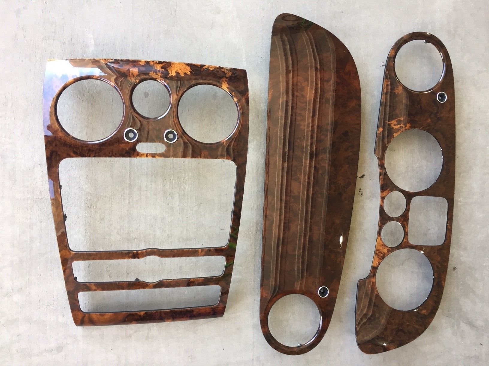

I found the 3 dash inserts I am changing to piano black at a wrecker. They came complete with vents, clock, etc, but here they are stripped and ready to prep for paint.
Now, after wet sand, etching primer, black base, several clear coats, color sand, polish with 3M professional rubbing compound, polishing and ultrafine compounds and a final Zymol wax coat, the dash panels look like this:

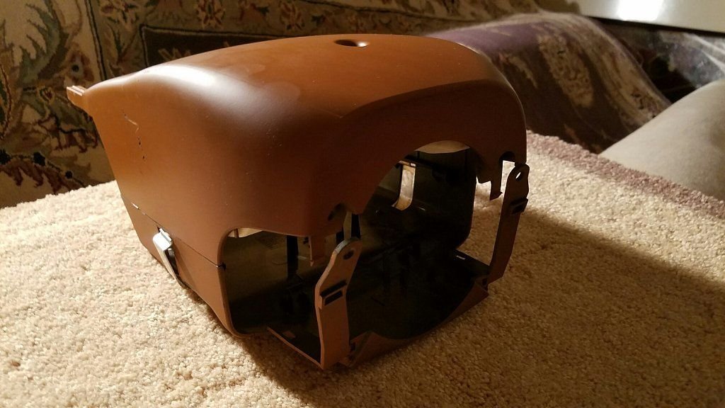

Hello BWings,
You can have this for the cost of shipping to add to making your column black, it does have a few marks, but sanding and painting black should conceal them.
. https://www.6speedonline.com/forums/...arts-here.html

Thanks for the offer. Coincidentally, I negotiated one from a breaker on Friday. It is black already so I will have no prep/painting to do. I've shopped these for a couple months. There are lots of them out there, but they all are missing the two ears/covers that surround the shift paddles and stalks. Looks like yours are too. Also, the one I got has the black leather dress hood attached.
Thanks again, I'm good on this part.

That's the way to do it, glad you found one in black, I do have the two pieces also, they just didn't make the photos earlier.

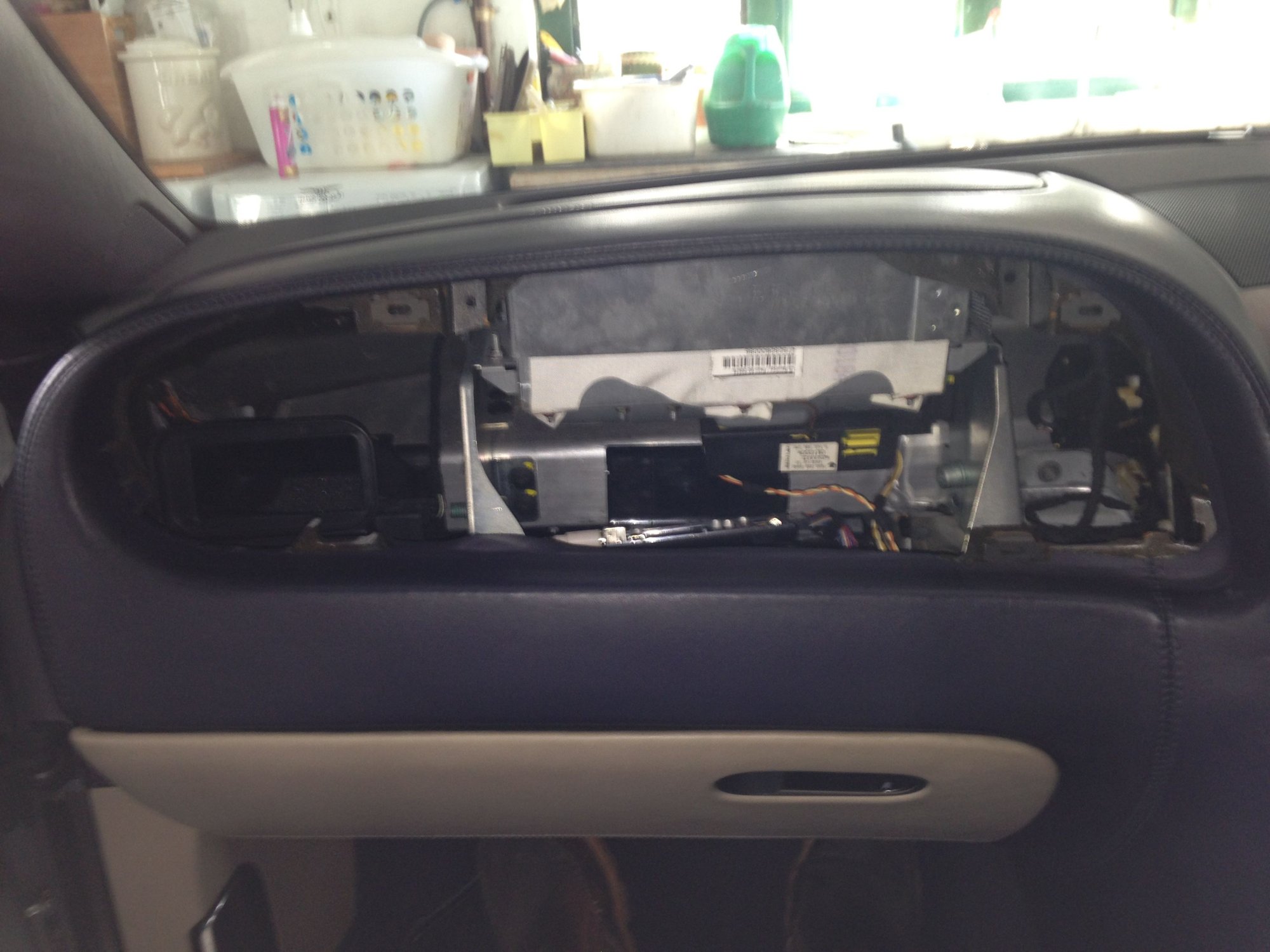

Removal
Hello John,
Putting your fingers into the vent and giving a good yank will dislodge the trim on the vent side, then work a plastic trim removal tool to remove the side opposite the vent, BUT, PLEASE Be very careful with any type of tool you use as you could leave marks, or indentations in the leather, I believe I just pulled the vent side out as stated, but then just worked my fingers over to the other side, don't pull out on to far of an angle as you may bend the pins attached to the trim.
Also note, there are no mounting pins in the center, only at the ends as pictured.

Just one add to JHs reply. Notice in his first two pics, there is a solid tapered pin next to two of the snap-in (bullet) pins, one in each corner. These align and fit into guide slots along with the snap pins that lock/unlock the panel.
Because of these tapered guide/locator pins, (and on all 3 dash panels) the dash panels do not lend themselves to fully releasing from only one long end. Instead, they were meant to come out/install more like straight out/in. I agree with johnny, I used the vent, reaching in with a couple of fingers on one end, but I did use an upholstery tool on the other end to gently prod along the opposite end.
BTW, if you pull hard just on the vent end, the panel will bind up on the vent as well. Also, on the reinstall, since these pins can get a little corroded in place over time making them difficult to remove/insert, I coated all of the pins with a very small touch of dielectric grease, so next time out they won't need the same amount of force.

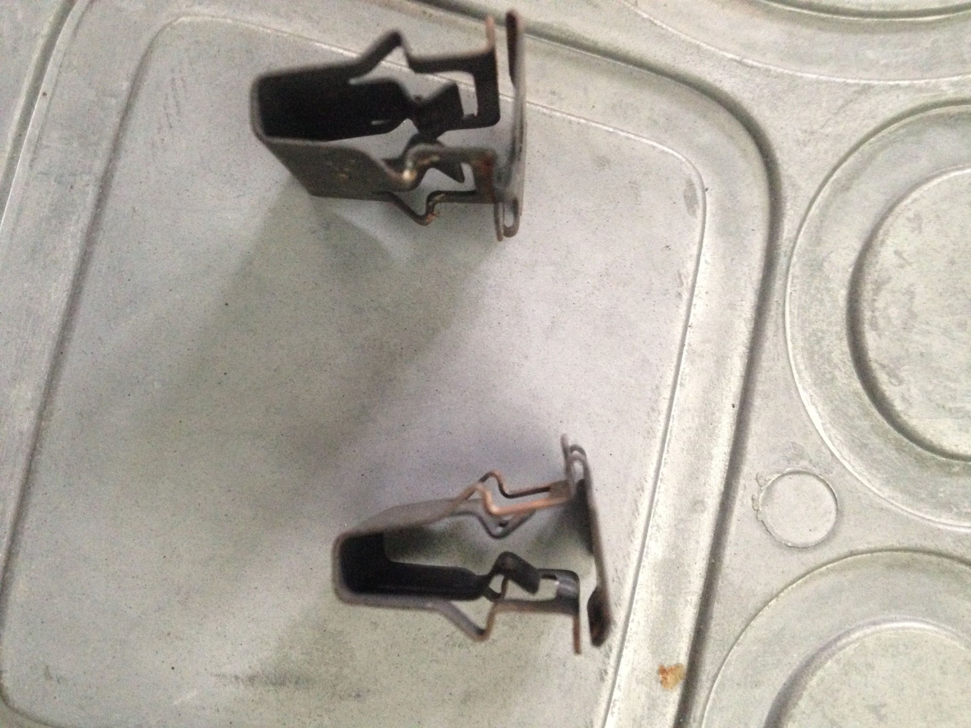

Dash panal gap fix
Following the good advice here-https://www.6speedonline.com/forums/...r-project.html
I managemend to fix a long standing bug
Before see the gap RHS just keeps unpopping
Cover off ,came off easy once you know how Lower LHS # clip holder ,not the cause here .
It was a loose clip I thightened them up , pressed the edges together and squeezed the rear bit closer so it would grip more .You can test on the panal while it’s out before refitted to test the grip
Done gap normal / gone
panal fits tight .
