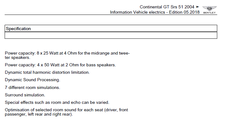

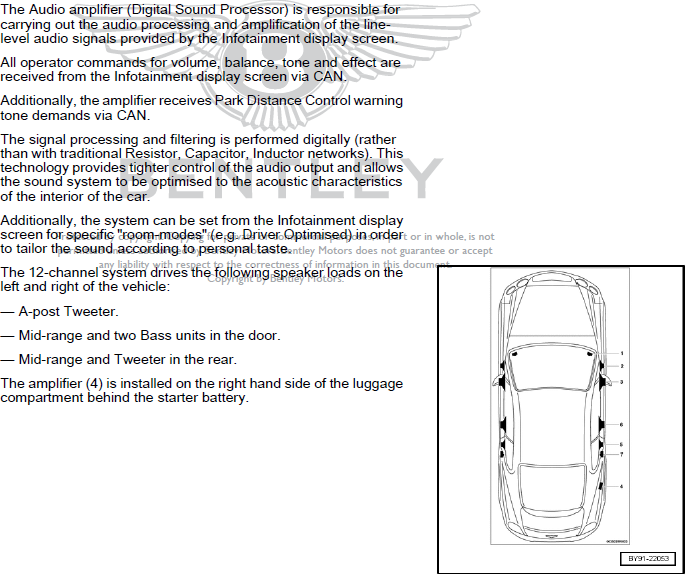

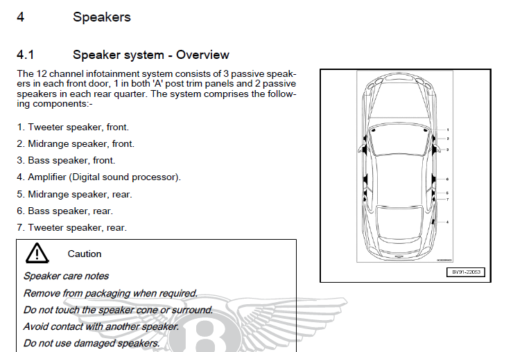

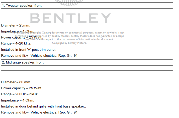

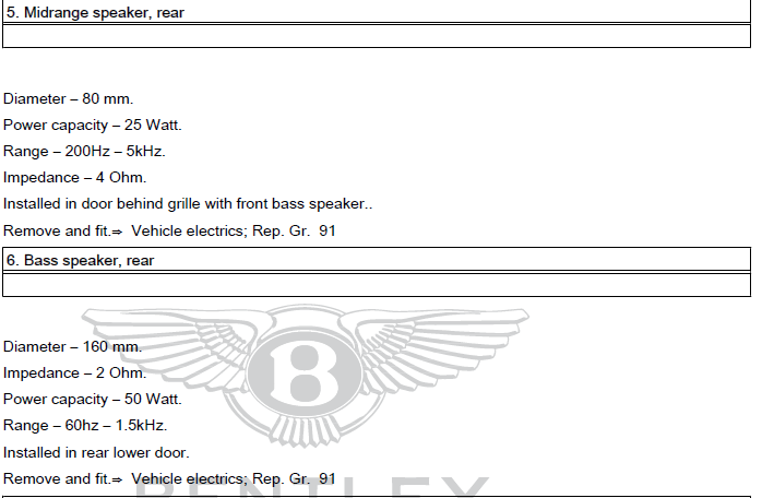

Hello Moonbeam,
Here are some specs for the base non-Naim system, I to have wondered and have asked some members if their 08 and ups had the rear tweeters as the 2004-07 have, it is odd that there are a few different stock base model amps for the GT, my 05 had the 12 speakers with the 12 channel amp, my 06 parts GT had the same, yet I see others with a 2008 with the 8 channel amp with 10 speakers, like Bentley removed the rear tweeters in the GT for 2008 and forward to a point, my 2005 GT that is now part 05, 06, 07,10, and 2014 now has the Naim system 15 channel amp, and head unit, I added the front center channel speaker and 2 subs in the rear, so now a 15 channel surround system, or 13.2 with all the stock speakers for now, but to be honest it way loud and clear with these stock speakers.
Johnny

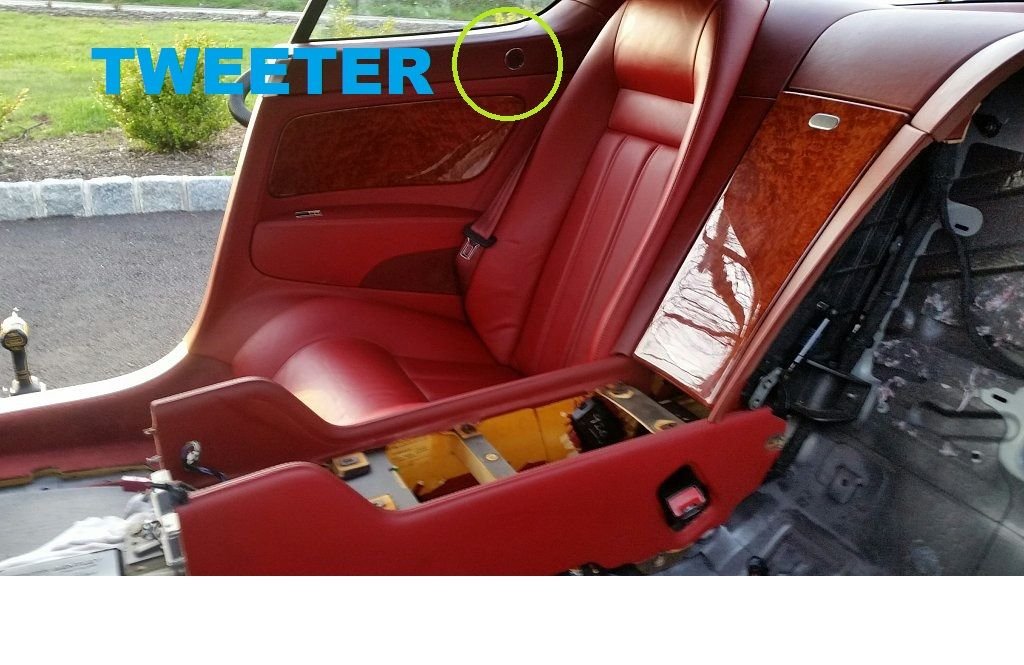

Rear Tweeter.
