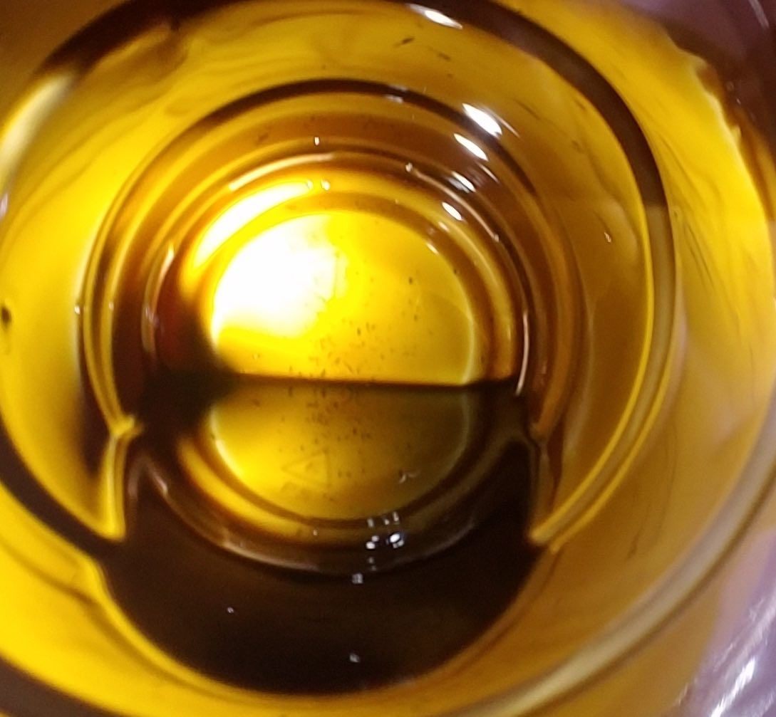

Both intercooler tubes look fine. The inside of the passenger intercooler looks super clean, slight oil residue on the tube, but not one drop. The driver side had 2 or 3 oz of oil plus metal shavings (I am 90% sure that these are fine metal shavings and not some other crap), plus the inside of the intercooler is covered in oil. I was planning on sticking the camera up there, but I took a break when I saw the metal shavings.

Take a magnet to the metal shavings, see if they stick, that would be steel.
Probably aluminum shavings pointing to impeller beginning to disintegrate. Sometimes the oily residue has little shiny aluminum shavings, we don't like to see that. Shouldn't be any shavings. Oil accumulation is normal since the intercooler is a condensate trap for oil mist that circulates inside a working engine.

The metal is not magnetic. The below pic was out of focus, but it gives an idea of how much metal was at the bottom of the red cup I poured the 3oz of oil from the driver side into. I snaked the camera up the intercooler tubes and into the intercoolers but all I was able to really see was the inside of the intercooler (passenger side clean, driver side covered in oil).
