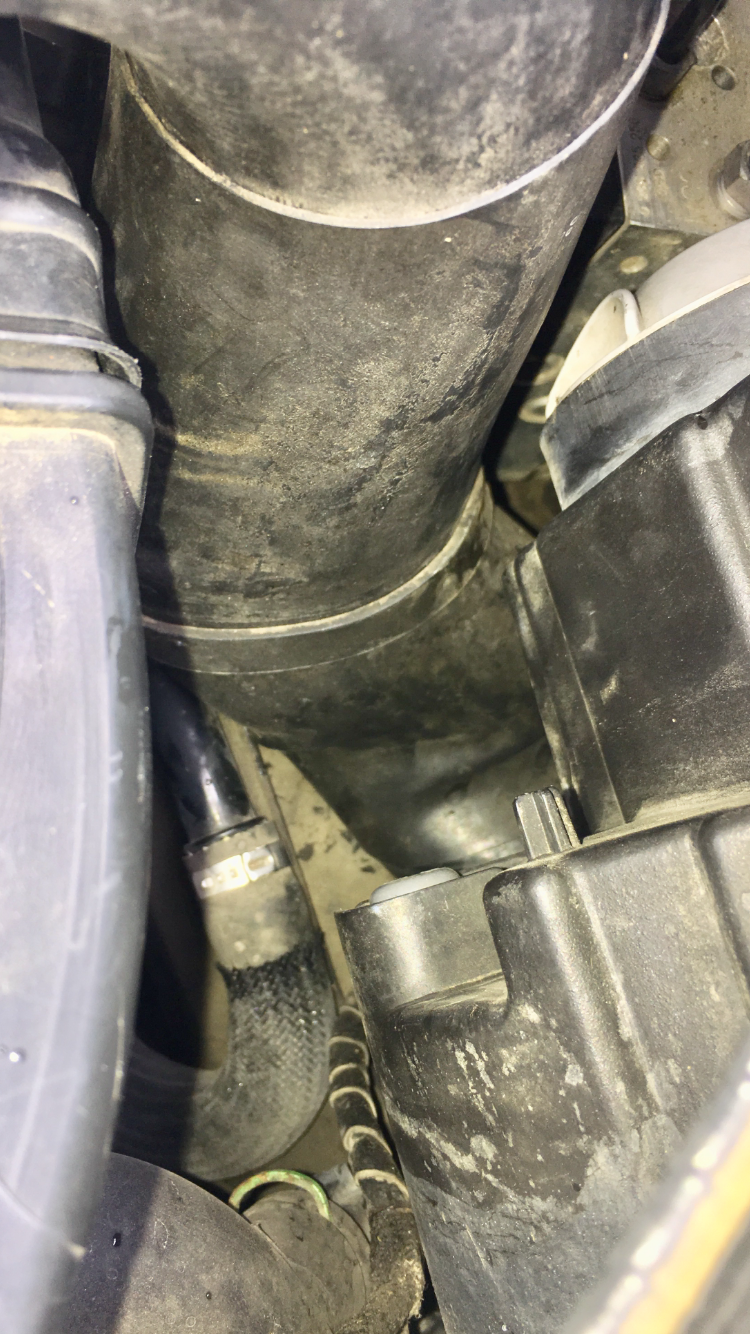

Hello my friends, thank you for your answers.....
i think i have found my problem.....
see below two pictures, what your opinion??.
Pressure hose, charge air cooler n*17

Yanacha:
I went back and reread your posts. I am still not completely clear on the issues you are experiencing. With your most recent post/pictures, if you have ANY air leaks in any of the tubing past the MAF(s), through the intercoolers, it will cause lean fueling conditions. When the ECU senses lean conditions it will set a CEL. Lean is the worse of the two conditions lean or rich. Lean can destroy an engine so the EMS is designed to protect itself. These conditions are exacerbated by heat (and warmer climate conditions).
I also reviewed the post you have that shows the cats and O2 sensors. When I follow your writing, and if I understand the question, it appears you are trying to compare the performance of two O2 sensors that might be in different positions. Think of the O2 sensors as "forward of the cat" and after the Cat. You only want to be interested in the two forward O2 sensors (before the Cats) on bank 1 and compare to same at bank two. Disregard the two after the cats for performance comparisons sake as the fronts do different things than the rears.
Finally, YES, look for any air leaks in any of the airflow tubes.

The hose become distorted, by the motor’s suction.
because this one had been wrongly place.
