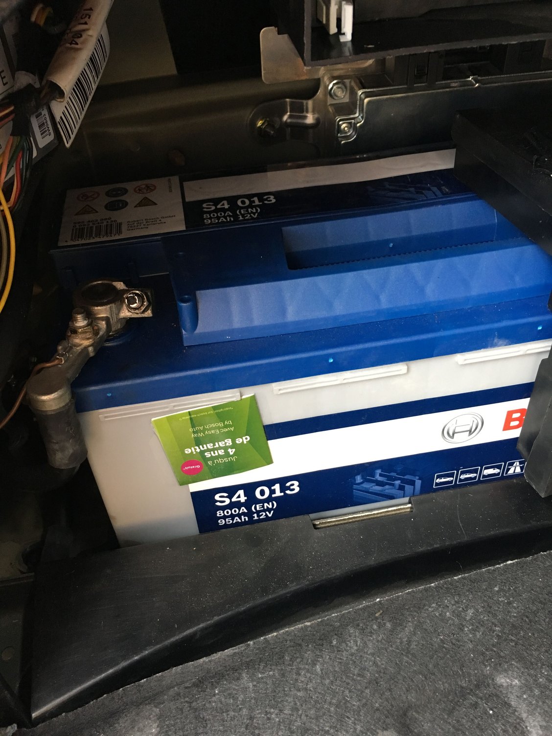

Hello friends, here is the change of the driver rating, after testing it works better, but I think one thing it is to stay for 1 month without rolling to connect to a maintenance battery charge, where all the lights are at maximum .
do you think that
little also come from the boot battery? since the service battery is replaced in December and startin batterie no

Are you asking, do you need to change your starter battery? I followed that you recently changed the main battery, and you can go one month without it being on the charger.
Please indicate what you are asking in regards to the photograph.

Hello,
I changed the electrical outlet as you told me, but I think I should have a lack of power. What is the function of the start up battery on the right side ? This is not a new one.

Originally Posted by yanacha
Hello,
This dedicated battery on the right side is used to start the car. Perhaps change that battery. Usually when the main battery is bad the starter battery is not far behind. Using a maintenance charger on the starter battery is a good idea if the car is not driven frequently.
The left battery is an AGM battery, maintained accordingly to AGM standards. The main battery can be charged through the charge port in the trunk. Verify if your battery is AGM. Some have put a standard battery [incorrectly] in substitution of an AGM.
The right side starter battery is a standard lead acid flood battery. This battery will require a direct conection to a maintenance charger.

here are the pictures of the
battery and on the small pod there is a little oxidation.

So that's your starter battery which is a conventional acid flood battery.
Please try to explain what the difficulty is. You are having trouble getting the car started??
Hello Yanacha,
I am not sure what problem you are having from your post. One comment though. The Bosch S4 is sized for an intermediate size car as it is too small for either side on a 2005 Bentley W12. I use Bosch and I have an S6 on the main side and an S5 for the starter battery.
