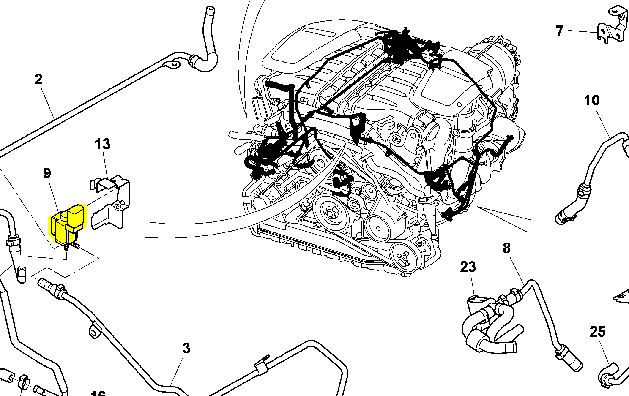

Is the error the "Turbo wastegate solenoid" ? If so, the part # is 3W0612041A. (for bank 1 [left bank when looking at the engine from the front of the car) Here is a diagram of its location (Shudder). See the yellow highlight for #15.

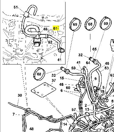

The part # for bank 2 (right bank when looking at the engine from the front) is 3W0612041BM See the second diagram item #51

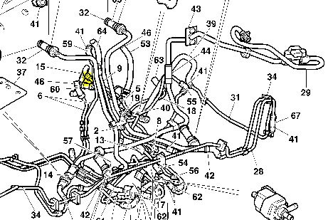

NOTE: There is also a Turbo Wastegate Bypass control solenoid. Part # 037906283C (see the third diagram) Item #9. There is another turbo wastegate control switch on the opposite side. See item #23 in diagram 3. It is an electric switch over valve.

Wow that looks like an absolubt nightmare!
Would you get at the solonoids from underneath then?
Do you believe it could be number 3 then and not what the error code is saying. Thing is It just seems strange that it's only done it when filled up, maybe I need to put into someone to get it diagnosed fully on a proper computer if that will help.
