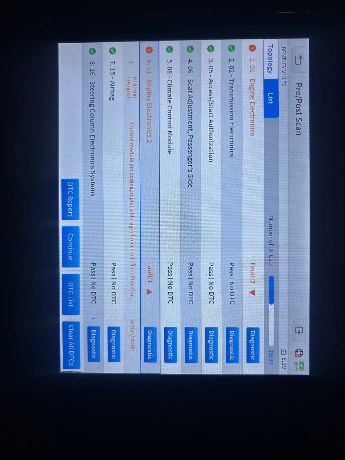

Could you please share your experience regarding DTC P192400? I’m facing a similar issue with the following fault description: “Control Module Pin Coding – Implausible Signal / Mechanical Malfunction” on a Bentley W12 engine.
The engine is cranking but not starting. I’m unsure whether this fault points to a problem with the ECM itself or possibly a wiring issue.
Please see the attached files for reference. Your input would be highly appreciated.
Hamid

Flipped for ease of viewing.
