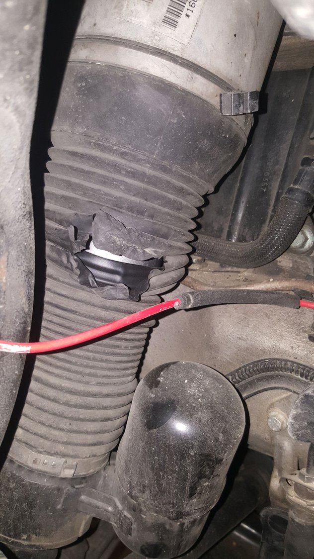

All the above are contributors. Tire blowouts are not that common anymore either. The air bellow is just above where the protective shroud hole is. The air bellow is inside an aluminum encasement. Perhaps the strut took a torsional hit in the accident. Albeit amazing that nothing happened sooner. Also the vibration at 90 miles per hour may have stressed the system. Perhaps once the unit is removed the problem will be more apparent. Please post photographs once the strut is removed.
Hi guys, there it is. Looking up into the strut, fully compressed. The hole is pretty obvious, the rest of the air bellow looks shiny like new...
I would appreciate your thoughts.
Yah Rooks, one can see the damage would be great to find out what caused it, If I can recall some did mention the rubber detriating over time but lets see what you find ...

Hello Samhain,
That is not how the system works, when "Jack Mode " is used it stops the system from working, meaning the compressor will not run, nor do the level sensors work.
Also, the system works the total opposite of your comment, when the vehicle is lifted not using jack mode, the wheels / suspension are hanging down, therefore the suspension system sees the vehicle as too high, and if NOT in jack mode it would release the air in the air bladder struts to lower it, (although it does not lower because it is hanging, but depletes the air in said struts) then when the vehicle is lowered to the ground on the lift it will fall to the ground making it not possible in most cases to get the lift arms pulled out from under the vehicle, you then have to wait for the system to refill and lift, jack mode is also mostly for use when changing a flat tire as to not have the suspension system kick on while jacking up one wheel and have vehicle movement, I had it happen late one rainy night on my W12 A8l, thankfully I had put the flat under the side rail of front passenger door, as I was lifting the spare into place the vehicle fell, the Audi A8L has a very cheap unsafe jack as it is, and not using jack mode allowed just enough movement for the jack to fall over.

Hello Rooks,
Just to give you some insight as to what you may think caused this failure, I do not see any damage around the blowout area, and if the damage came from the prior accident, you or your guy working on the vehicle after said accident should have seen some marring or a tear in the accordion section that is now blown out, if you had no marks in the area then this is simply a blowout of the strut bladder which is very common on the D3 A8, A8L, and S8's 2003-2010 which you can see over on Audiworld in the A8 D3 forum, I have also seen this here before in this forum, it happens at all stages of milage and age.
After balancing and mounting other wheels on my 05 CGT and going for a test drive, my mechanic left the car for about 15 minutes and heard a loud BANG. No prior warning or lowering whatsoever until then. How is that possible??
Did anybody experience this?
Glad this didn't happen while driving. Confirmed firsthand struts explode. Now someTLC: time labor cash.

Originally Posted by Rico.Adams
I thought this was your car, its an old thread going back 2 months, got confused when I saw your post thought I'm sure I've seen that pic before ...
Yes my car. Happened last night in the garage.
Oh sorry to hear that mate, but the pictures are from Rooks car.
These failures can happen at anytime without warning, you going to have them rebuild or replace all 4 or just the one ...
His car was the right side with the green vacuum line. My picture is the left side with the red vacuum line. I should have been more specific. In any event it is what it is and that picture was taken today.😉
I'm not doubting you my friend it's just both cars look identical.
Well as you say its another job & money hope you get it sorted mate, sorry to hear ...
