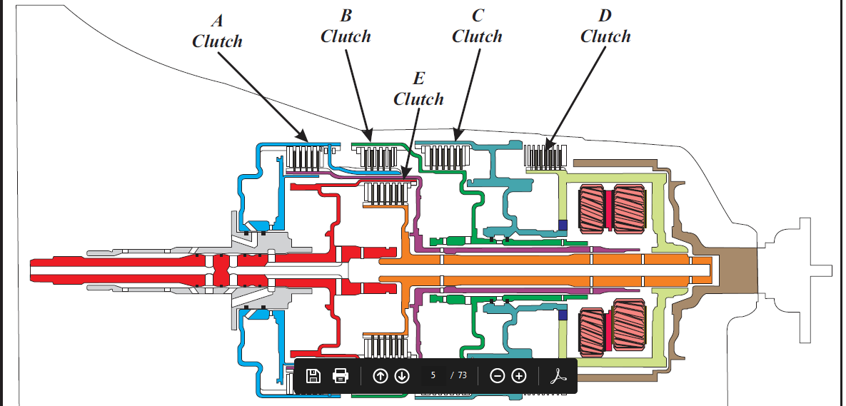

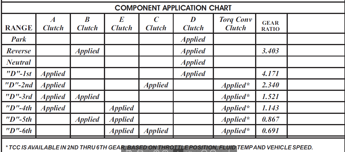

Ok, being we can not see the other side (unless you have that pic also) I am going to assume that they installed a used complete valve body with used unknown mileage solenoids into your vehicle, most likely without disassembling the solenoids from said valve body for cleaning and testing prior to install...
I can not confirm as to if solenoid 5 is 2nd gear or 5th gear at this moment, as I do not think that is the way it works, meaning the work in a certain order to operate.
Be back to you in a bit.

Hello Dav,
I really do not know what else to say, but then to have someone who works on the ZF 6HP 26A transmission take a look at it, if it is as you say and this used item was installed, please refresh my memory as to if the vehicle had any transmission problems at all when you first drove it upon purchase, as the problem here is that we have no clue as to the level of work preformed while doing said install of the used part, were the 4 tubes replaced, was the bridge seal replaced, were the solenoids resistance tested prior to install, or did the seller have this valve body installed without and of the above work done, and it did not solve the problem, so he sold it...
See these videos, and pictures. I know these are BMW videos, but it is the same setup.

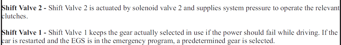

Also have a look at these, your shift value is shown as "1" in the picture you posted in other thread, that is a little odd to me, it's like its holding a gear instead of shifting, unless I am misreading the statement.
http://maybeme.com/Storage/JagTech/M...6%E2%80%9D.pdf
Again this info is for the 6HP26, it is used in many vehicles, so some info is different, such as the BMW having no gear selector cable, therefore it has extra solenoids to put it in park electronically, but still has the same basic function/operation as the Bentley 6HP26A61.

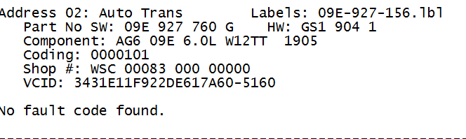

Yes, sometimes it can, as the trans ECU learns and stores the driver's driving habits and shifts accordingly, plus do we know if the replacement unit is out of the same year (2004) Bentley trans as your vehicle, maybe ask your INDY to check the coding of the trans in the scan, I do not have a scan to share at the moment but maybe someone else here can post a full scan showing their trans coding, I did find this from an 08 GT with coding 0000111, so just wondering what coding you have.
Address 02: Auto Trans Labels: 09E-927-156.lbl
Part No SW: 09E 927 760 K HW: GS1 911 4
Component: ZWGU3406 6L W12TT 3406
Revision: --H04--- Serial number: 0121868
Coding: 0000111
Shop #: WSC 00083 790 00000
VCID: 38292B490E4DF9F7665-5160
No fault code found.

Not an 04 but closer, this is an 05.
As I read through the thread, some unanswered possibilities:
If the trans was 4 liters low, this is possibly the result from someone (who doesn't know ZF transmissions) removing the fill plug with the engine not running. That would likely be 4 liters. Anyone setting the fill on a ZF correctly, at the specced oil temp with engine running, even if you were off by full operating temps, you couldn't possibly lose 4 liters. A leak is the only other possibility I can think of.
On the trans relearn, if the battery is disconnected (especially in the case of a hard reset, but doesn't need to be) the learned shift points would be lost and upon restart the learning would begin from the start. Still, even without a battery disconnect, the adaptive learning is constantly adjusting so, a new owner acquiring the car, the learn would adjust to that new driver.
