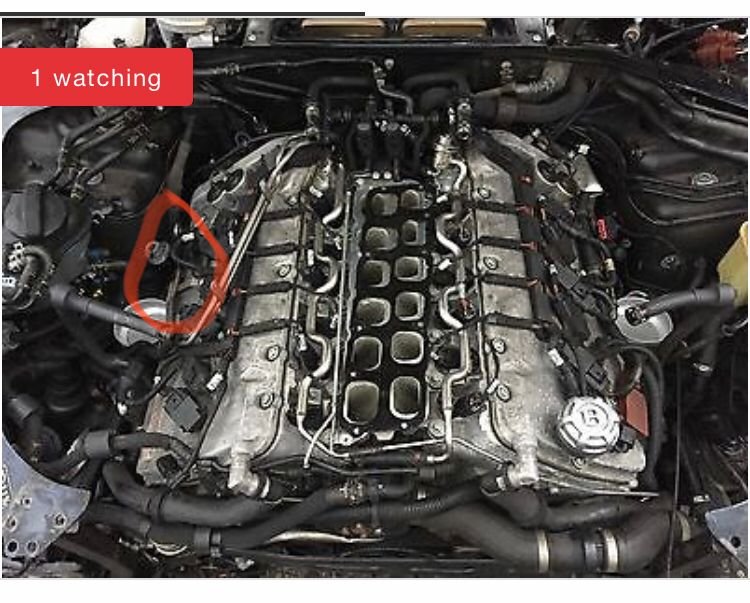

So figured out there was leaky pipe too. Not sure whether gearbox or fuel pipe. Was on the left hand side of the car if you were standing in front of it. Pipe easily fixed but any idea whether transmission or fuel pipe?
had to remove MAF to access it
thanks

sorry markup missed on previous photo!

You should with out any doubt be able to tell if it is gasoline, just smell it.
If those 2 hoses are connected to the 2 metal tubes that run up over the valve cover and to the back of the intake area, then they are 100% fuel lines, you are lucky you did not have a fire, and those clamps are not oem.

Yep those are the ones Johnny. Yep definitely smelt like gasoline but then I was also told that gearbox fluid smells the same.
worst thing is that it has been giving off a smell like this for the time I’ve had it so at least 5 weeks. Really lucky no fire.
well everything seems to be fine now and gear shifts are improving day by day too. So all positive
