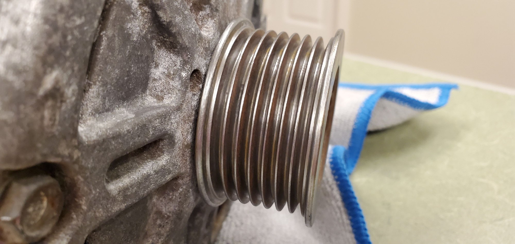

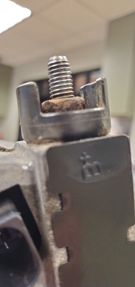

Dear friends,
I came back not happy to tell you the K unit does not fit my GT, everything is fine except the fitting screws which hold alternator in place, J unit has wider body than K unit.
Now need to look for a cheap J unit, any for sale ?

This is the intention of this forum, share knowledge and help each other, many rebuild shop advised me to go for new, this is a not difficult to repair but not effective, needs time and resources, so I am looking for cheap OEM.
And to change the guts scenario, it's a smart move from bentley to not being a smart A$$ on them and go for the K unit, they force u to obey their stinky rules and buy only what they make, change guts isn't possible due to size different in different angels

This is Bentley part number not Audi, They change the last letter by car model, Bentley is 07C903021J and VW is 07C903021K, this will impact the fact that you won't be able to install it on different car

Please do take this the wrong way, BUT, something did go wrong, most likely while your employee either possibly attempting to jump start the vehicle, charging the batteries, or while he or she was changing out both batteries, so, did you mechanic check the battery controller module as pictured for any faults, as I believe this module controls the charging of both batteries, also did you see any signs of arching around either of both battery connection ?
I have some alternators of the number you need, but I think the shipping would blow out the discount I give to my fellow 6SPEED members...
