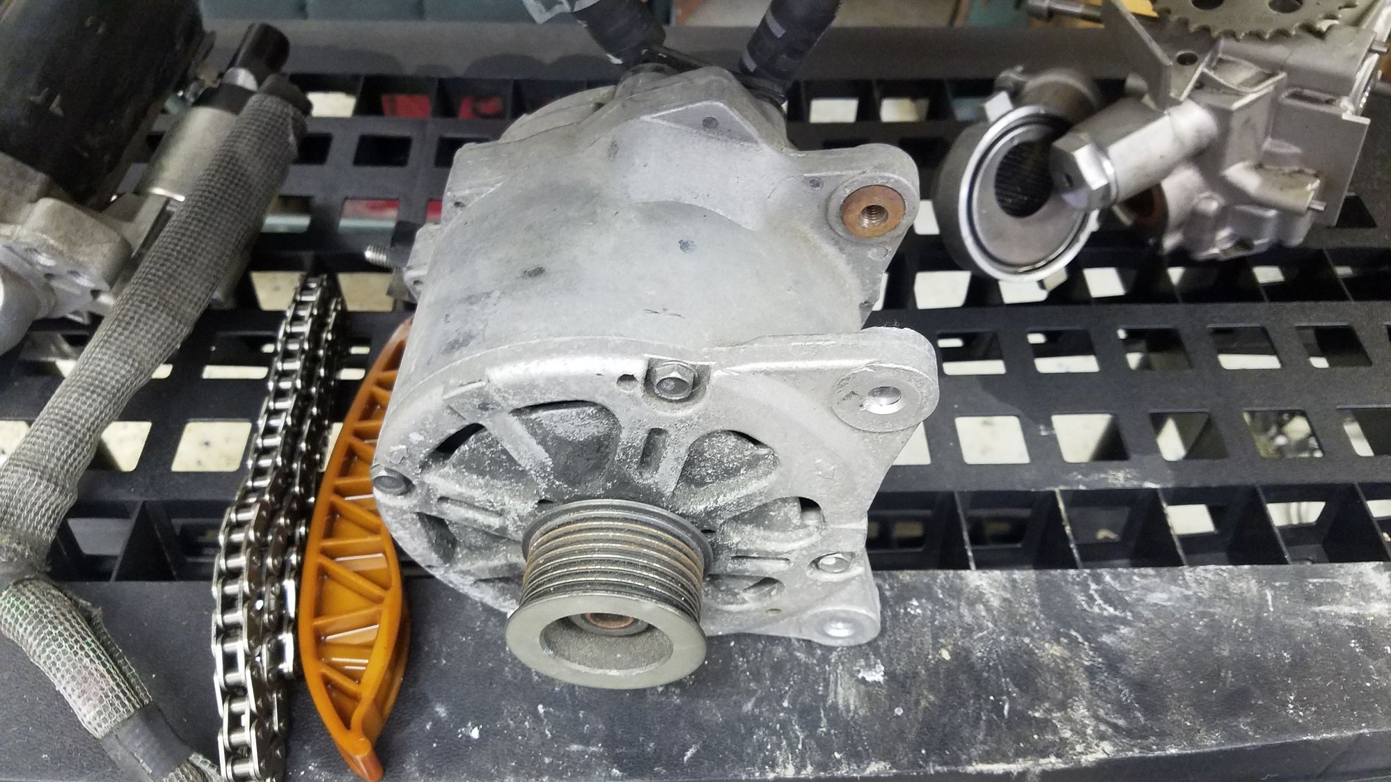

Common ticking time bomb on the W12 ( all variations) .
its a $3 o ring there are two for the water coolant feed pipes .The rubber perishes with time and thing sweeps out of sight .If it’s left fluid eventually finds its way into the alternator and with inevitability kills it .
I would get the proper J part because you need compatibility with the pipe threads and alternator body .
For those wondering how big a job ......the front has to come off and ideally radiator removed , but it can be swung to one side to get to it .
You need a guy familiar with W12 ,s and small hands to get to the rear oklier clips on the pipes .
some pics ......paint a 1000 words . From a VW forum but Bentley is the same principle .....best I could find to illustrate.
Front off , rad disconnected / drained and swung away ....still some bits to remove to access the alternator.
Bentley one bolt holds the O rings in place with a flange ......that’s all ! .....it eventually ends up leaking .
See them both here under the flange
These will leak .Not if ....WHEN ! O rings a peanuts a $3 part
One 16 mm thread the other 17 mm Not sure which is which ....so make sure you buy the right part .
My radiator has been replaced as it’s an 04 car and eventually corrosion gets the better .....how ever while out my tech ( while in there ) elected to remove the alternator.......and guess what ......no prizes .....weepy / leaky rear o ring .....God bless an experienced B W12 guy .
Also replaced the serpentine belt and the idler pully (s) while “ in “
The belt is a 10 yr service life part anyhow .

Why not post some pics of your K unit , so we can see / cast a reasonable opinion if it will fit .
My concern is it’s universal part across a wide range of VAG cars ......but has different cooling pipe connections .
Some are individually threaded in tightened by a bolt , either 17 or 16 mm thread , others have that central plate like the a Bentley variant where the pipes are held one centrally placed stud .An o ring keeps the seal , pressed down by this plate .
Electrical connections looks identical , maybe diff positions buts that’s easy to get around .
Its the water pipe compatibility that’s the biggie .

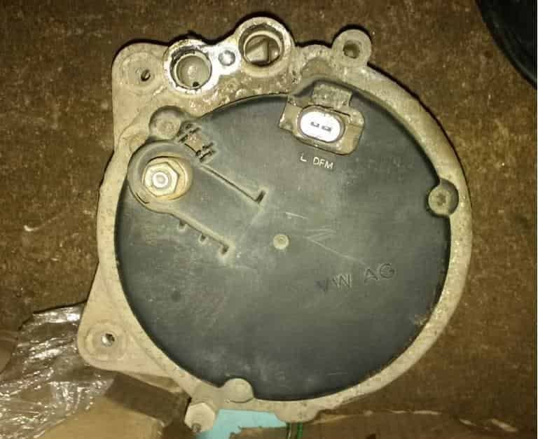

I for one think the B+ connection will be a problem if it is on the rear of the K unit, and not on the side as the original J unit, which most likely will have clearance issues.

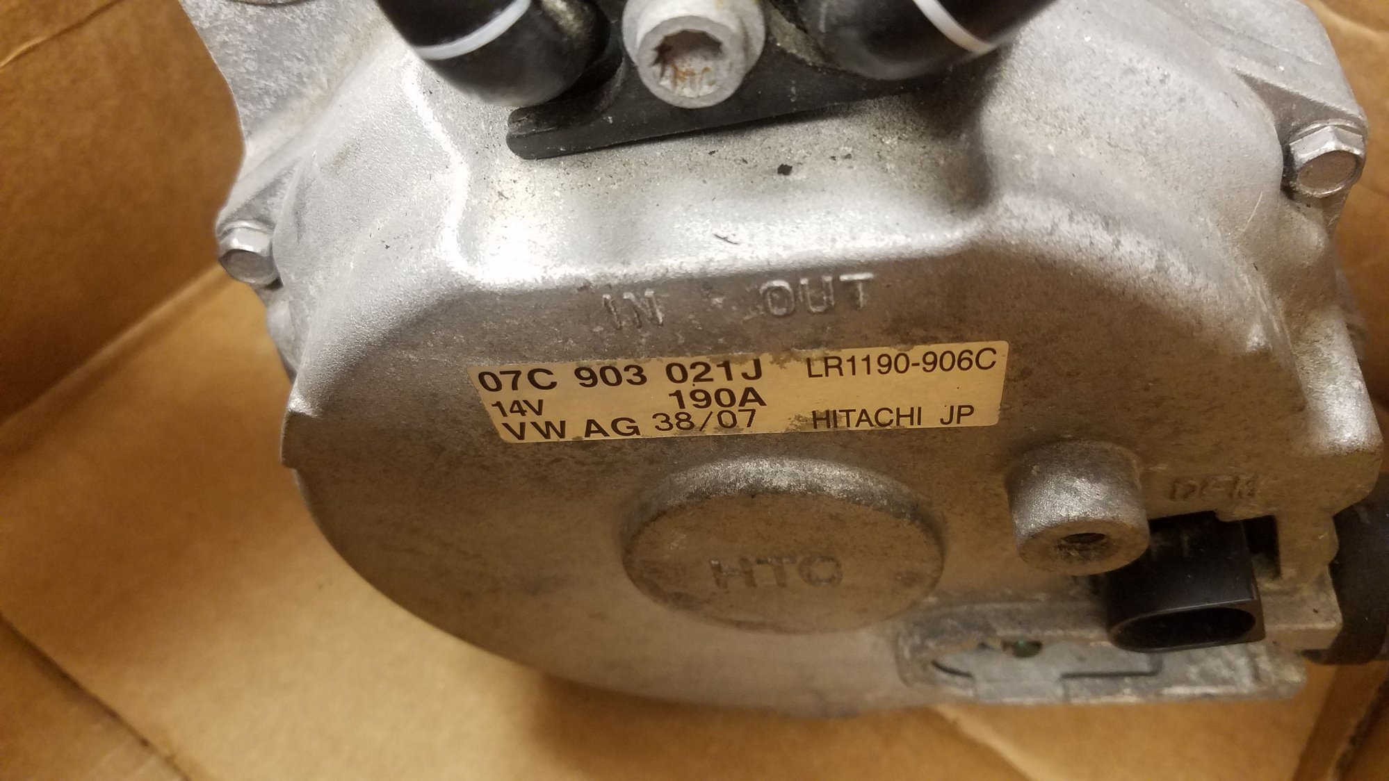

Here are a few pictures of one of the J units I have sold.

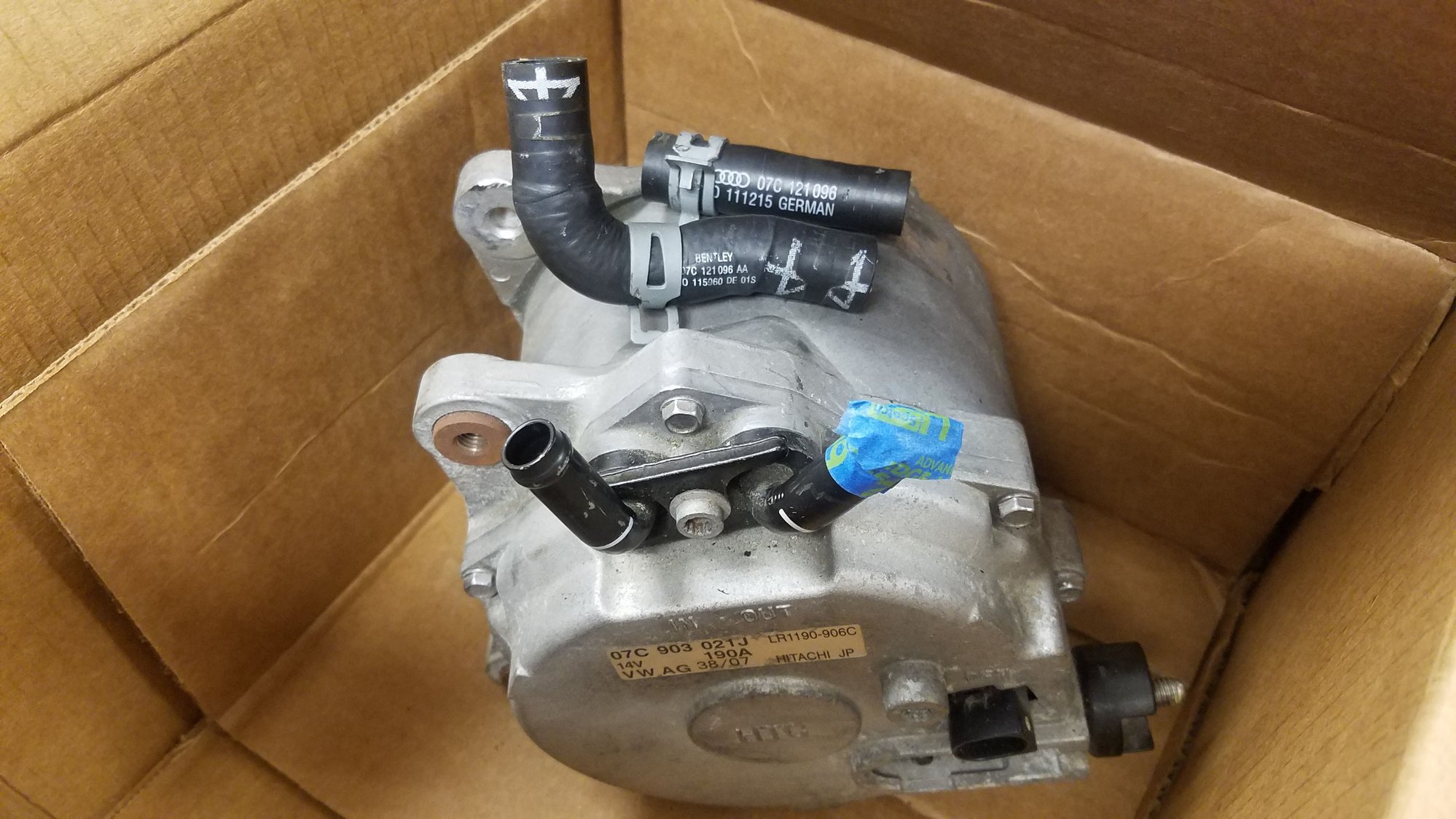

The K unit is exactly as what was posted above, and here is a picture of it

Yes It’s a VAG generic part with various water connections and different electrical connections .
Looks like the water connections ( with a new o rings ) is identical.
Both electric connections are in different positions..... It’s very tight in there extremely tight needing considerable experience just to remove the existing alternator.

Hello Shaqovic,
I am not sure you are following the comments here, being the electrical B+ connection is in the wrong place on the K unit, your mechanic is not just magically going to move it or make it work, if the area is as tight as I believe it is, do NOT allow your mechanic to add a wire, or run your original B+ cable to that area, you most likely later on down the road will end up with the cable rubbing through and causing a fire, you should be getting the correct "J" unit, I mean you have already spent 7 days here guessing if it will work...
Please do not take offence to my comment, but I would hate to see you come back here with a worse off issue after trying to fit the "K" unit.
