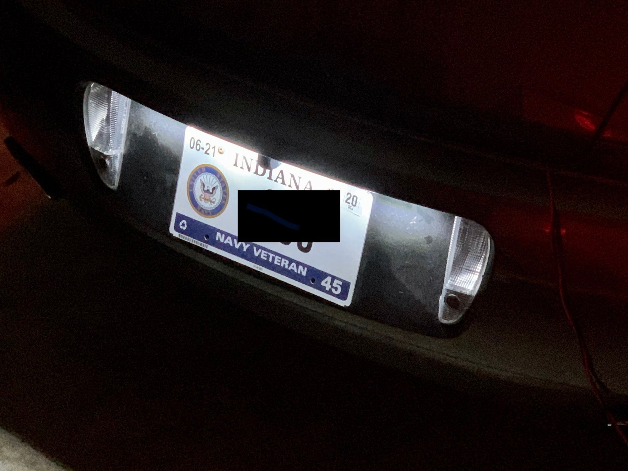

Even the license plate lights are nice and bright. They won’t be able to lie and say my lights are out just to pull me over and go on a fishing expedition now!! 🤣🤣

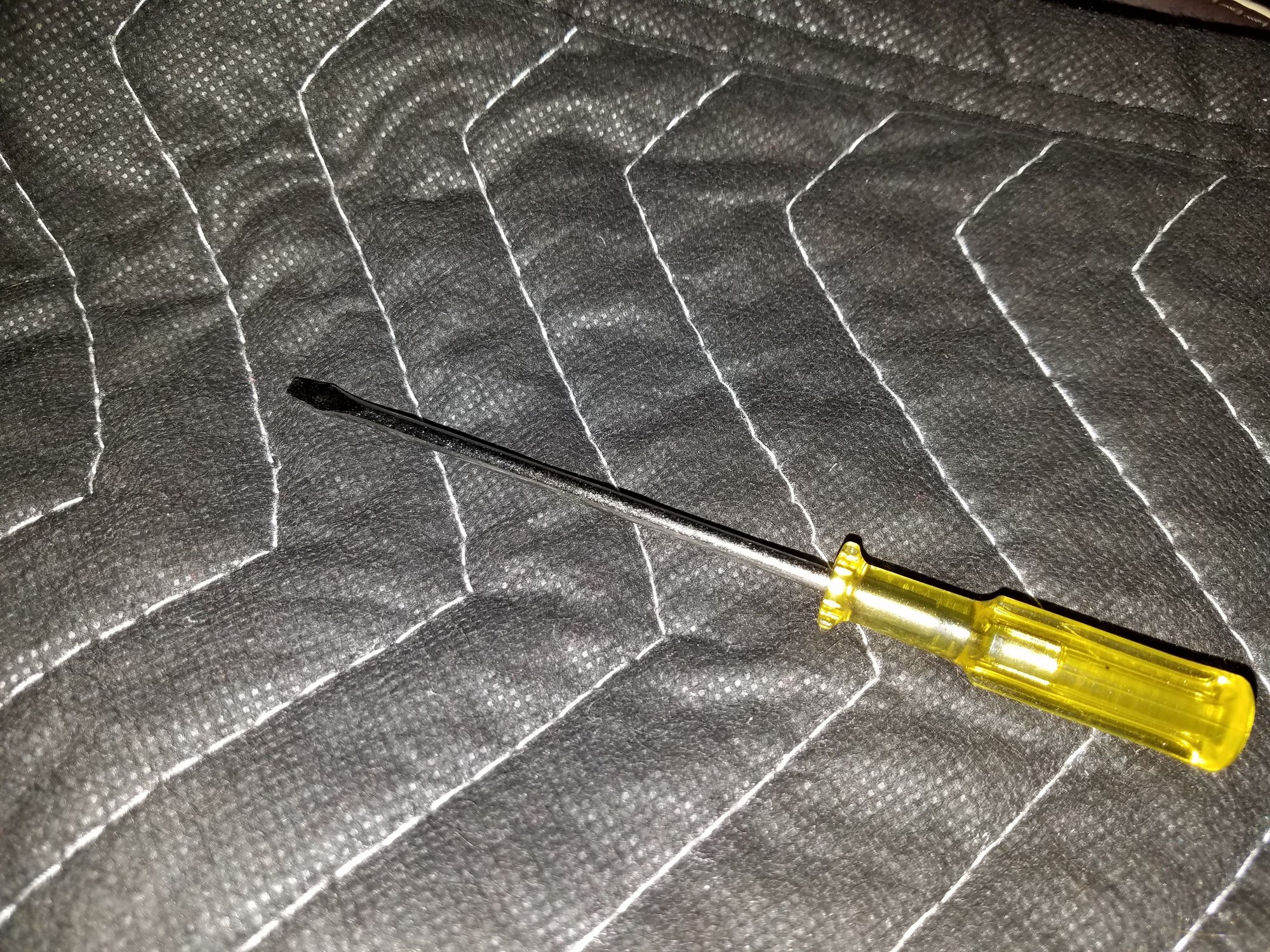

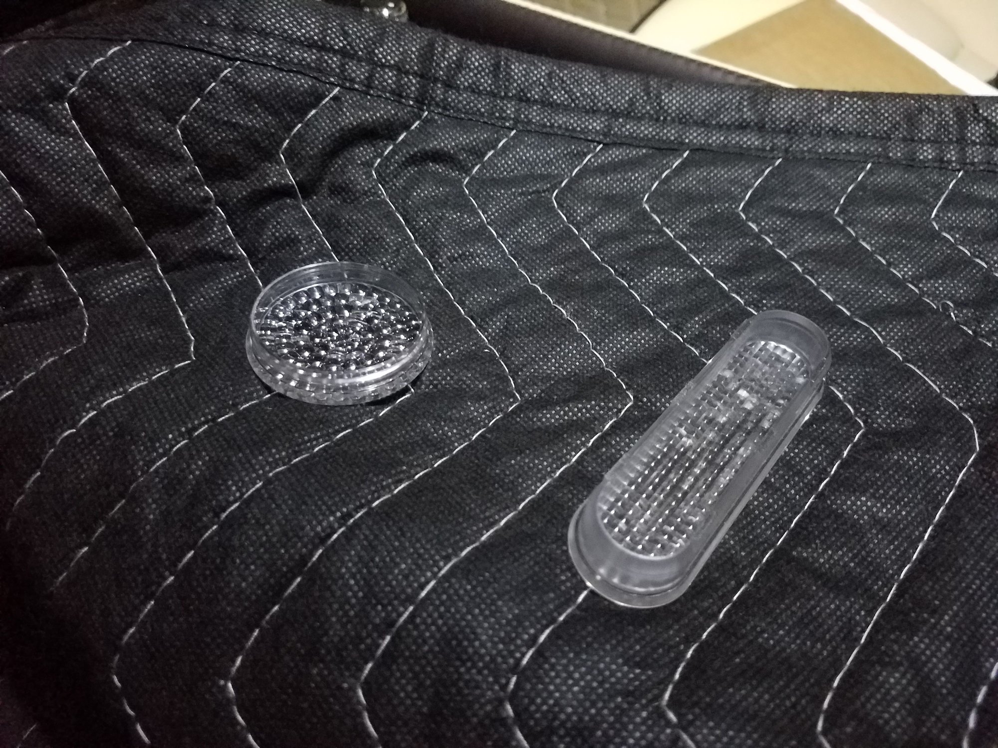

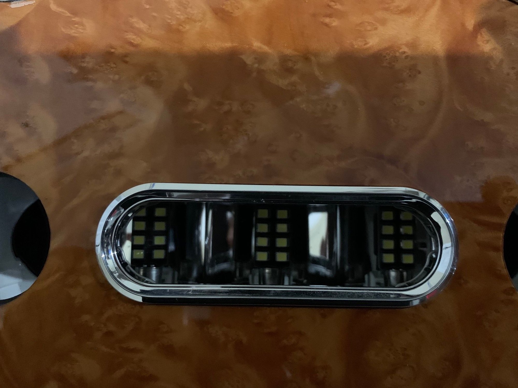

For the overhead console use a small screwdriver
Insert tip between the chrome and plastic lens.
Gently push forward slightly and pry downwards. Chrome ring remains and lens will pop out.

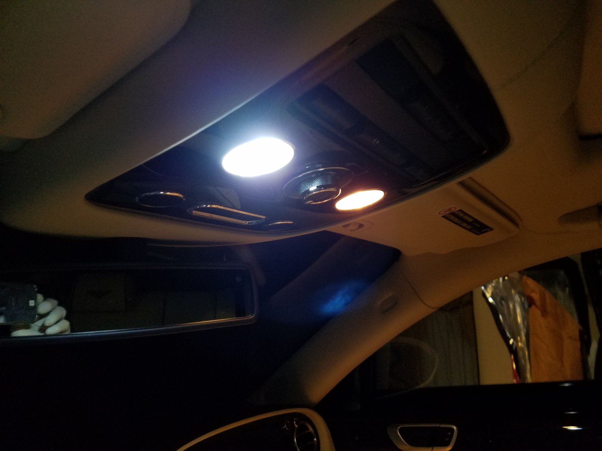

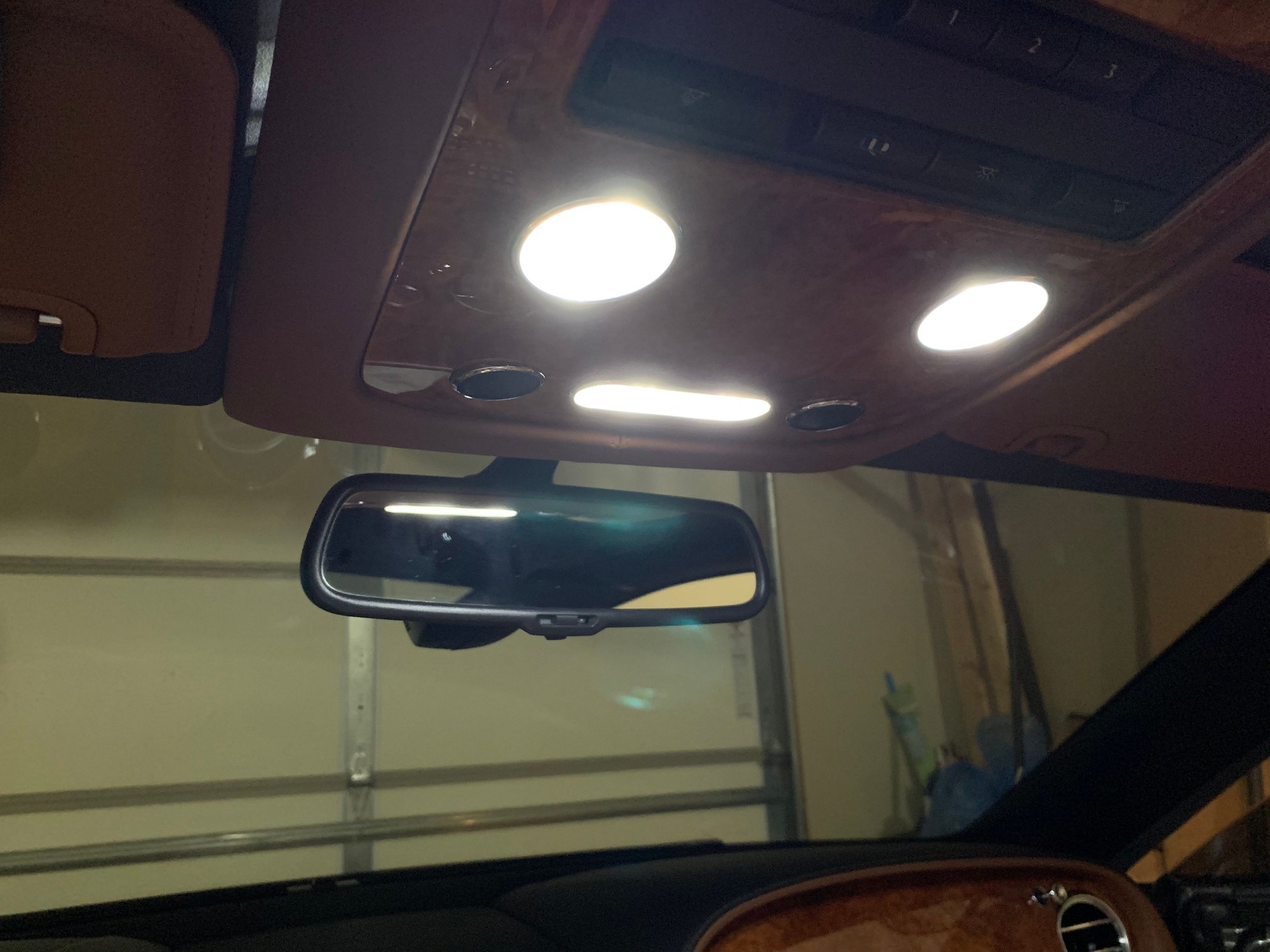

For the two reading lights, pull out the peanut bulb. Here's the LED replacement. Center light uses three 39mm festoon bulbs.
Much brighter and whiter than OEM

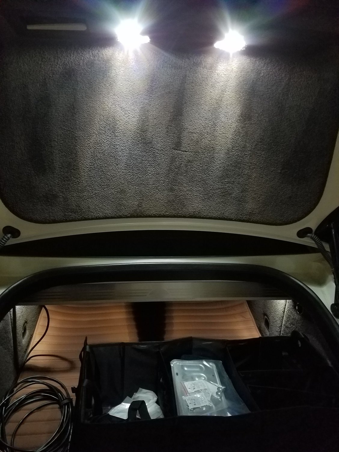

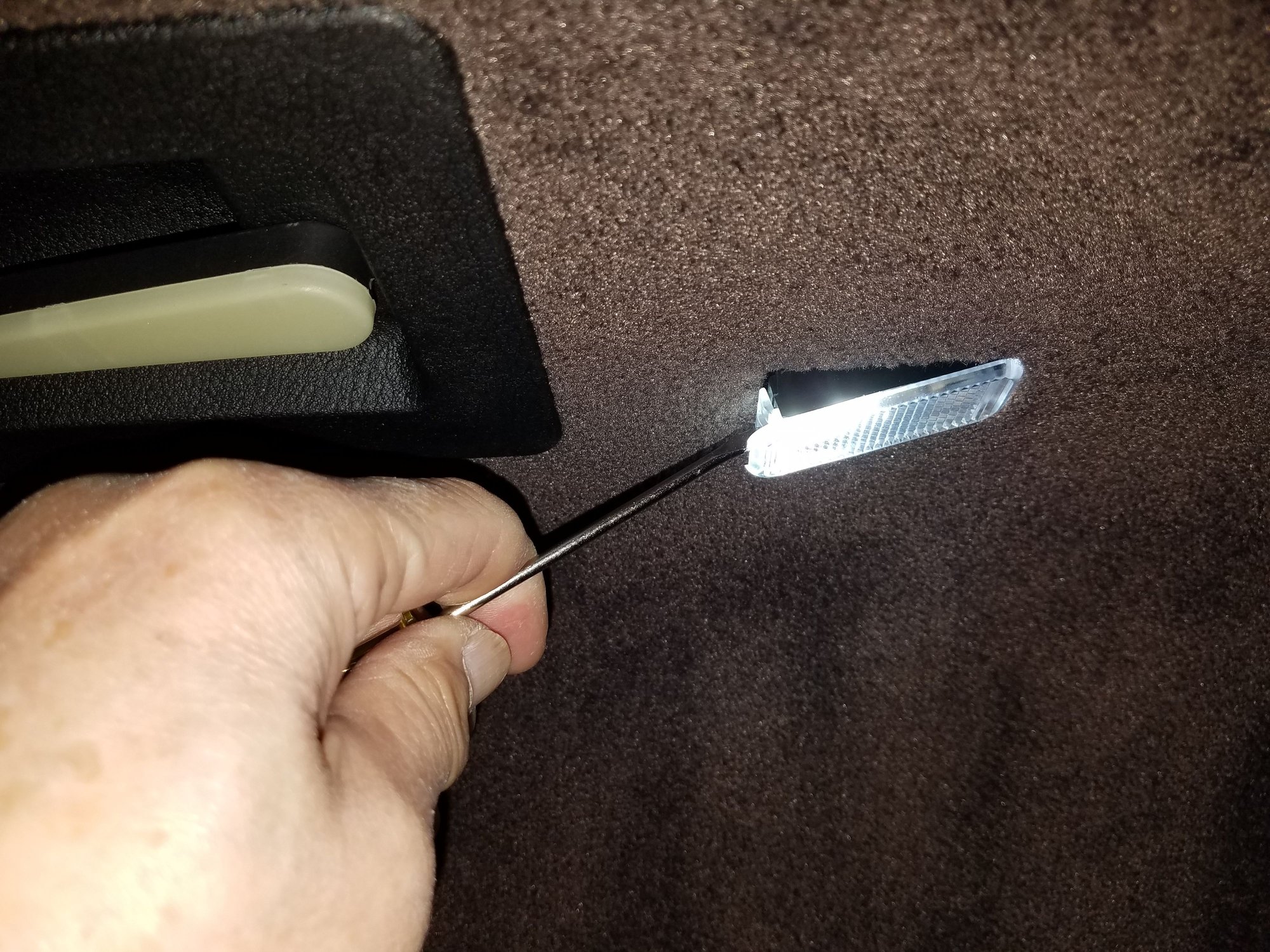

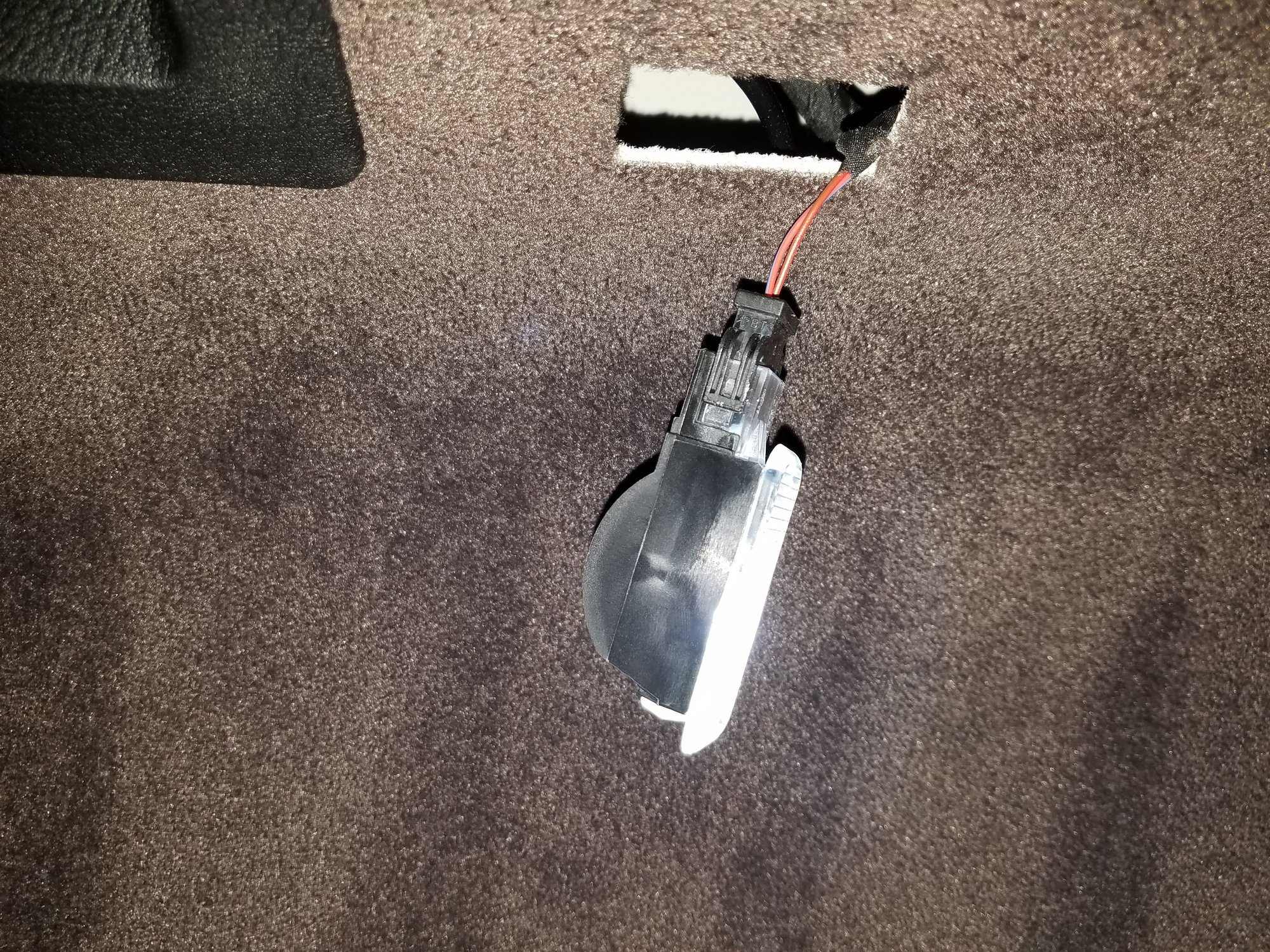

Use same tool for boot lights. Pry open as follows
Once exposed pry off black rear cover and peanut bulb appears.
After comparing brightness, had to finish the inner lights. Despite my compact size at 125 lbs., access was still a chore. Had to enter the boot upside down to patiently complete.
The result was worth the effort!

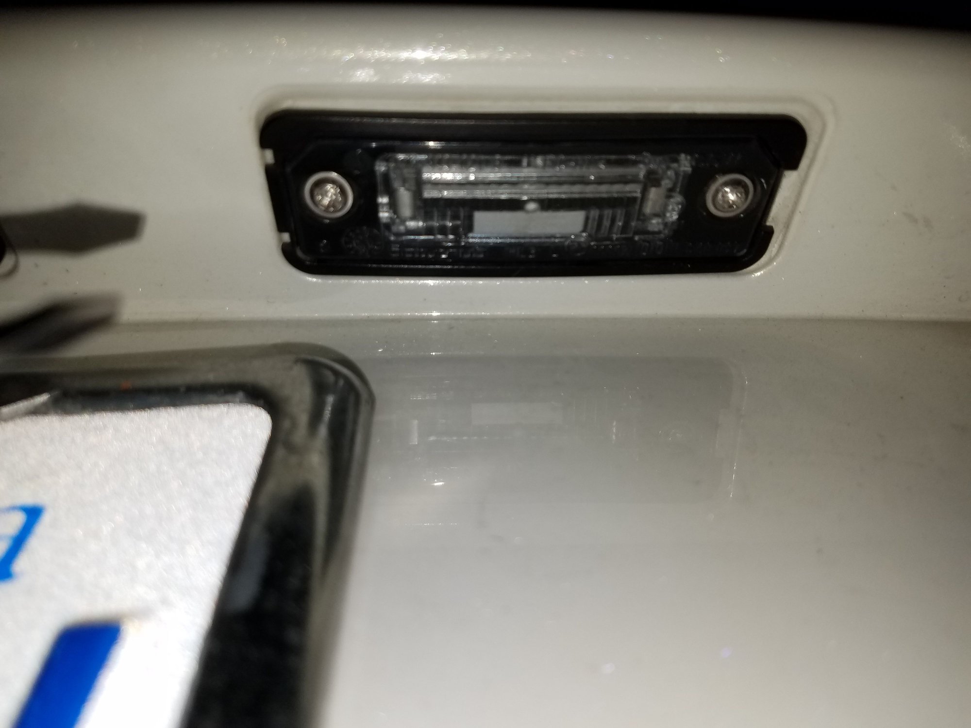

Rear license plate is simple. Remove 2 Philip's screws and with lens removed, it exposes a 39mm festoon bulb. There are 4 bulb housings.
