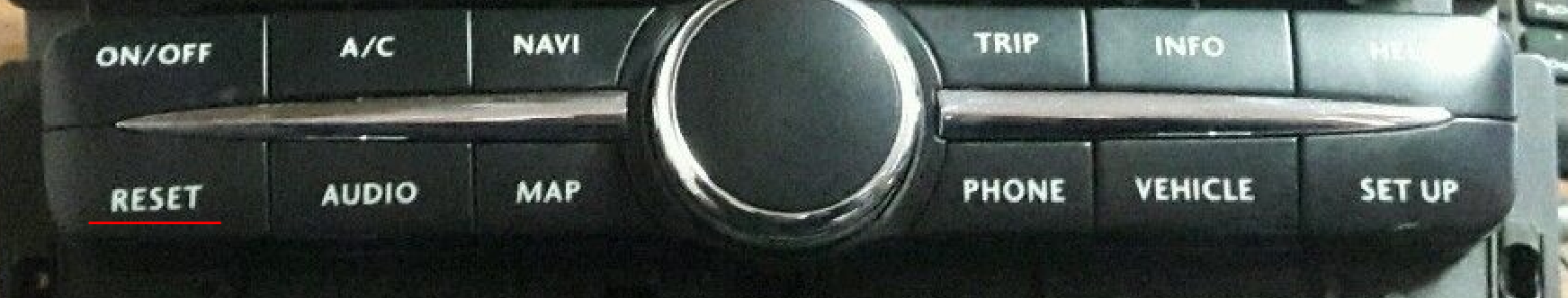

Johnny, how do you reset the head unit?

Press the "RESET" button as pictured, do you not have one ?

No luck. Reset did not work and fuses are all OK. Maybe I broke the unit when I opened it to remove the antenna. I will try and find someone who can look at the electrics. Or get a second hand one.

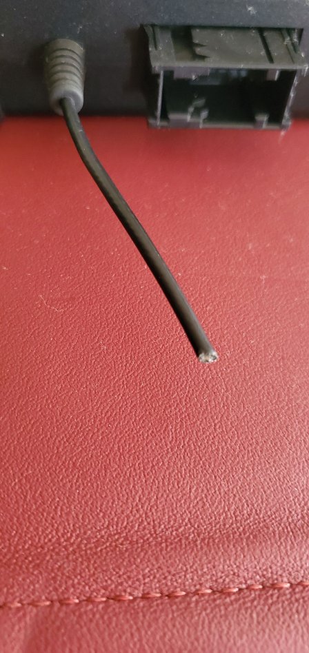

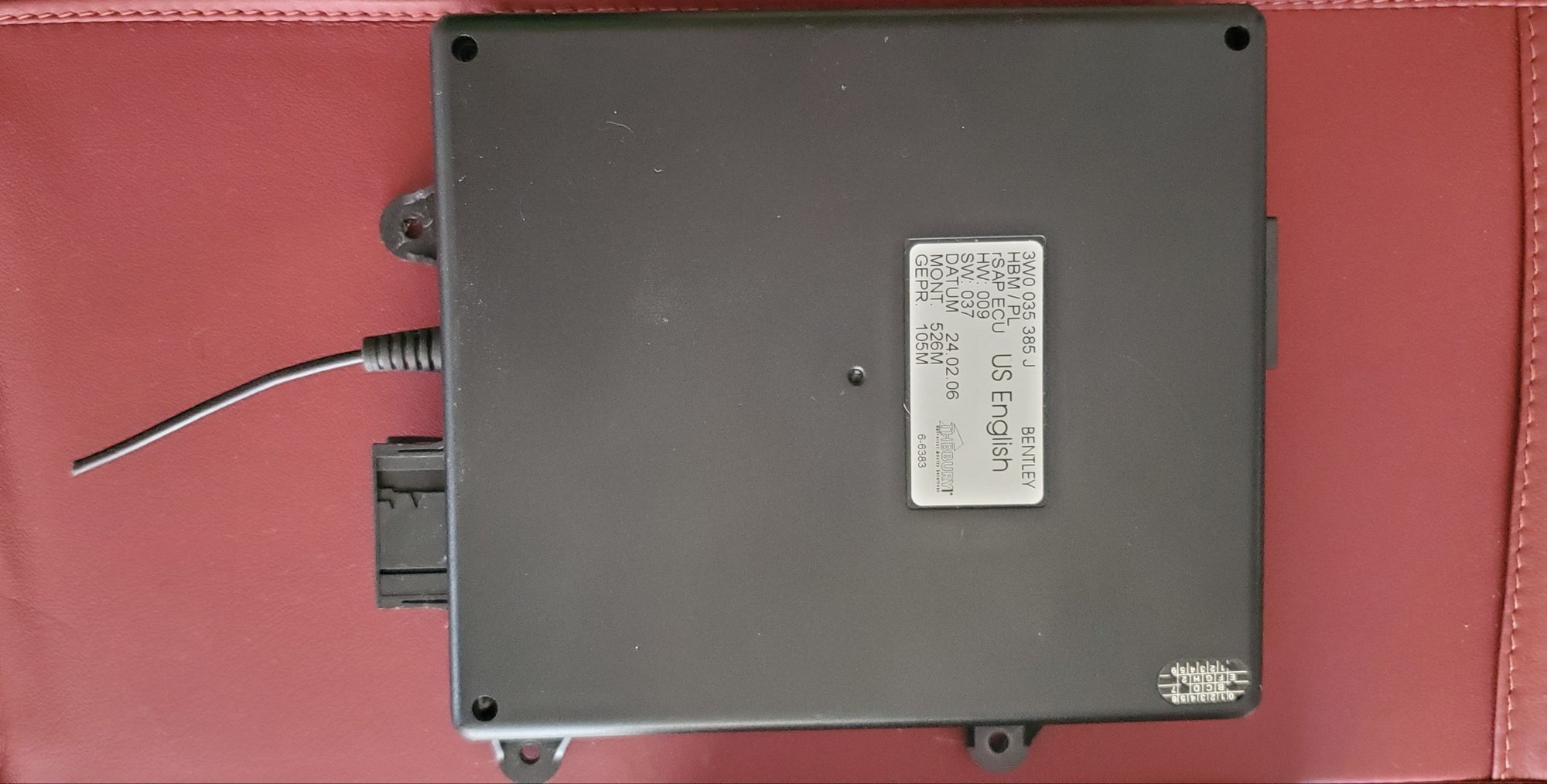

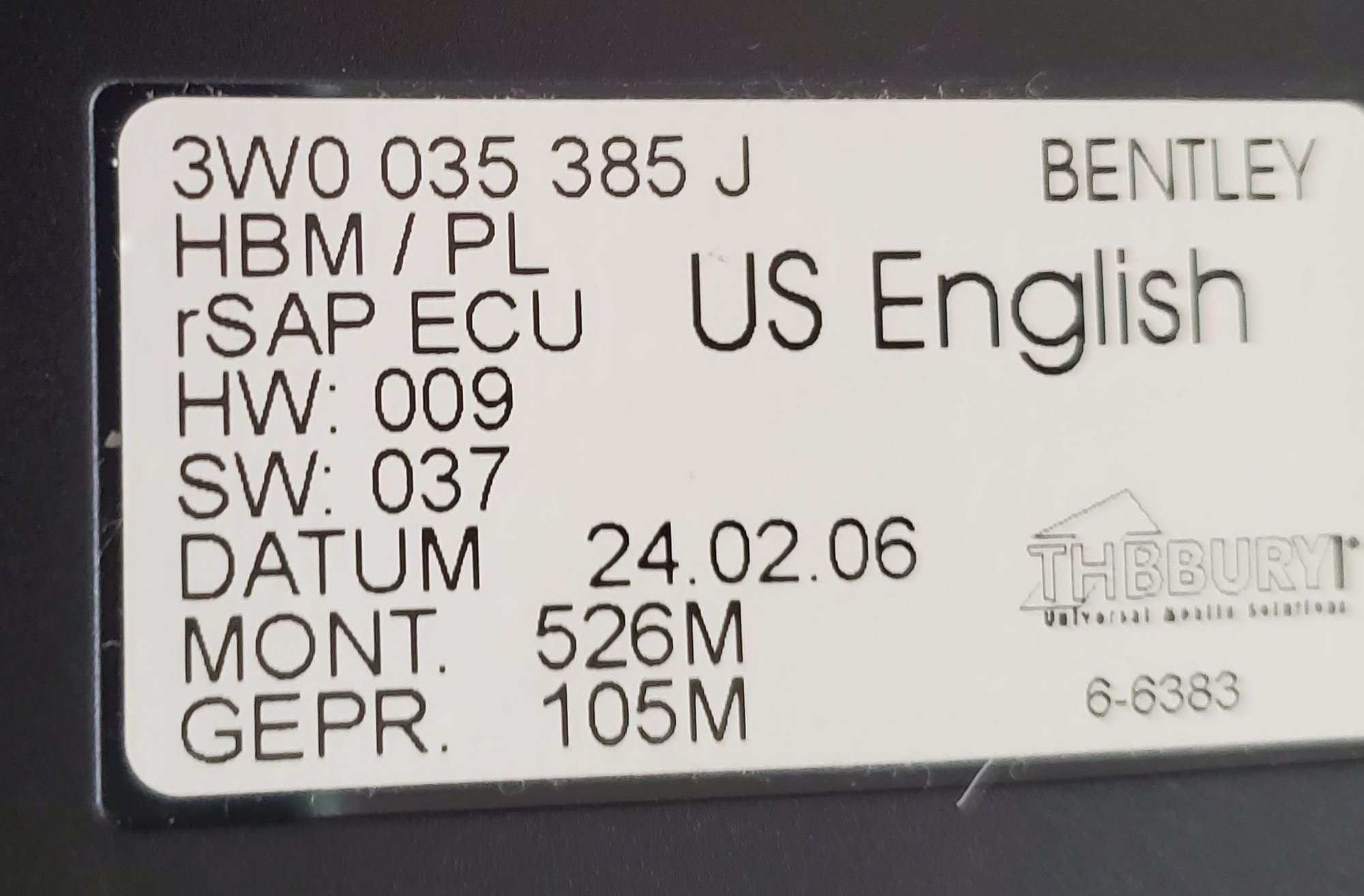

As far as your BT module, if you find that you need a replacement, I have the 3W0 035 385 J at 75us + ship if needed, the "J" is the "US English" version, still with HW:009 & SW:037, although the wire is cut, it can be spliced as I did mine.

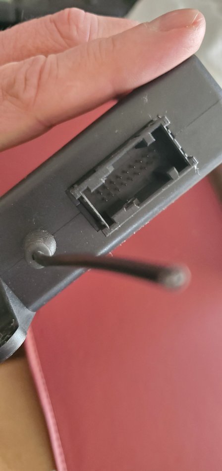

Thanks Johnny. I'll have a think. The cut antenna cable is not an issue as if you open the unit the antenna cable just pulls out from its connection.

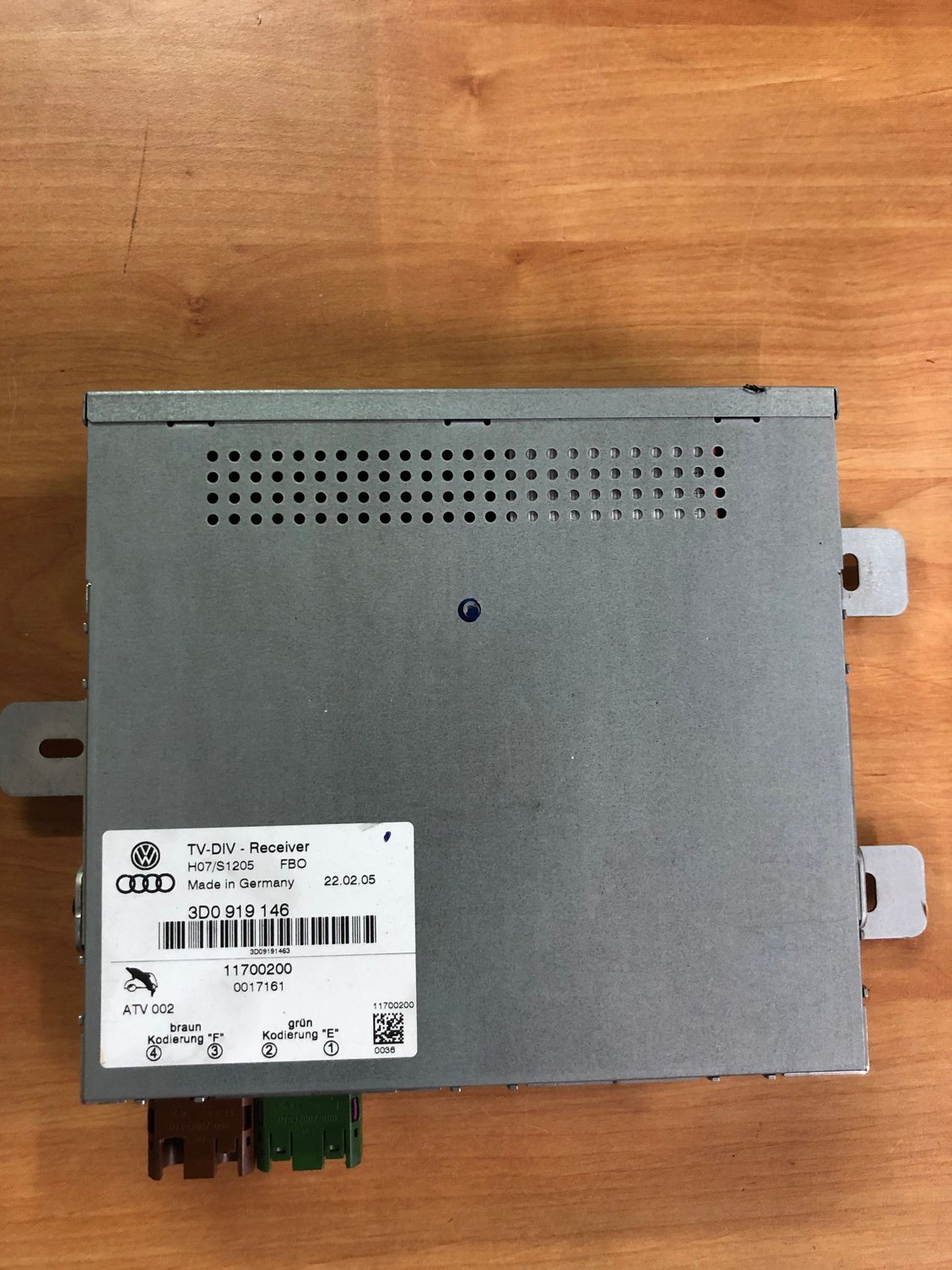

Hello Johnny
I could only today send the photos as requested. Sorry, I was away for the weekend.
I have tried all sorts of settings and coding, nothing seems to work. This is why I concluded that my headunit isn't up to the job of showing digital media.
See if you can see if I am missing something.
Thanks
VCDS
ATV
DTV
Only white noise, scanning produces no results. All 4 Antennas checked OK

Ok, give me a few I will be back with some settings, the TV tuner is being seen by your infotainment head unit, otherwise it wouldn't be showing the TV screen, also it has nothing to do with digital, as the screen itself is feed an analog video signal from the digital TV tuner box.
