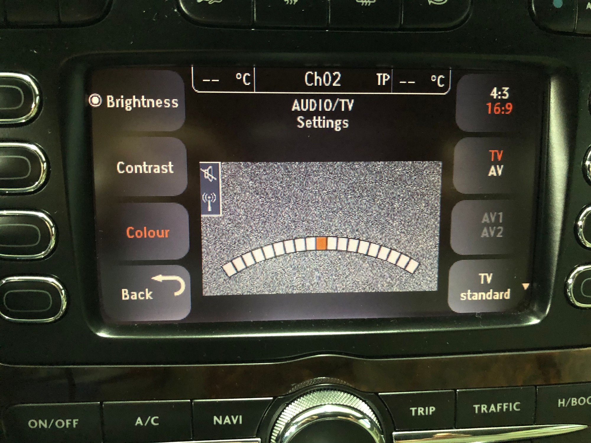

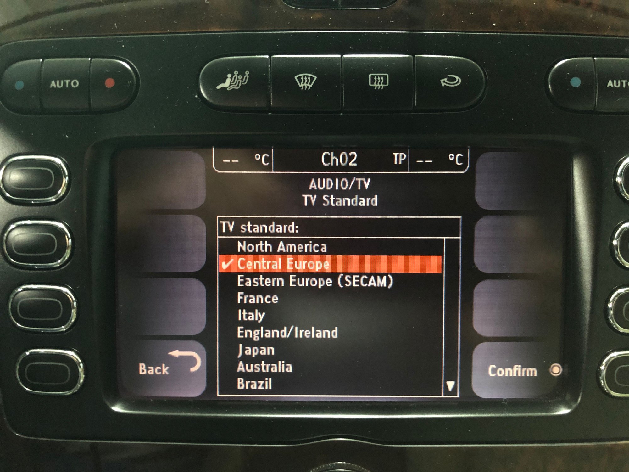

Here are some photos taken of my car headunit screen showing what settings I have my TV module at.
As I mentioned before I have tried all settings and different coding the module but the result is always the same, white picture noise. No picture or sound is coming out.

TV screen
TV Standart chosen

Hello @Littlj01 and @sspeeder ,
James,
Would you kindly post some pictures of your TV tuner settings on the infotainment screen, also do you know the format in which your TV stations are broadcast, and the same for you sspeeder, which format are your stations in Portugal ?
I kind of recall someone here or on AW whom had a similar situation, whereas his area had new digital format/coding be it h264 vs. H265, or mpeg this or mpeg that, I can not recall exactly what it was at the moment, but it was that the same digital TV tuner "148" would work in certain areas of Europe and not others.
That is if I am remembering it correctly.
Johnny

Hi Johnny
Yes, I think you are now steering in the right direction. That could possibly be the case. Why didn't I think of that before?
In Portugal TV is broadcasted with compatibility to the norm DVB-T with video decoder MPEG-4/H.264.
Do you know what is the module "....148" compatible with?
Thanks

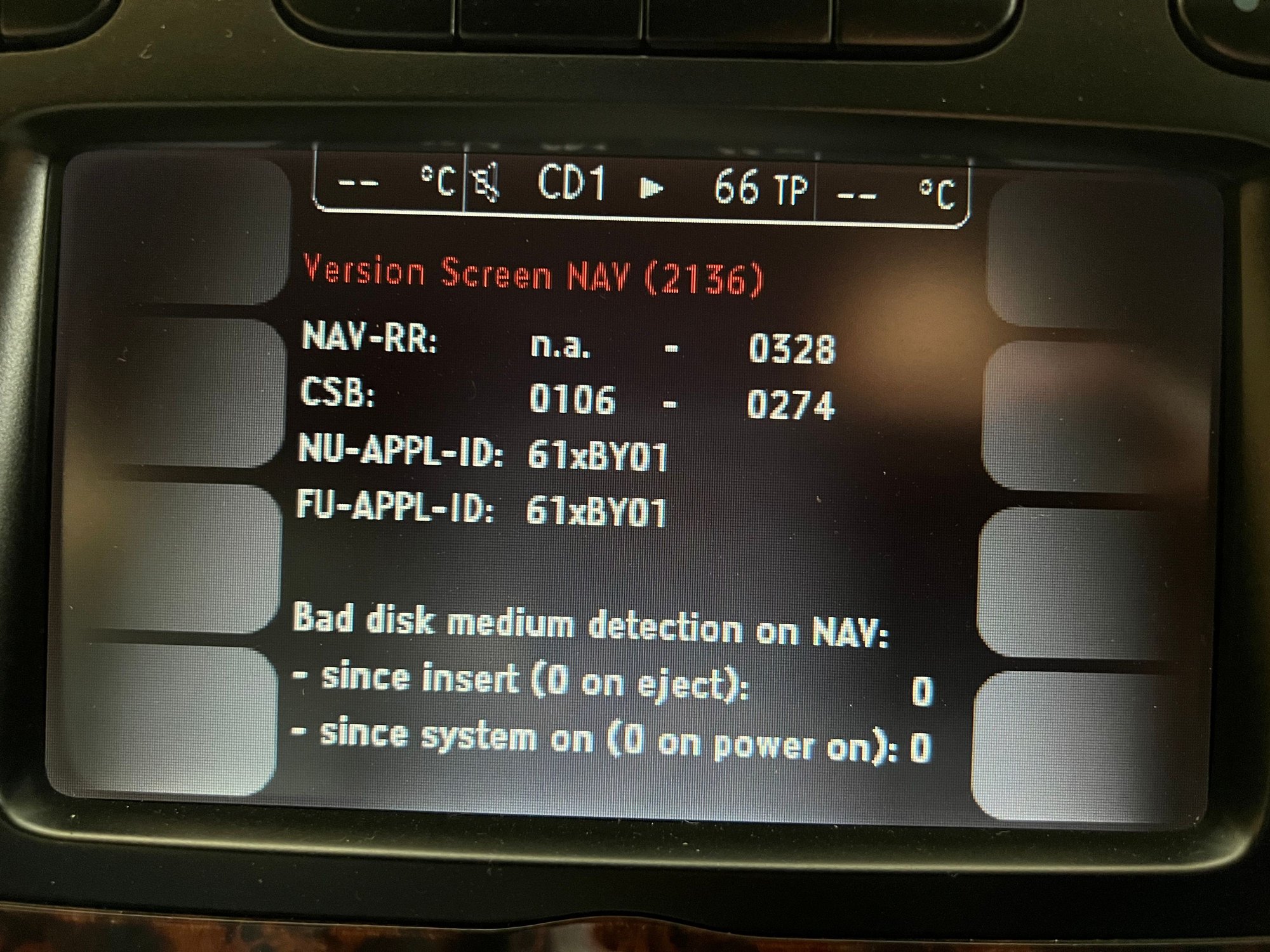

Here are the instructions for retrieving the software level on screen.
I am very curious as to the SW level in your head unit, as for you to have the armrest setup like that, meaning your right side armrest with the dial and screen, your head unit should have the proper SW. did that rotary **** and screen work prior to you swapping the BT box?
Just so I repeat it again and it is fully understood, when using the "AT" BT module the privacy phone and the rotary **** / screen along with the SIM card slot become obsolete, and nothing is needed in either armrest for the BT to function as hand free, as shown in my videos on my rebuild thread, now of course one could fit the newer armrest inserts into both for the newer privacy phone in one, ant the SIM card slot in the other, but first you got to have the proper head unit, and remember if you go to far up year wise you will run into CD VS. DVD NAV drive unit, that's why I went all 2010 for the infotainment head unit, DVD NAV drive, and BT module .

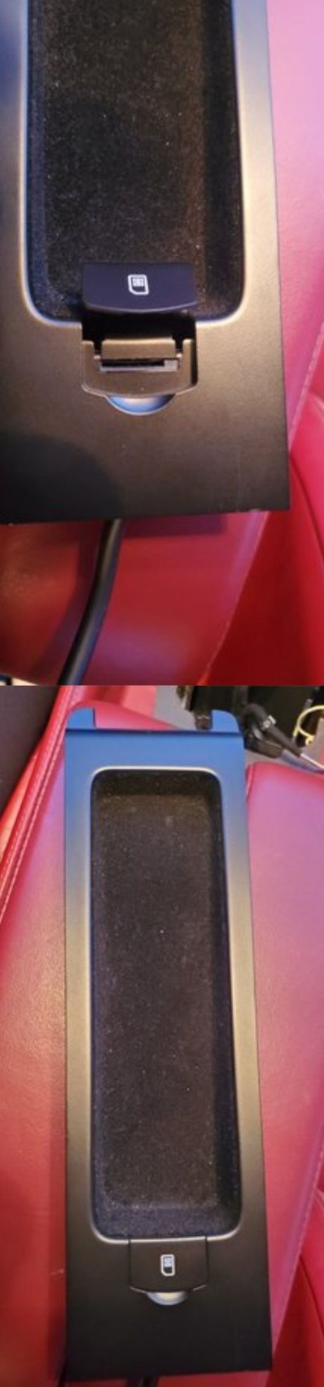

@Johnny Hotspur GT Can i ask You a photo of armrest inserts for 2270 or maybe you know part-number? Im trying to install AT module to my headunit 2270 vervion, and then ill *** dvd nav, when find part numbers of actuall working version.

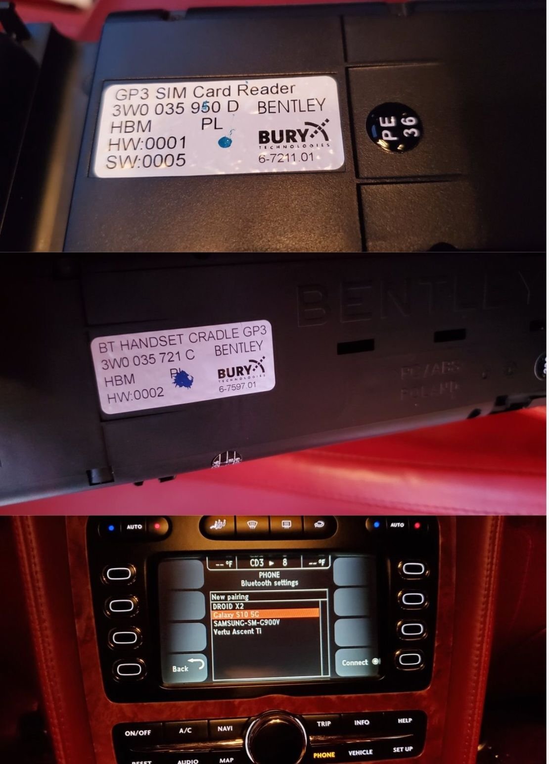

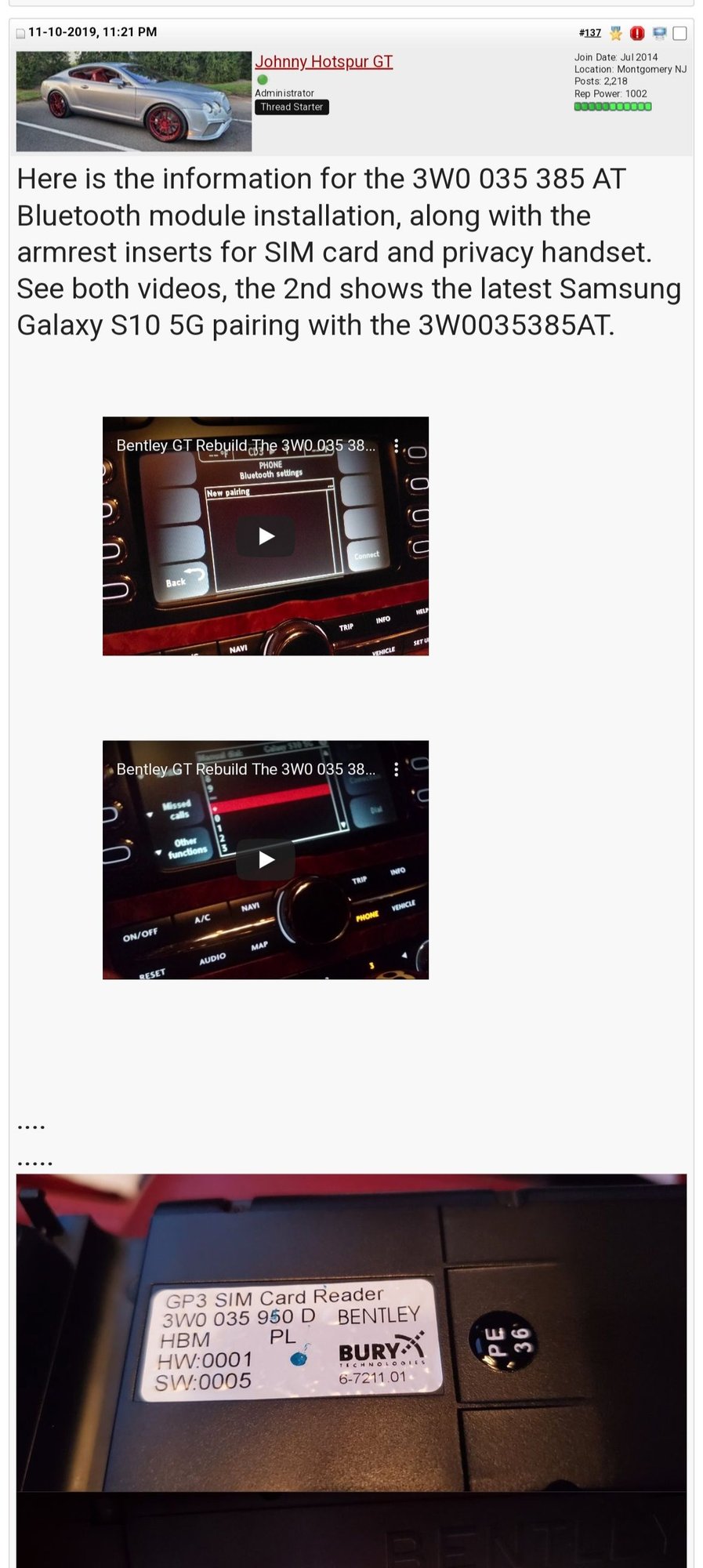

​​​​​​Hello @molphar ,
Here are my pictures with the part number.
Be aware that that you do not need to have anything in either armrest for the "AT" BT module to work as hands-free, I added the newer privacy hand set and it's cradle, along with the newer armrest insert with the SIM card slot, all works as it should, and I really only installed them because I could, but in reality, neither have been used.
I also attached two of my videos, showing the BT working, with and without the armrest inserts.
https://www.6speedonline.com/forums/...-pictures.html
​​​​​​Hello @Dean1234
Welcome to 6speedonline !
See above for the required information, the BT module is part number
3W0035385AT.
Johnny

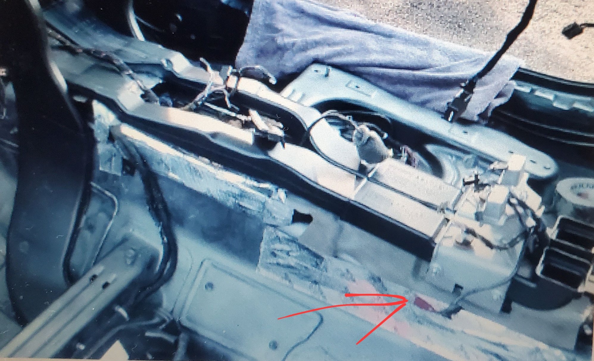

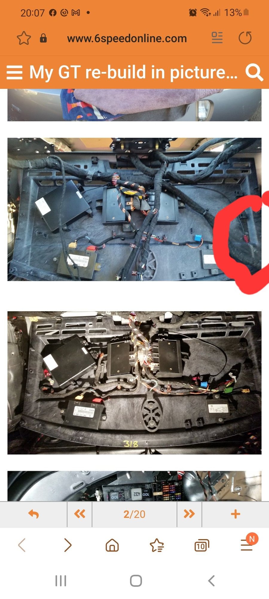

Hi I'm trying to find we're this wire plugs into
Hi could somebody please help im trying to find out we're the wir ive circled plugs into

In tv-tuner ? but it is not installed in this car as i can see
Hello @Dean1234 ,
Very sorry for my delayed response.

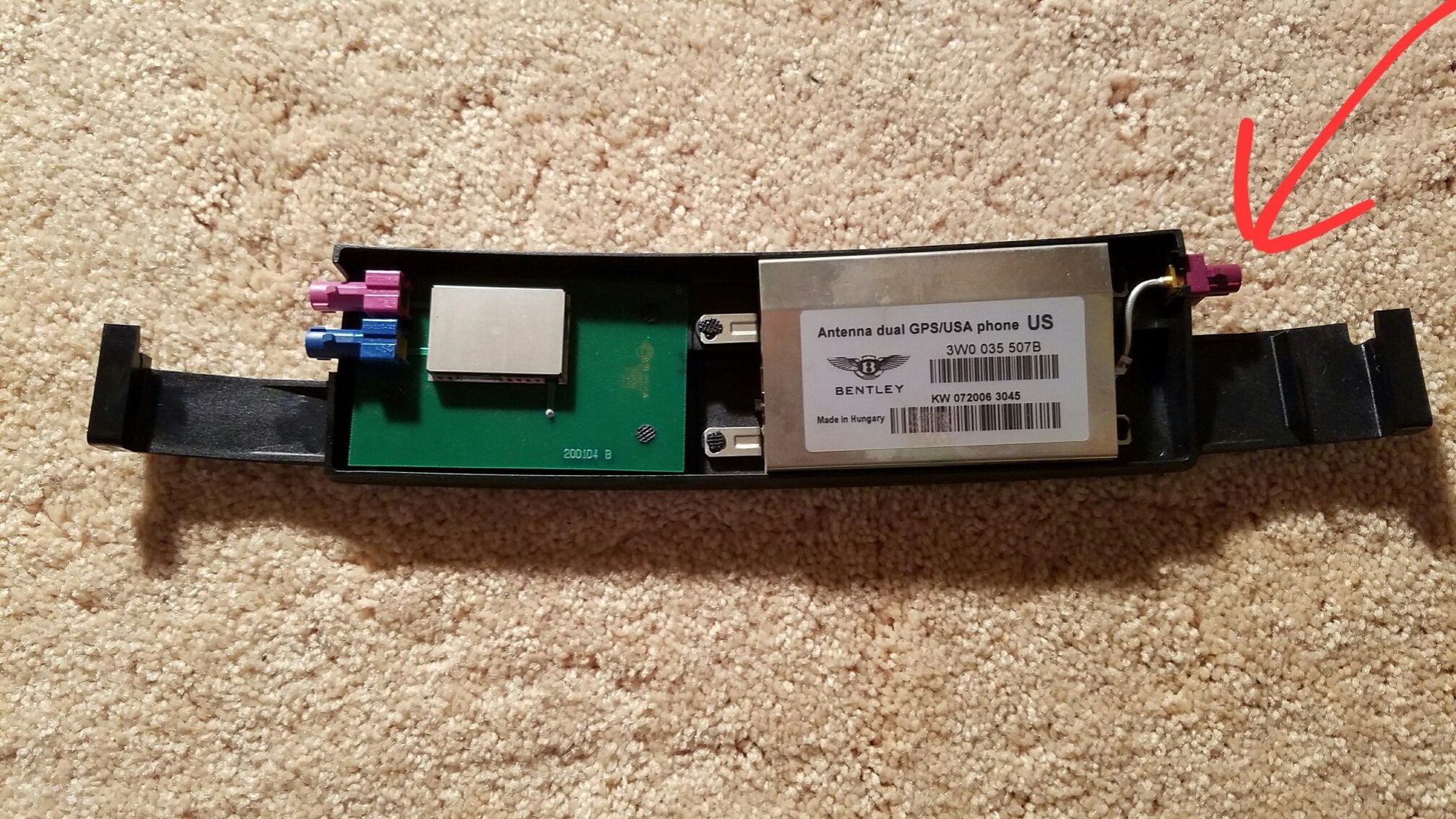

That is my vehicle you have pictured, that purple plug goes to the rear window antenna, but, I believe that it also matters which year vehicle you have, and the standard vs rSAP phone systems, and where you are in the world, as in a TV tuner installed or not as @molphar stated, during my rebuild I found that same purple plug in the left hand armrest hooked up to the old Nokia phone cradle, so, in the 05 I had the Nokia phone cradle and the standard (no antenna hookup) smaller phone control module in the trunk, this wire ran from the cradle to the read window antenna with a plug connector somewhere around the interior right side panel, or under the interior rear deck panel, I can not recall at this moment where that connection point is, this wiring was to the vehicle antenna for the Nokia mobile phone while in the cradle, and also because of the infrared glass, in my 06 parts vehicle I had the dial and screen in the left hand armrest (no antenna wire used, eventhough it was in the harness) and the larger BT module in the trunk with a antenna connection, I had to make the connection, I recall removing the side and or deck trim panels to find that plug, as I must have missed it while installing the complete vehicle harness, it was the only piece I forgot to get to the trunk...
So, tell us where you are, and which year vehicle, and what system you have right now, and if you switched out the BT module, what is the issue ?
In my video I show the AT BT module working with both armrests completely unplugged, not in the video though, I am almost certain that I tested the cellphone without that wire/plug connected, and the cell made calls, but the sim in the 2010 armrest needed that plugged in, I am not 100% on that, it's been a few years.
Johnny

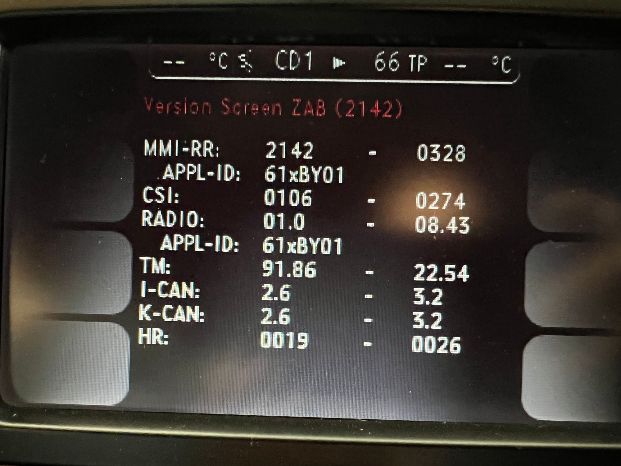

can the Bluetooth rSap unit be upgraded with VCDS?
my head unit software is 2142 car is 2006
