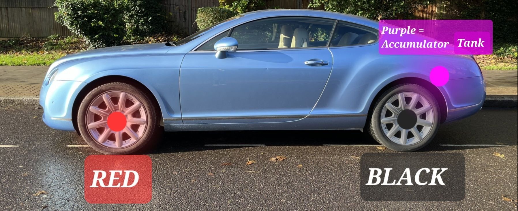

@Ksharp ,
Yes, there is an actual compressor, along with the valve block, the accumulator tank, 4 struts with air bladders, 4 level control sensors at each corner, 6 air lines, one from the compressor to the valve block (very short, black), one from the valve block to the accumulator tank in the drivers rear quarter panel (purple), and the remaining 4 that go to each strut, then the is the suspension control module itself located behind the drivers rear seat side panel.
The fact that the corner is lifting, but then falling, that to me means that the level sensor on that corner is working properly, as it is calling for it to raise said corner, so, you likely have a leak in either that strut bladder, or it's line from strut to valve block, or the valve block itself.
Johnny
