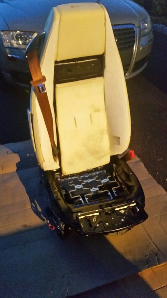

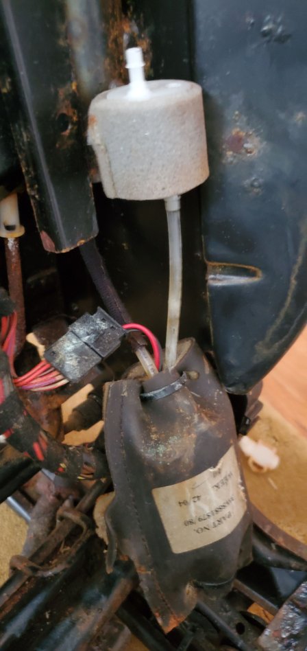

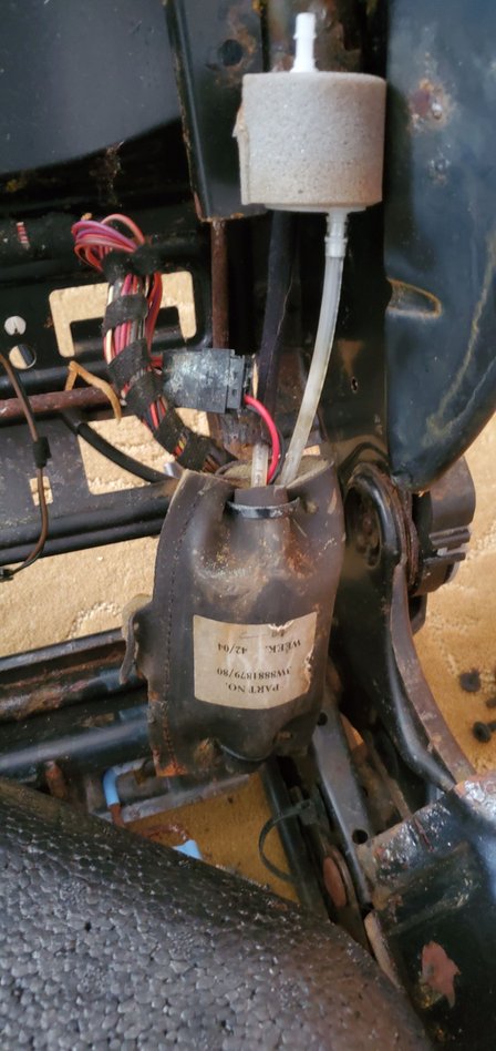

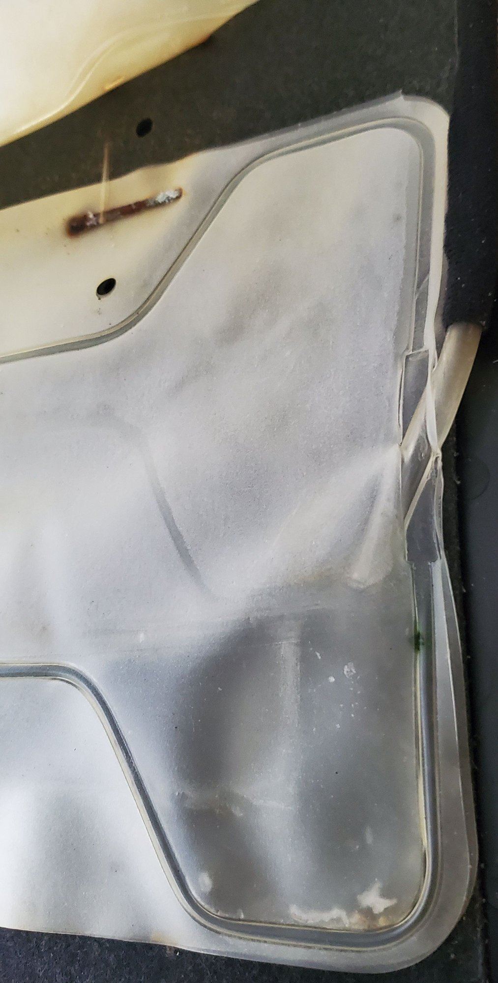

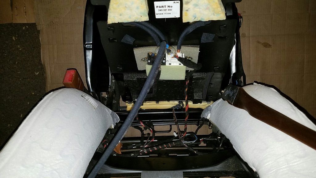

​​​​​​Hello @txtonyo ,
Here are some pictures from my GT rebuild thread, you can see that the seat massage works by way of an air compressor, and 3 inflatable plastic air bladders positioned at the lower back.
https://www.6speedonline.com/forums/...-pictures.html
Johnny
