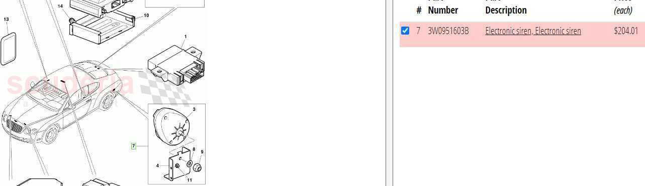

As the siren is not easily accessible be it in either of the 3 locations it can be installed in RHD VS. LHD, meaning, one would have to remove the rear tire and liner to gain access, and the other 2 available locations are under the hood/bonnet, which requires getting the hood/bonnet open, then removing the wiper arms to remove the scuttle cover to gain access to the siren, if someone has not heard it in the time it would take to reach said siren, it's to late already....
So, here is a diagram of the 2005 LHD vs RHD locations for the siren.
Johnny
