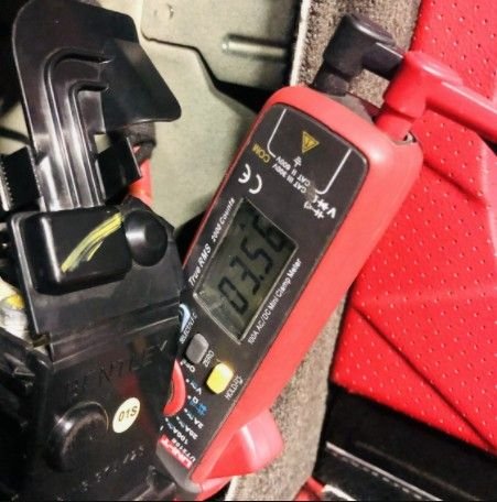

What should be the typical battery drain on the AGM battery for Flying Spur 2014? I'm seeing continuous draw of approx. 3.56A when the car is off. I sense something is not right as my brand new batteries keep dying over a period of 2 days. It did get approx. 30-40 days of daily driving time on new batteries prior to that. I park it inside a temperature controlled room so the cold weather outside does not really play into the mix. Any help would be greatly appreciated. Thanks!

Hi Guys, sorry for the delay in my response. After banging my head against the wall for the last couple of weeks, I think I have finally isolated my problem down to the Rear Seat Entertainment (RSE) system. In my car, RSE consists of the following 4x fuses: #18: RSE 10A, #22: RSE BCU 5A, #23: LH DVD 5A, #24: RH DVD 5A. I could not get around to acquiring a proper data-logger but did have a voltmeter, a flashlight and a GoPro on hand to be able to monitor and document my issue. Attached you will find snapshots taken at 3 different time intervals of before and after removing the RSE related fuses in the front fuse box located near the steering wheel. Below are some of the things I learned as I tried to (crudely) monitor the power draw on the AGM battery:
  1. Unlocking the car causes a the internal systems to draw over 20A of current. (sorry I don't have an accurate figure as I had my voltmeter set 20A and unlock made it go in overload)
  2. Locking the car seems to be a 2-4 minute process as the internal systems complete various checks and balances.
    1. The draw starts at approx. 13-15A on clicking the button
    2. Then it drops to 5-6A within the first minute
    3. Then to 2-3A around the 2 minute mark
    4. Based on the state of the car before it was locked (i.e. was it driven or not, how long was it driven, how long has it been running, were only the systems turned-on, etc.), it goes down to 100-200 milliamp levels at or around 3mins
    5. Then finally, close to NO or intermittent 10mA draw at or around 6-10 minute mark
    6. Outside of that window, I am sure the car has built in RTOS that makes it wake up every now and then to perform other checks and balances
  3. I'm sure I could've left fuses #23 & 24 (for LH and RH DVD) intact but I didn't want to leave any room for error. Maybe I will install them back in the future if and when I need it.
I hope this information will help someone! I want to thank everyone for providing their feedback as it did help me brainstorm a few ideas on how to go about my troubleshooting.

Interesting! I was going to make a current datalogger, but you've beaten me to it with your ingenious arrangement! Certainly bettter than locking yourself in the boot.
I wonder if the car wakes up from time to time? Anecdotal evidence says the housekeeping battery runs low after a few weeks, but at 10mA it should run for nearly a year. So there must be things the car does every so often.
Is there a tracker in your car?
What did you do with the RSE?
