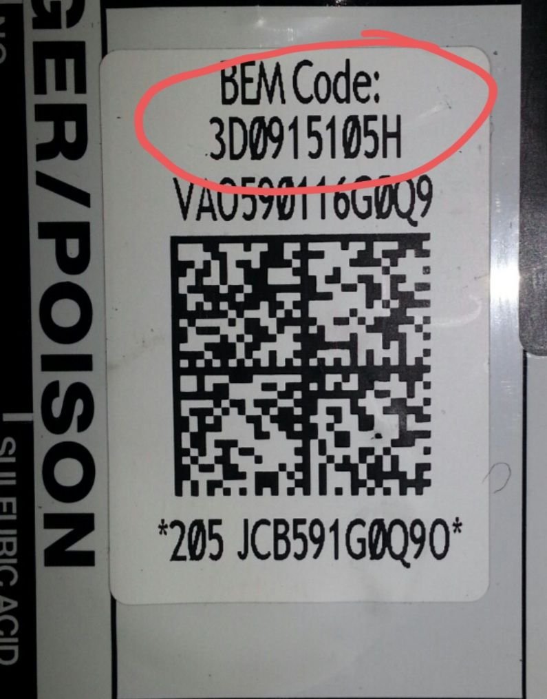

The Bentley is not like the A8L where one has to code the new batteries to the vehicle, as the Bentley original Varta batteries do not have a "BEM" code as an A8L battery does.
Bentley Battery no BEM CODE.
Audi A8L new and old batteries with "BEM" code circled.
Sample BEM CODE from Audi battery, that Bentley does NOT use.
