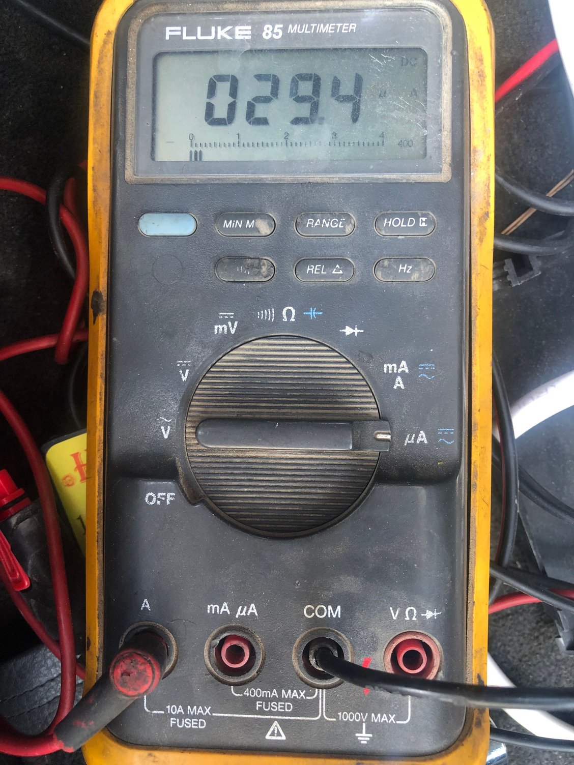

i used a multimeter and here is the results
I unplugged every fuse I could find under the hood/driver side and in rear trunk, yet the numbers will not go down
same procedure applied on the right side battery
do not know what else should I do now !!

Isn't that reading 29.4 *micro* Amps? Or is there something I don't get about how to read your meter?
That's *nothing*. My back of a beer mat calculation indicates that you'd drain your battery in about 32 years.....

I agree that the screen is indicating a measurement in micro Amps, but as the red lead is not actually plugged into the micro Amps socket on the meter, and is instead plugged into the Amps socket, then it's very difficult to guess exactly what scale the meter is reading.
Ahhh yes! My thanks
