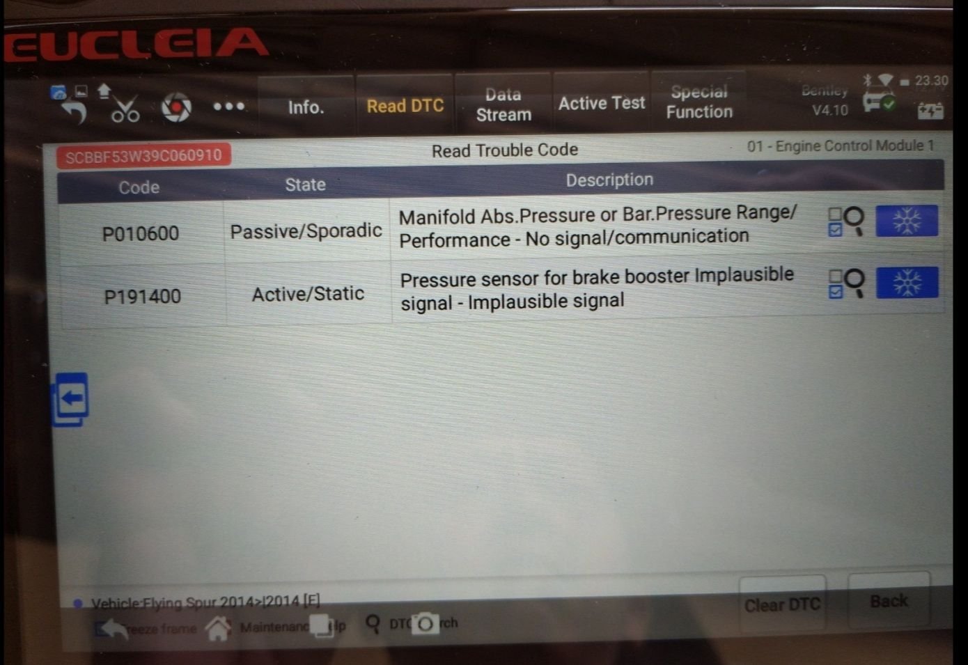

I am grateful, the 7-12 injectors have returned to normal, the 12volt voltage to the injectors already exists and the fault code in ECM2 is gone.
now a new problem appears, if the engine is cold, I turn on the car there is a slight shake and a new fault code appears in ECM 1, if I turn off the car, it keeps turning on again, the shaking disappears.
what else should i do?
this fault code at ecm1 now.

For P010600 the recommendations are to check the MAP sensor wiring/functionality and intake plumbing/vacuum lines for loose hoses/connections, leaks and ECM.
https://www.autoblog.com/2016/03/12/...map-barometri/
Since yours states sporadic, you might check the last occurrence and see if it is prior to whatever you did to fix the 1st problem.
For the second issue, there’s no cross reference bit the below suggests checking out pressure sensor, brake pedal switch, brake lines/fluids, and Ive read, vac hoses.
http://wiki.ross-tech.com/wiki/index.php/01435
