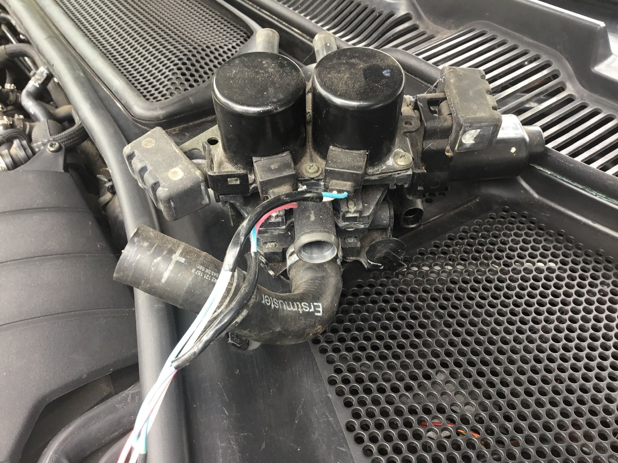

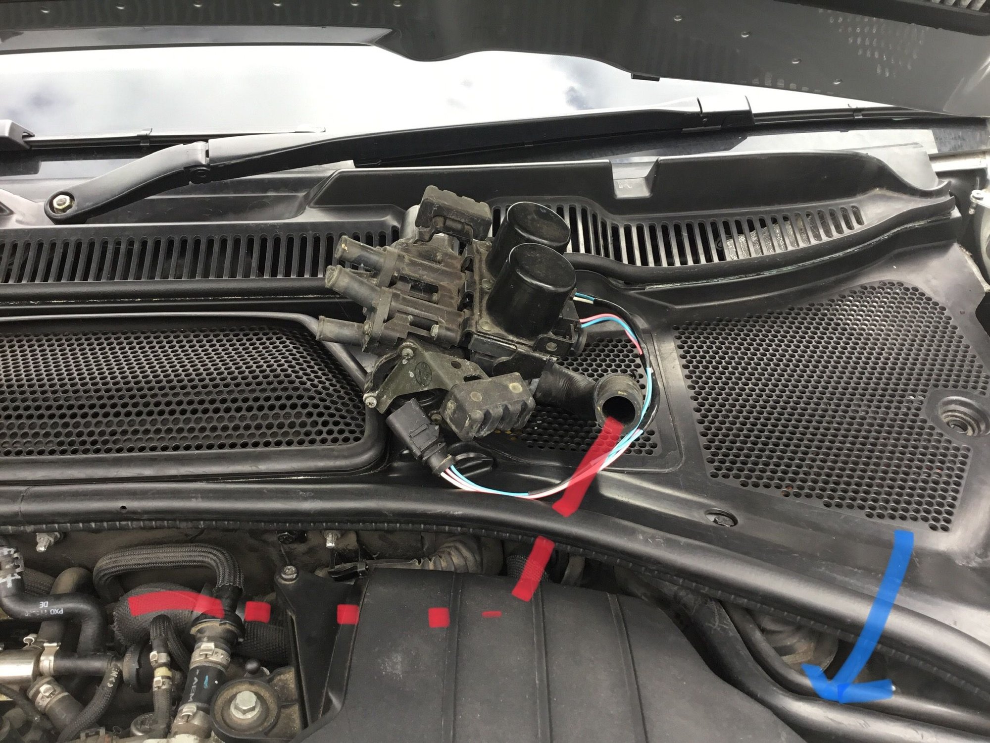

Remove the scuttle shield and check the pip-age to , and around the heater valve .It might just be a leak there = easy fix .
Red coolant ( hot ) supply . 4 outlets but it’s blended with cold from the AC before it enters the matrix .
Sits under the scuttle shield . Check the hot feed for leaks .
