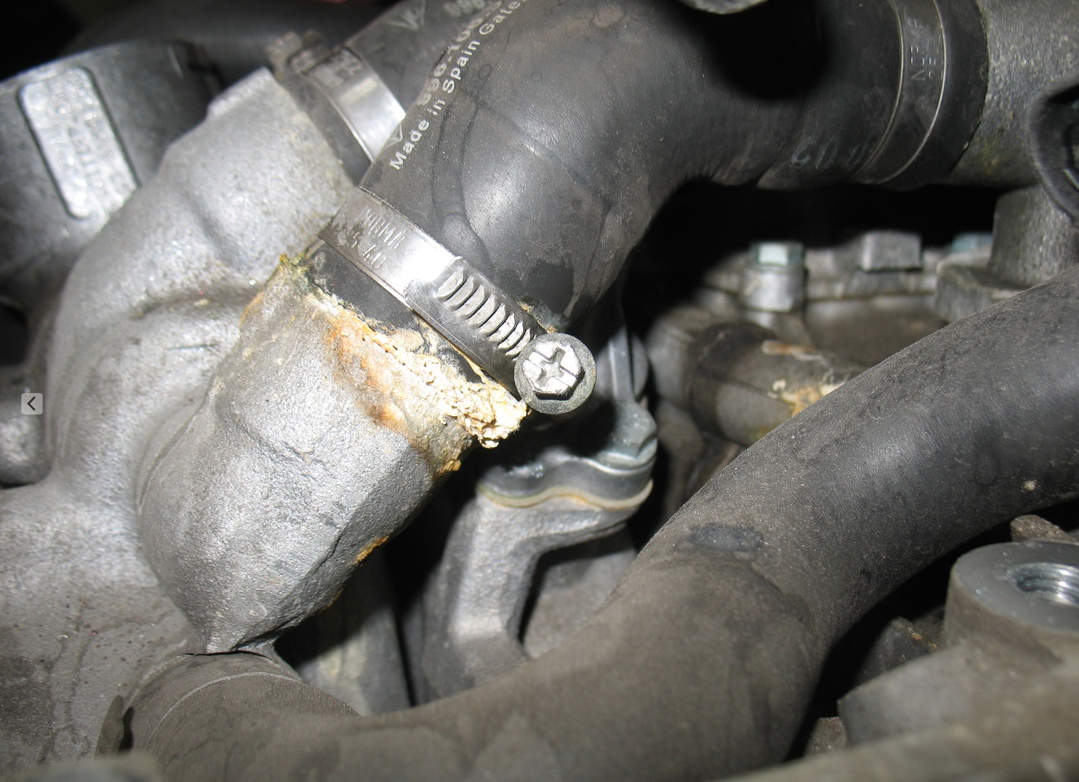

I had coolant smell for a long time, until I decided in 2008 to do a proper inspection of the engine. Took out the airbox and the alternator to found one of the coolant pipe from the water pump housing leaking. It did not pop out due to restricted space and there was no leak on the floor because the coolant was evaporating on the engine block.... I also had the left radiator top plastic cover leaking but I had drops on the floor in that case....
Name:	Screen Shot 2016-04-28 at 21.27.23.jpeg

Starting to collect parts a few at a time until the car comes off the road next winter. Will be removing engine/tranny for maintenance. One of the jobs I will do is properly sealing the manifold nipples as I understand this is a potential problem. Hopefully I can drive the car this summer without any major problems .Thank you for sharing.
