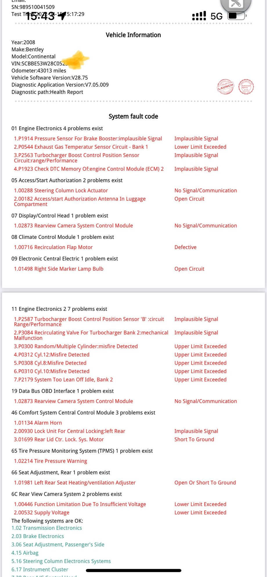

Error codes
while waiting for the Ross Tech to arrive I took the car to a garage I know well for scan. This is what came up. Any suggestions where to start digging for the fault?
Thanks

The attached scan was a good start. Now delete the codes and drive the car for a couple days and rescan. Also find someone to perform a dynamic load test on the batteries. Sometimes weak batteries cause spurious trouble codes. Anyway some of the codes may be old and no longer pertinent.
Based on the scan, the car has misfires which might explain the occasional check engine light. Also the exhaust temperature sensor is complaining.
In conclusion dynamic load test the batteries, delete codes, drive the car a couple days and rescan. Please post the results of the second scan once you have your Ross Tech VCDS.

Just an update here. It was the vacuum hoses that gave up and probably caused much of the issues. Hoses fixed among other things like suspension bushes and engine mounts. Obviously full service with spark plugs and transmission oil.
