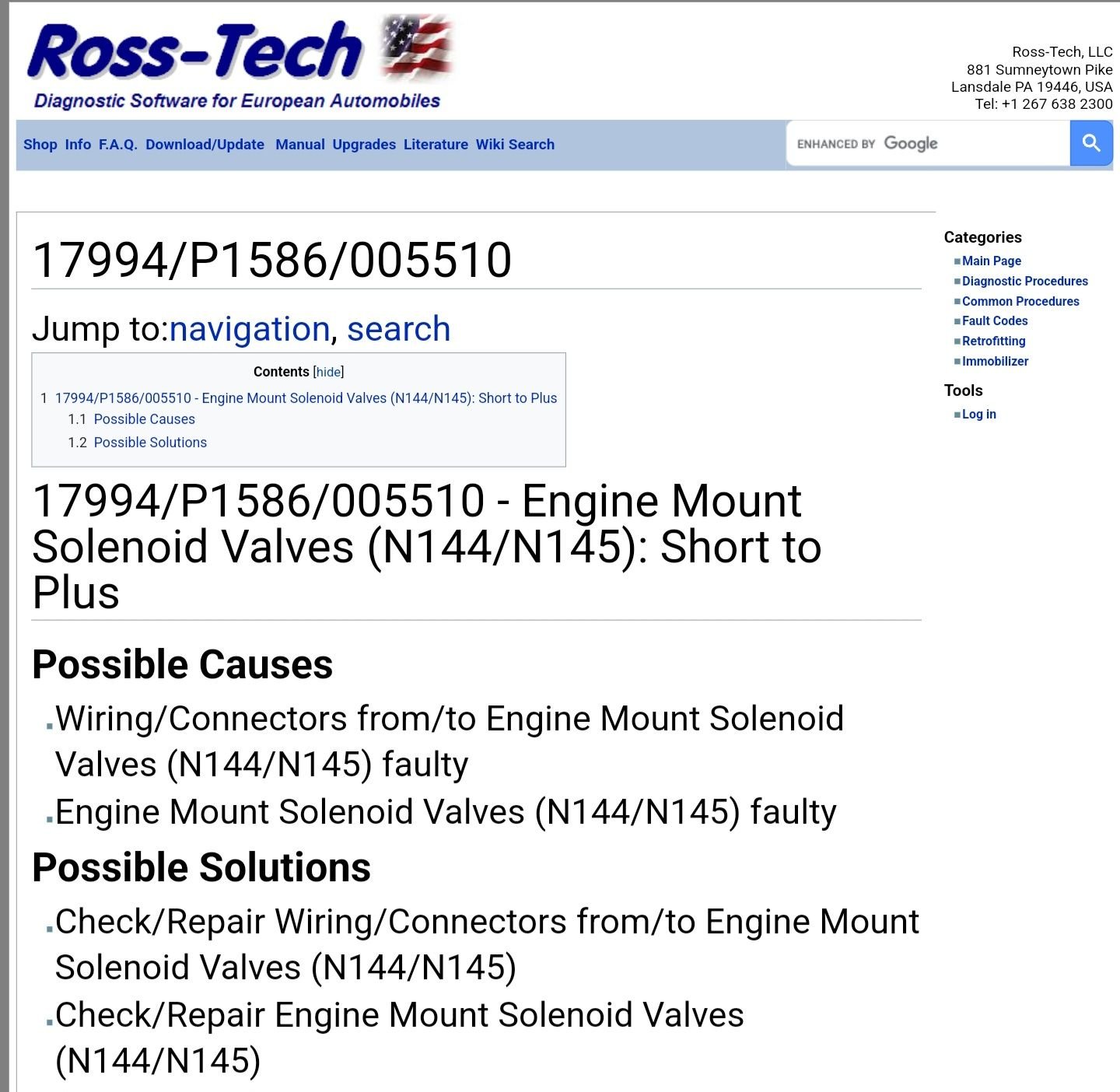

Hello @Cervezax ,
Your flashing check engine light has nothing to do with the engine mounts having a fault, the flashing light is because of serious misfires occurring, a flashing check engine light is a warning to stop the engine immediately, as your screenshot shows, the scanner is telling you to check for errors in engine control module number 2, as the vehicle has 2.
See pictures.
Johnny

​​​​​​Hello @sazam ,
Please double check the fault code, as 17944 is an engine camshaft sensor fault, but 17994 is for the engine mounts.
17994 is a short to plus, so, I would purchase the resistors that I spoke of back at the beginning of this thread, or figure out the resistance and make your own, this way, by plugging in the resistors you can test if it is a wiring fault, or either engine mount itself, another thing to look for, is the brown goop leaking out of either engine mount, the leaking fluid is a failed mount, if no leak, and the resistor shows all wiring good, and gets rid of the fault code, then it is your choice to either replace the mount/s or leave the resistors in place.
Just to note, the 2008 and up did away with the electronic engine mounts, the mounts look the same, just no electrical connection, as far as changing the mounts, doable from the bottom.
Johnny
