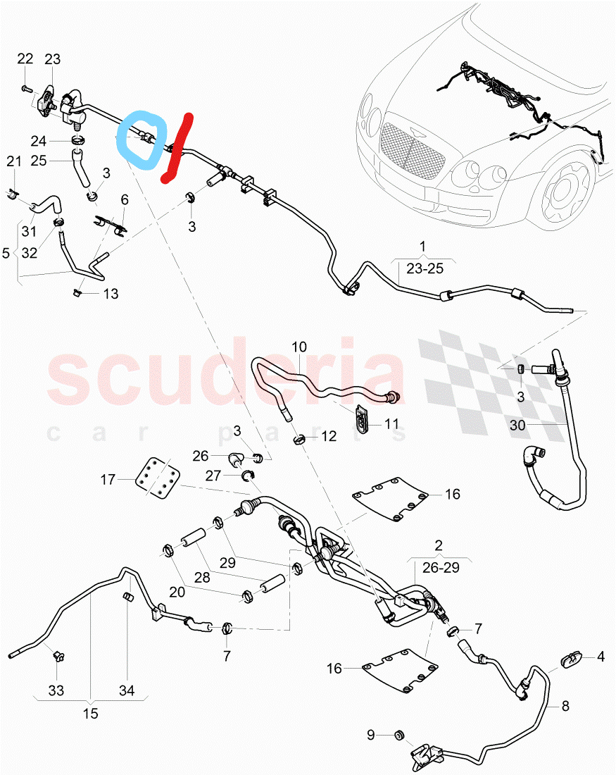

Not according to this though. there's a connection in between the sensor and the engine center pipe
https://www.scuderiacarparts.com/par...121/2097/37017

silvertonesx24 has much to be proud ofsilvertonesx24 has much to be proud ofsilvertonesx24 has much to be proud ofsilvertonesx24 has much to be proud ofsilvertonesx24 has much to be proud ofsilvertonesx24 has much to be proud ofsilvertonesx24 has much to be proud ofsilvertonesx24 has much to be proud of
Blue circle is a connection. Red line is where I cut and capped my line

Not needed , you bypass that piece and connect directly before the sensor

I see what you mean , but I bypassed that piece and connected directly before the sensor , not sure how accurate this diagram is for 2007

My concern would be that you cut off a bunch of the system that goes to the engine. Of course, I also cut off a bunch of my system that goes to the purge valve and exhaust valves, but I'd be much more concerned about cutting off engine stuff. Anyway I plan to test and hopefully your shorter routing will work and ensure I can reconnect the back of the system without getting a quick vacuum pump on acceleration.
