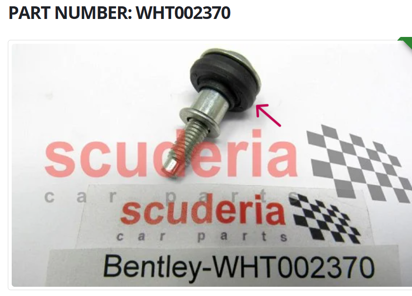

The reason the bolts are specified as "replacement" is because of the rubber seal imbedded on the bolt (see Arrow). Technically, this becomes a "seal". Engineering standard says "seal parts" are one use only items. Bentley cannot recommend these be used over without running afoul of the SAE standard. This is the same issue I see in many other car manufacturers and I've run into similar on my AMG.
Then, there is reality. I good tech is going to inspect these and if they are in good shape without cracks or brittleness in the rubber seal they might reuse and you won't know it. A Bentley dealer, especially on a warranty will probably replace all of them.
I agree with Eric here, a few spares will probably get you through unless age has spoiled all of them on your car. However, some shops will also go "by the book" BC they will have to redo on their dime if any leaks.
