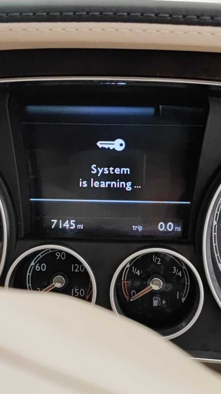

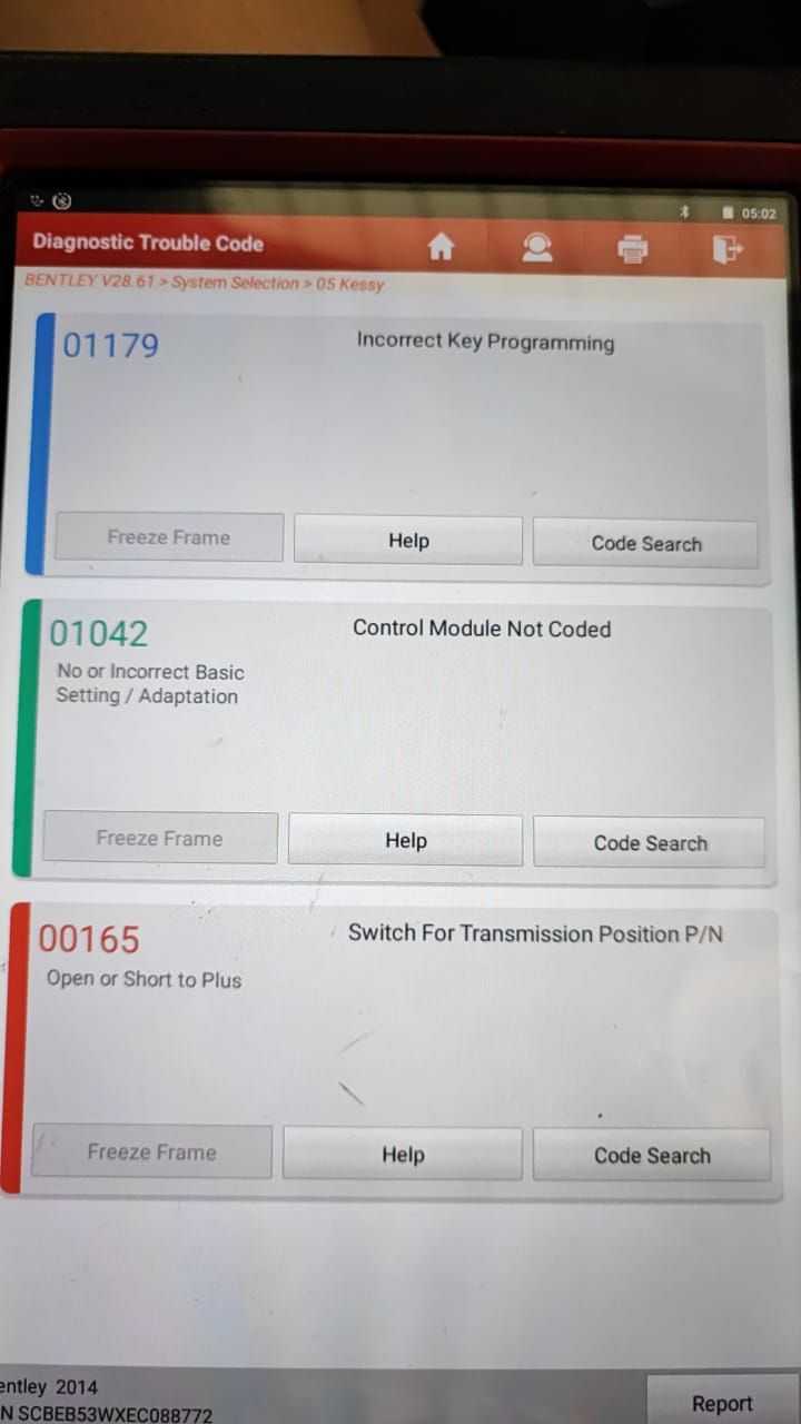

Hi All
I have a 2013 Flying Spur with a damaged kessy unit.
My keyman had tried to get the pin from the old kessy but failed due to the damage on the electronics.
I have purchased a new kessy unit but unable to reprogrammed the keys.
Would appreciate input on how do i proceed next.
thank you
