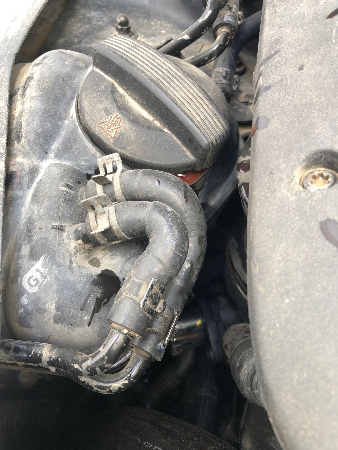

Hi all
i have a weird car, two weeks ago the front suspension went down, when I started the car I noticed upper coolant hose leaking, removed all parts, applied some RVT and let it sit for 2 days, I used jacks to raise the front and add coolant to remove air then started the car for 15-20 mins till hardly could see any bubbles coming out, left car sit overnight, drove the car 20km around and no overheating
couple of days later I started the car again and within 15 mins idle it went overheating and water was boiling and coming from expansion cap like crazy as in the picture.
I put my hand on the upper coolant hose and it was hot which means thermostats is fine as I understand, water pump was replaced less than 4 months.
Any advice is very appreciated
