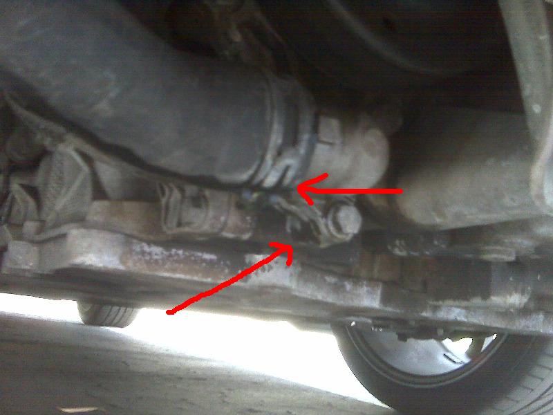

Got the flashing coolant light today on way to lunch... turned around and parked it only to notice pool of coolant in my parking spot.
So I think it is my water pump.
It is leaking from these two arrows in the picture...
Can anyone say with some confidence if this is a bad water pump?
I like to DIY when I can, but am thinking of taking it in because my coolant is a very light green. (like watered down, and shouldn't it be pink?)
Figure let them look at it and do it right... and try not to let them talk me into any extra goodies. well, maybe not try too hard.

more probable that it is a crack in your coolant reservoir (common failure)

Crazy thing- I filled it with water and ran the engine to operating temp.
No more leak. Drove it home (2 miles) and still full and no leaks.
Still will do the tank swap then hopefully not have to move onto anything else.
Judging by the fact that it is clearly not leaking from those two arrows I would say no. In the picture you can see a stream of coolant coming down the left side of that hose. This is typical of the reservoir being cracked as it will run down and drip off of other components. I have seen cracked reservoirs leak down along the exhaust and then down the tip, convincing some that the coolant is coming out of the exhaust when in reality it was just the reservoir.
This is an easy fix but unfortunately the reservoir is easiest to replace with the motor out of the car. The good thing is that it's NA and a decent Porsche tech should be able to drop the motor, replace the tank, and get the motor back in the car within about three hours, though the whole process will call for charging more book time than is needed at the average shop.
Hope this helps!

You can do a 3.4L without an engine drop... I did mine on my 2001, but there is an extra bracket on the new tanks that you cut off. Its for the fuel filter on a C4 or GT3 I believe...
3.6L or Turbo you need to drop the engine a few inches.

I did it without dropping the engine... hint for others: Once old tank is out, remove the bracket that the coolant tank hangs from, otherwise I could not get the new tank back in.
in the process of putting the new tank in, I broke a nipple on a hose... a hose that retails for $130... ****!
picked up the hose today and will install tonight.
I sure hope that is it. I have a bad feeling about it look like it was leaking from the other arrow in my post above...
Hey, what do you guys think about me just putting water in for now?
Rather than the liquid gold and risk losing it anyways..
I figure use water tonight and once confirmed all good, drain, flush and put in the porsche stuff?

I would replace the hose first and see.
