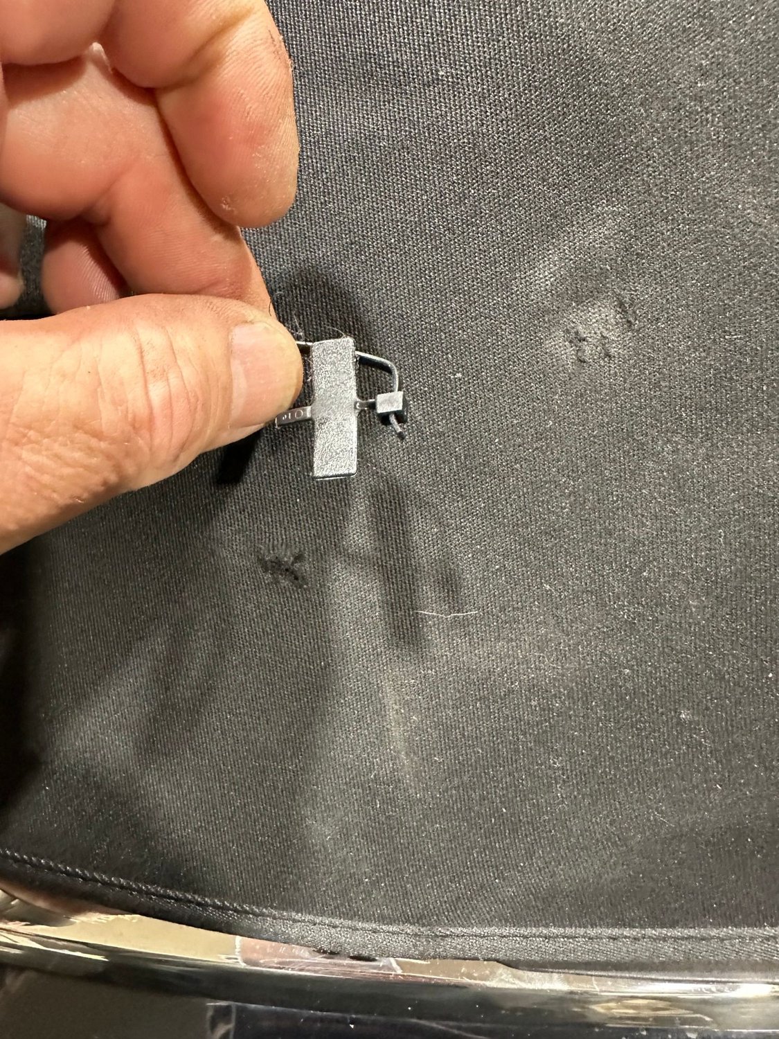

My top has the same two holes only a little worse than Gears500. Mine definitely pinches when the top folds. Seems like the hinges hit. The passenger side is not like this. I just bought the car. When I looked for the zip tie, I saw the broken on in the picture below hanging there. I assume this zip tie was the one in question, but who knows. I wonder if the "tab" on the zip tie is supposed to add protection between the hinges.
Old Aug 25, 2023 | 02:01 PM
tteplitzmd's Avatar
5 Year Member
Joined: Jan 2021
Posts: 298
From: Chevy Chase, Maryland
tteplitzmd is infamous around these parts
That's very helpful. Anyway you could highlight on the bottom photo where the zip tie is/was?

This thread just saved me. Same thing happening. The zip tie broke and punctured my 2017 GTC Speed.
Old Apr 29, 2024 | 03:28 PM
tteplitzmd's Avatar
5 Year Member
Joined: Jan 2021
Posts: 298
With the zip tie broken what actually does the puncture?
