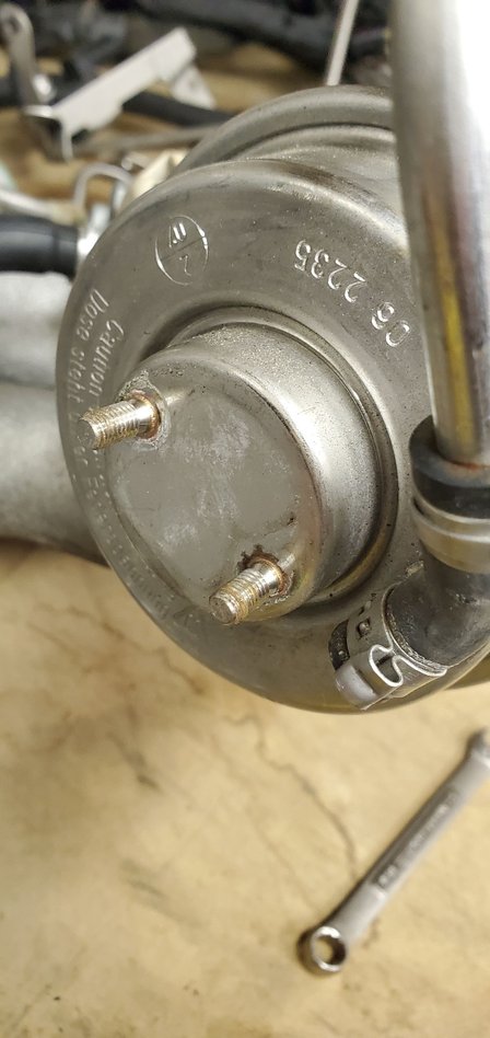

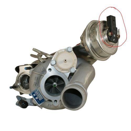

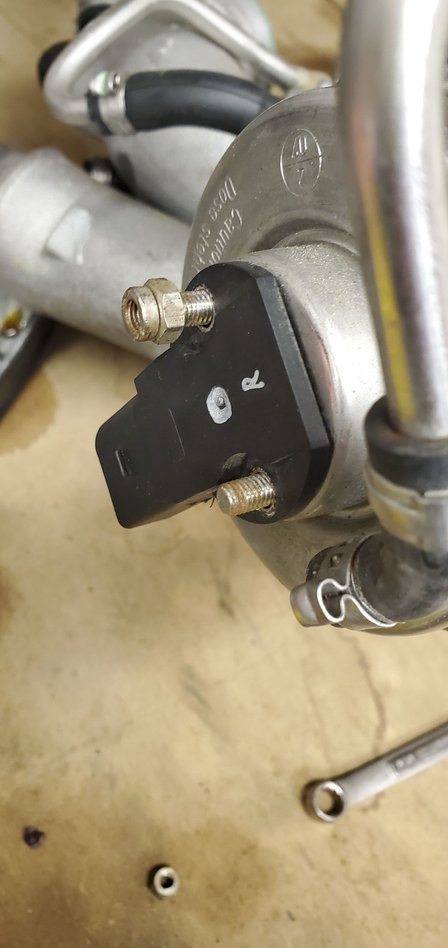

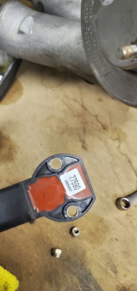

I noticed in my Bentley the following sensor/solenoid broken in the passenger turbo wastegate actuator... ¿where can I buy a spare one?
Thank you.

Thank you for the response, I already source one, but I have a question in regards the wastegate ¿How do you calibrate the wastegate?

So, ¿Any rod length will work? I dont want to tight it too much and blown the engine or too loose and lack of power.

Exactly that was the case, I had to remove both turbos and send them to a welding shop to weld a super tiny hole that was sucking air in the cold side causing rough idle and misfires (performing the smoke test you can literally see smoke coming out of those tiny holes one in each turbo). To be able to weld I had to disassemble the cold side and I had to remove the actuators since those were screwed to the cold side snail, now that everything is assembled again I discovered my wastegates lose, you can move them with your finger, they seems to need any sort of pre-tension from the actuator itself, but I don't know how much tension in the actuator rod is too much.

I have seen how to adjust the wastegate pre-tension in Borgwarner K03 and K04 but I haven't seen any information on K16, I dont know how differente they are, but seems to be similar physically.
