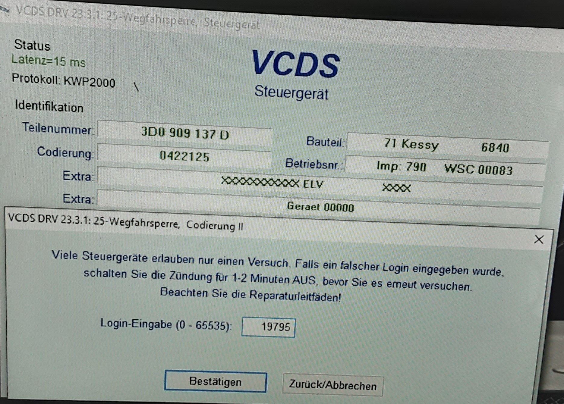

Hey fellows,
The keys have been ordered fabricnew from the national Bentley distributor. The first one once put in, nomore able to put out and the message " immobilizer active " is shown at the same time in the control unit. So it is about to code the immobilizer with the new key. Can anyone of you show me the right working procedure?

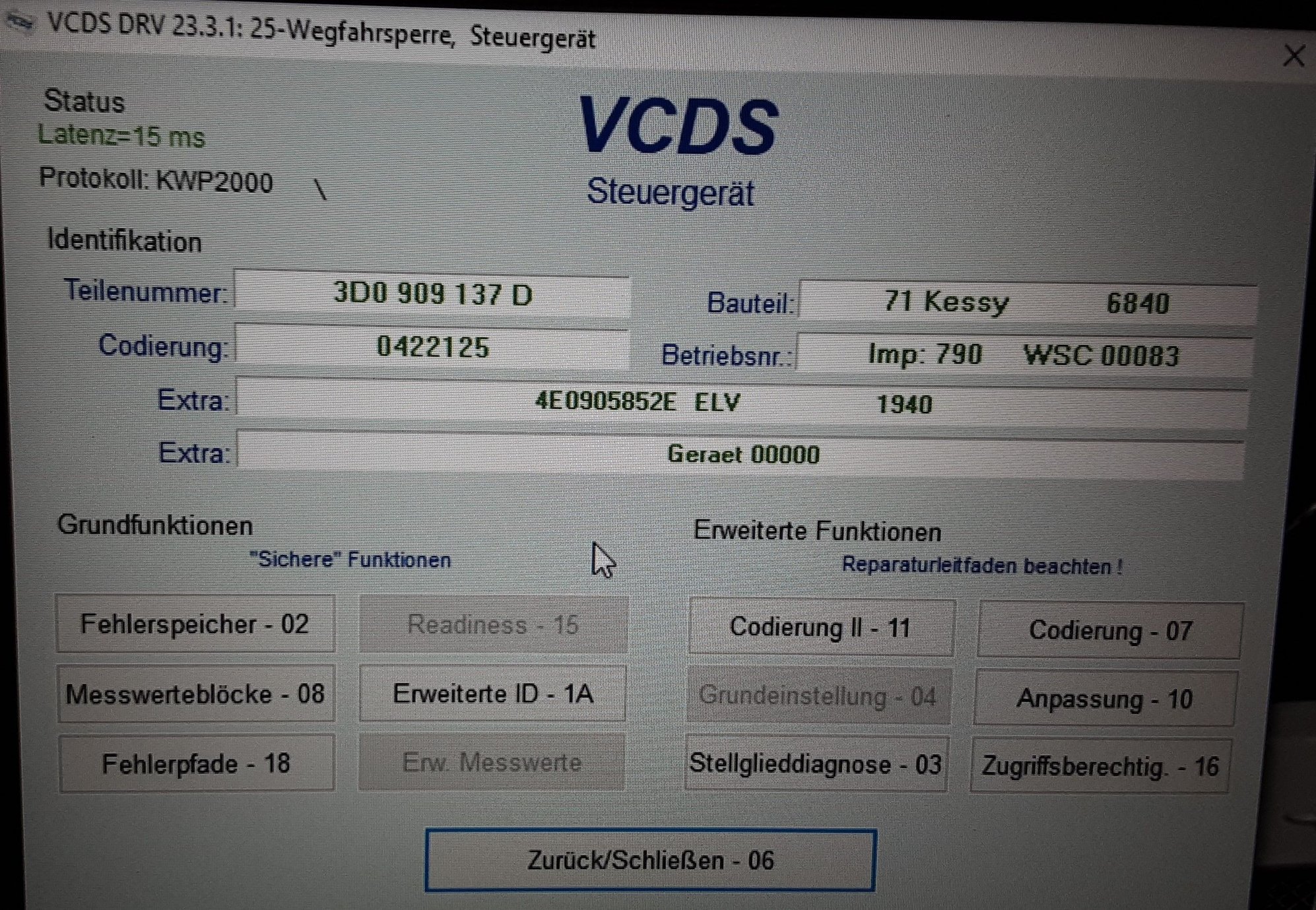

EDIT: I just read your visitors message, so you have no original keys/fobs, and you are attempting to access the KESSY module via code "19795" via "codierung II - 11", none of this will work, you need the 4 digit SKC as I explain below, with this 4 digit code, you add the zero and use this 5 digit pin/SKC in "Zugriffsberechtig - 16" aka "security - 16", the you open up "Anpassung - 10" aka "adaptation - 10", BUT, none of this will help you without the SKC as explained below...

As to your key fob issue, I take it that possibly you are using a translator to post, as I can not follow exactly, such as "fabricnew", and the Ross-Tech VCDS is not shown in English, BUT, from what I think I see as to the Ross-Tech screen is, I dont see the 5 digit SKC = Secret Key Code, the SKC is a 4 digit numeric code that you add the 0/zero in front of to make the 5 digit SKC such as "01234", SO, do you have the SKC, you can NOT retrieve the SKC with Ross-Tech VCDS, you either retrieve the SKC from the KESSY module 93C86 eeprom with Carprog, this will give you the 4 digit code that you add the 0 to the front of, or you retrieve it from the 95040 eeprom in either of the engine ECU'S, this method requires Ponyprog and a chip reader along with a serial port laptop...
Or, you drive or flatbed the vehicle to Bentley so they can hookup to the mothership to program the new fobs to the vehicle KESSY.

Ross-Tech procedure with proper SKC.
http://wiki.ross-tech.com/wiki/index...atching_(Kessy)
