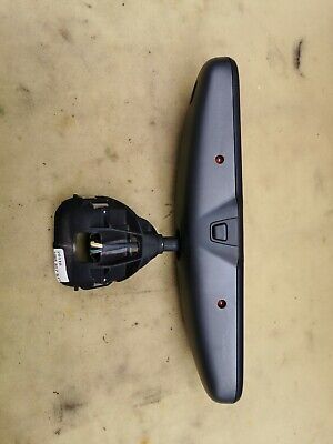

Unfortunately I’m not in the USA, one more question, the two small bulbs beneath the middle mirror keep going on and off even when the car is locked, anyone had faced this issue.
@Johnny Hotspur GT @BWings
Two bulbs going on and off all the time
