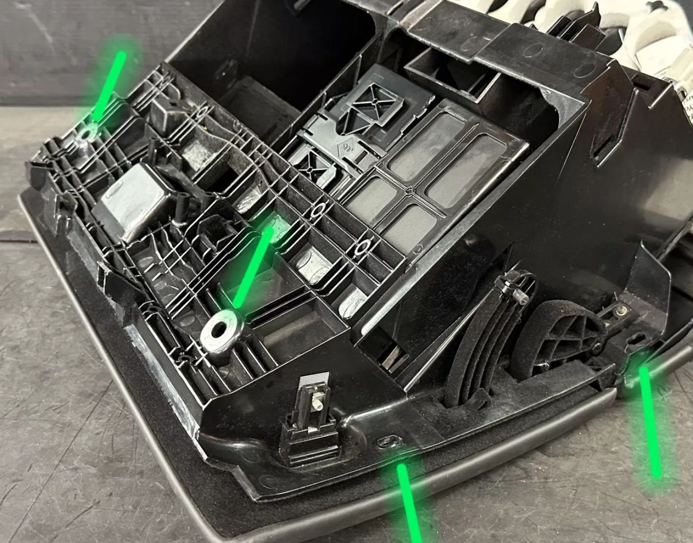

Hello @Hortonm44 ,
The Gen 2 is definitely a different glovebox setup, but, I think the mounting is similar to Gen 1, I have added some pictures of the Gen 2 glovebox assembly below, see my green indicators, if you open the GB door and look up, kind of like your on your back looking up, you should see 2 or 3 screws in the recessed areas across the top, then either 1 or 2 down each side.
Be careful of wiring and plugs, depending on which options you have in your GB.
Johnny

Oct 9, 2024 | 05:05 PM
That is a tremendous help. I found the screw locations easily and the photos are exactly my set up. Just waiting for the agency that sole me the car to get in the new latch assembly and I will give it a go. I assume the felt linings come off with a gently prying like most things Bentley.

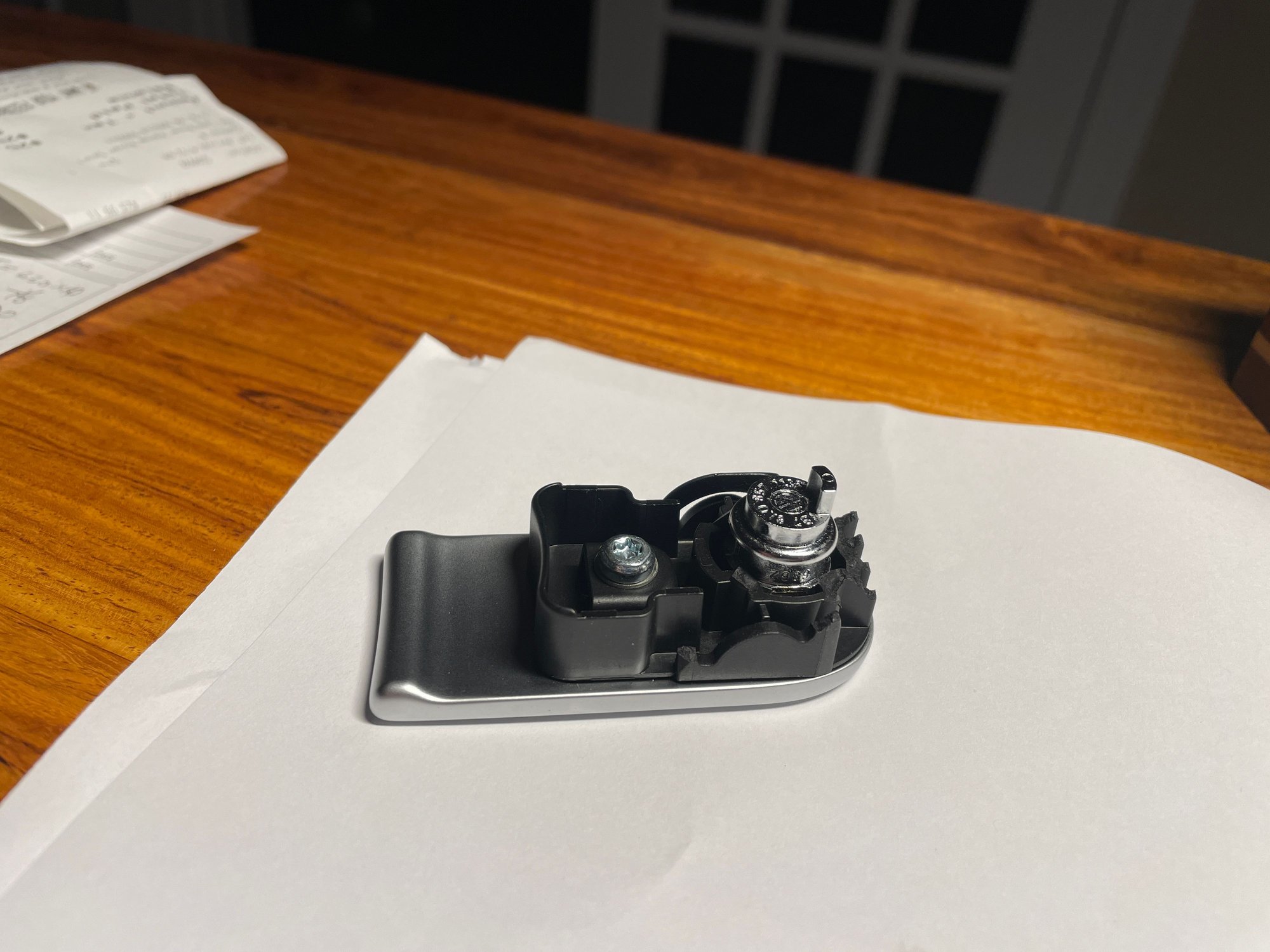

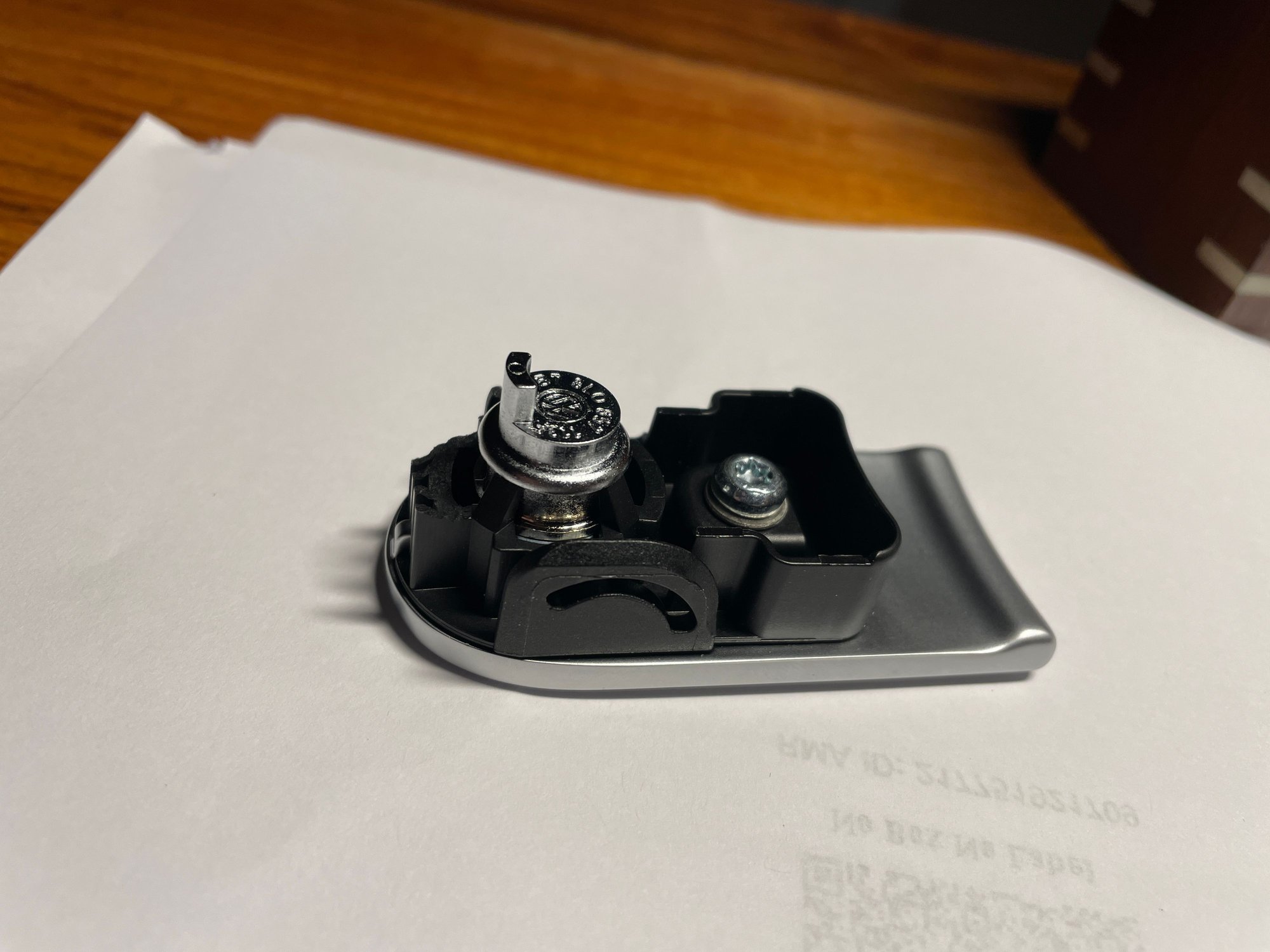

Oct 9, 2024 | 08:35 PM
Glove box issues
It is actually the latch that is broken and fallen out. As you can see from the photos, part of the plastic backing piece is broken. I just need to get inside the door and either replace the mechanism, or perhaps buy a used door on EBay and simply replace the plastic piece. In the meantime, I can open the glove box with my finger on the lever inside, so this is not something that is urgent to be fixed. Just don't want it to turn into a bigger job than it needs to be
