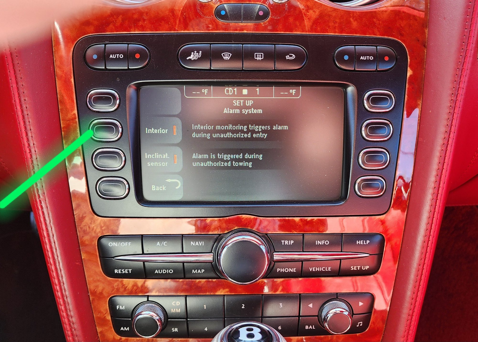

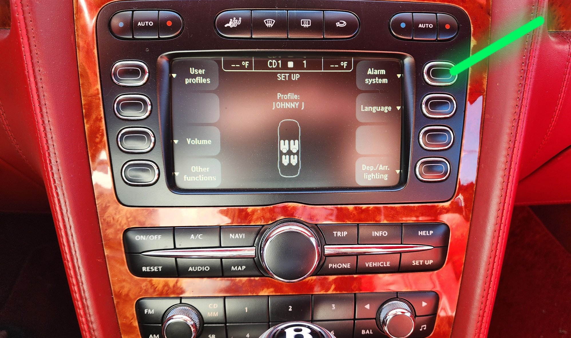

Edit: I forgot the explanation for the dark setting for parking, so, as you approach the vehicle as parked, take notice if any interior lighting is illuminated, even the two yellowish gold LED'S that shine down form the rear view mirror, as with the vehicle alarmed and asleep, with the keyfob in the house, and the interior motion detector turned off, those two lights shining down should not be on, if they are, the vehicle is not fully asleep.
Note:
If you do the window down to listen to the drives, be sure to arm the vehicle when parking, then leave the keyfob far away from the vehicle (in the house), do not touch the door handles or trunk at all, you want to vehicle to be as it is sleeping, so 30 minutes or so after you park it, prior to parking it, you may also want to go into the Infotainment head unit menu and turn off the interior motion detector, it is the "SET UP" button, then "ALARM SYSTEM" then "INTERIOR", if you don't, be sure to stick your head in very slowly, as the interior motion detector will set off the alarm.
Johnny
SET UP. .
ALARM SYSTEM. .
INTERIOR MOTION DETECTOR. .
Last edited by Johnny Hotspur GT; Oct 24, 2024 at 09:28 AM. Reason: Add information
