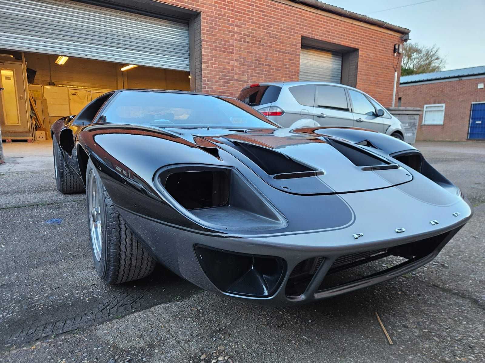

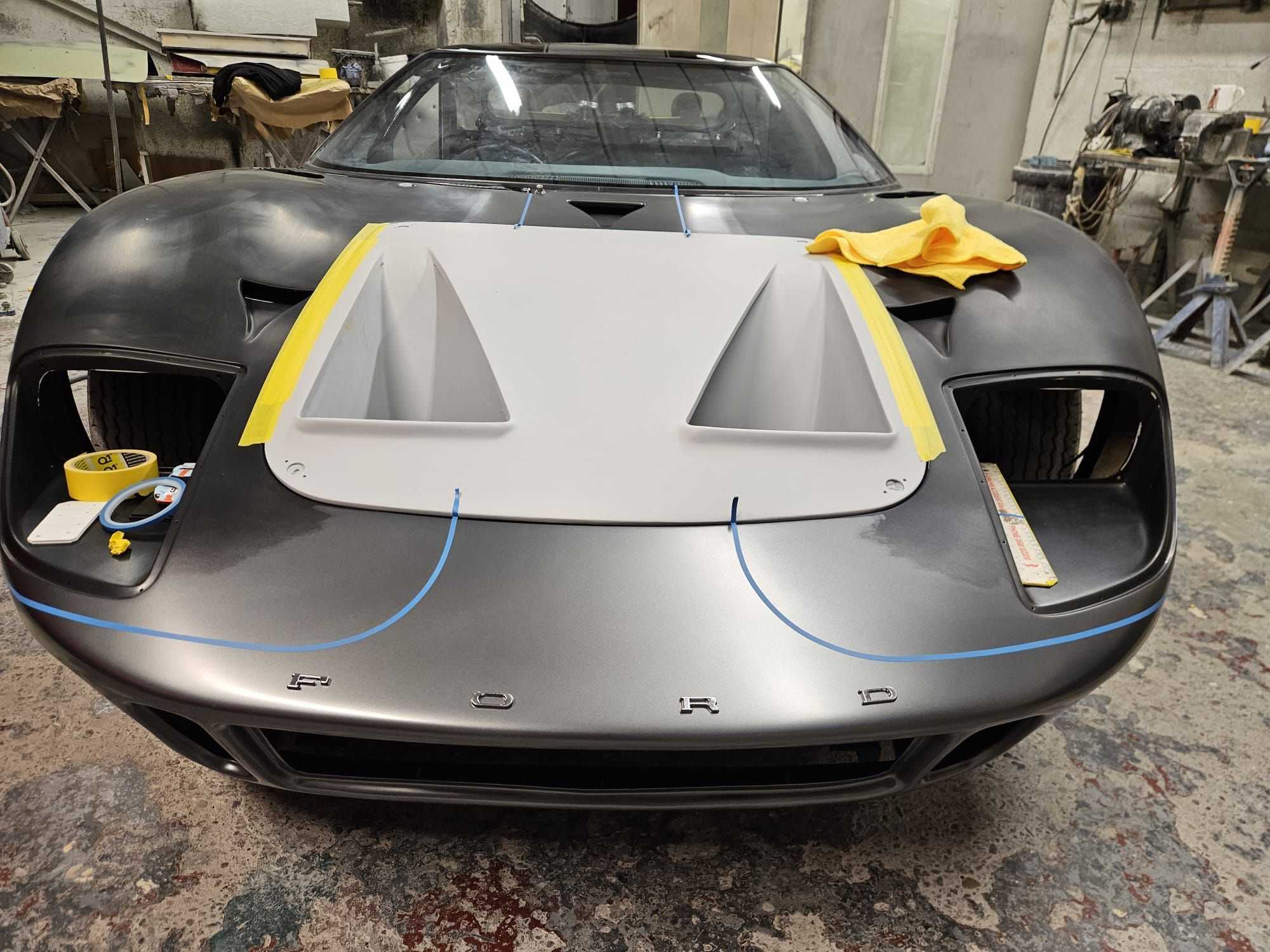

I may keep it till the summer time but its not for me im afraid ...I just like working on motors ..as im retired and do abit of trading to boost the pension up
This is my other baby ..after 4 years of graft
Just out of the paint shop
