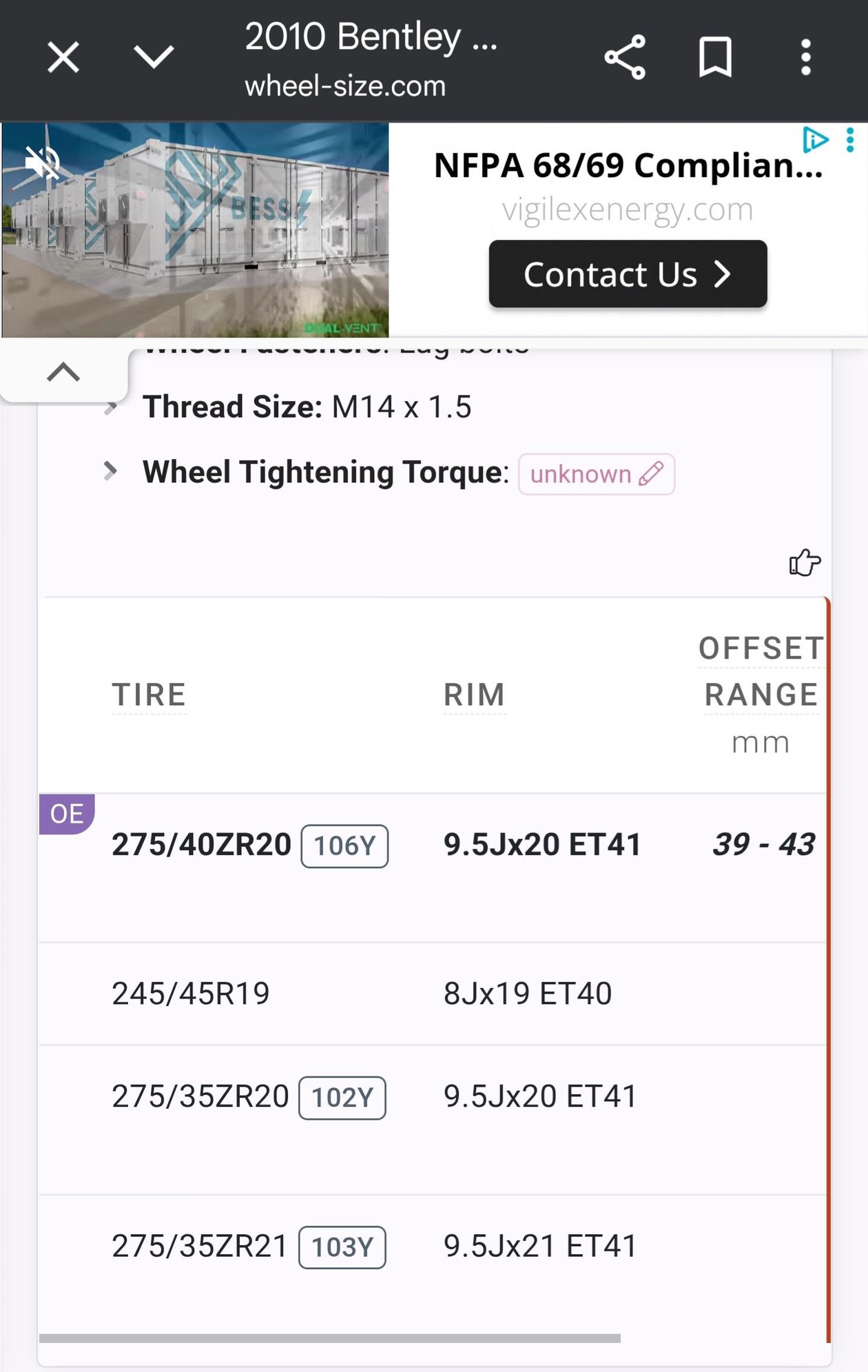

I understand, I never searched by tire size, always by vehicle, and there are sites that state that the 275/35/ZR20 102Y fit the GT, as the 20" wheels were an option for the GT, and the tire size was the same as I purchased, the 275/35/20, and I remember searching about the 20" wheels and correct tire size back when I was ordering them, there are even posts here on 6Speed stating that the 275/35/20 were an option, and they state the 102 load rating, even Tire Rack shows the 275/35/20, but states the it is not available at this time, I even called the supplier that sold me the 275/35/20/102y tires, he claimed that the 102 is correct for the Bentley GT, as the size was an option from Bentley, not just an aftermarket tire size, and stating the the manual we all read as I posted the picture of, that it states the standard wheel/tire size, not the optional.
So, I am a little confused, as sites show the Bentley GT with the 35 tire at the 102 load rating...

So the 275/35/20 "B" Tire fitted on my 2009 GT Speed was a 102Y, but manual just states a 275/35/ZR20 "B"-no mention of Load rating other than saying the 275/40/19 should be 105Y. I have a set of the original 275/20/ZR20 "B" marked 102Y in my Garage on the original wheels. The manual also states that Winter Tires in that size are to be 102W OR 101W. So apparently in the 275/35/20 on a Speed a 102Y is acceptable- Not sure what the heck you do on a Reg GT, but are we sure it was an option on the GT? not just std on Speed?

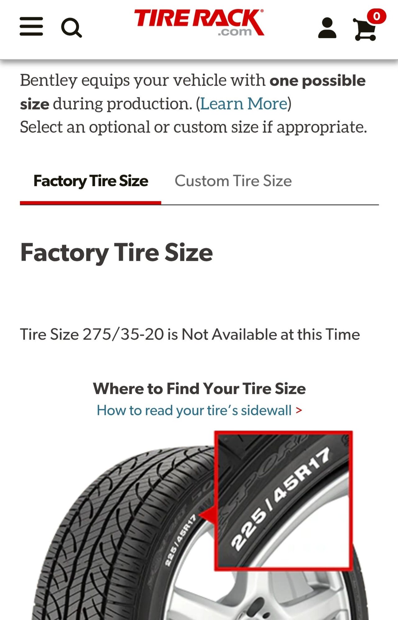

Tire rack when searching by 09 GT Speed, says they have no tires available, shows 275/40/19 as optional size which I don't know if you could get a Speed with 19" wheels. When you search a Reg GT, it also states no tires available in 275/35/20, but doesn't really show as optional size either. I don't have my Reg Gt owners book available to me , so not sure what is stated there. There is 165lbs per tire lower load rating on the 102Y vs the 105Y!? No listing in either manual for 21's, yet many have done 21s and mine has a set of 21" Vossens with 105Y, but anything 102Y and above ok? I feel fine with 105Y's on my 21's, and the 102Y was factory on 20", so good there, but if your running 19s you should have 105Y-hard to make sense of that other than lower profile less susceptible to rolling over/under? I guess I would err on the side of highest rating you can get.
