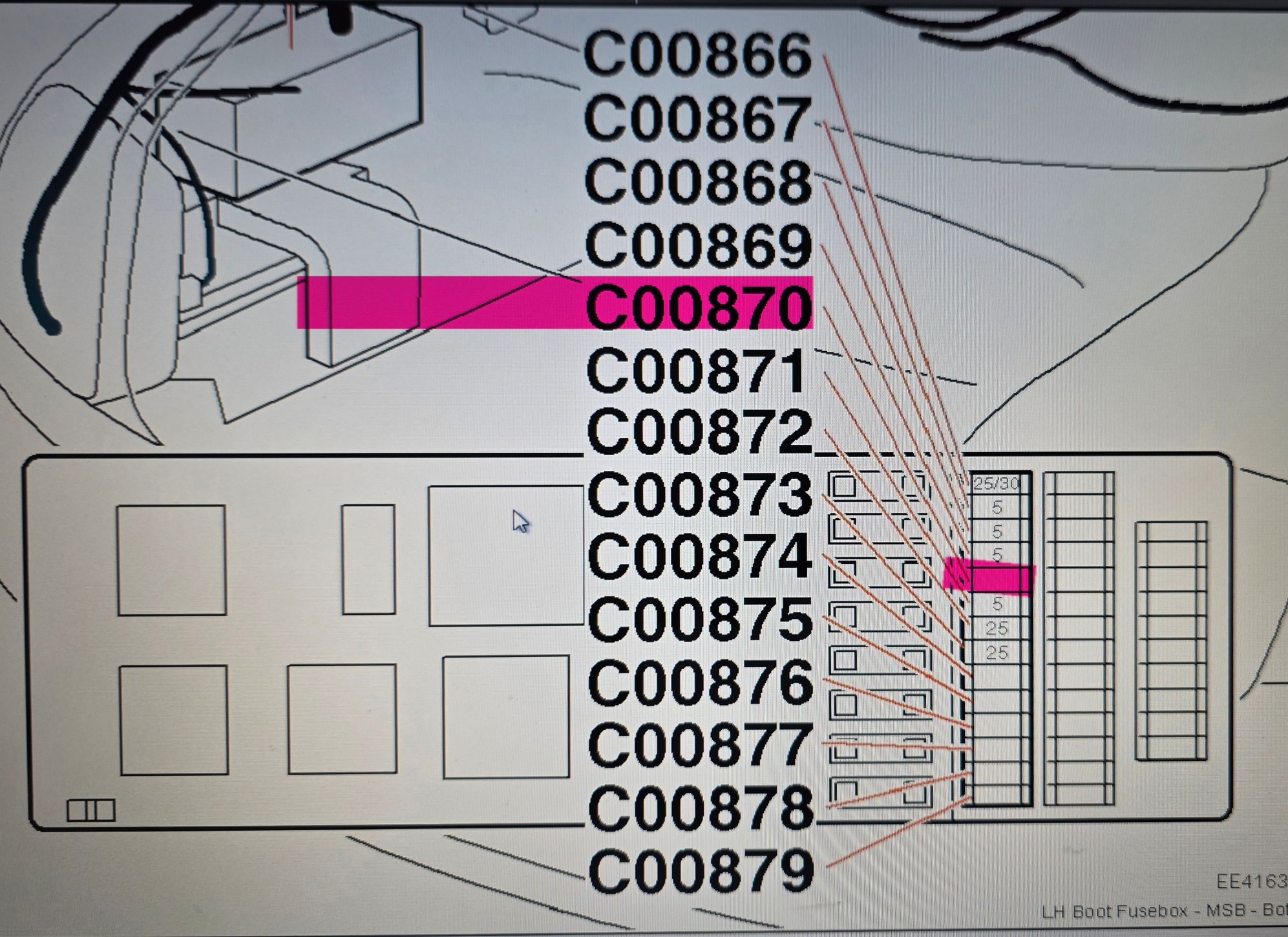

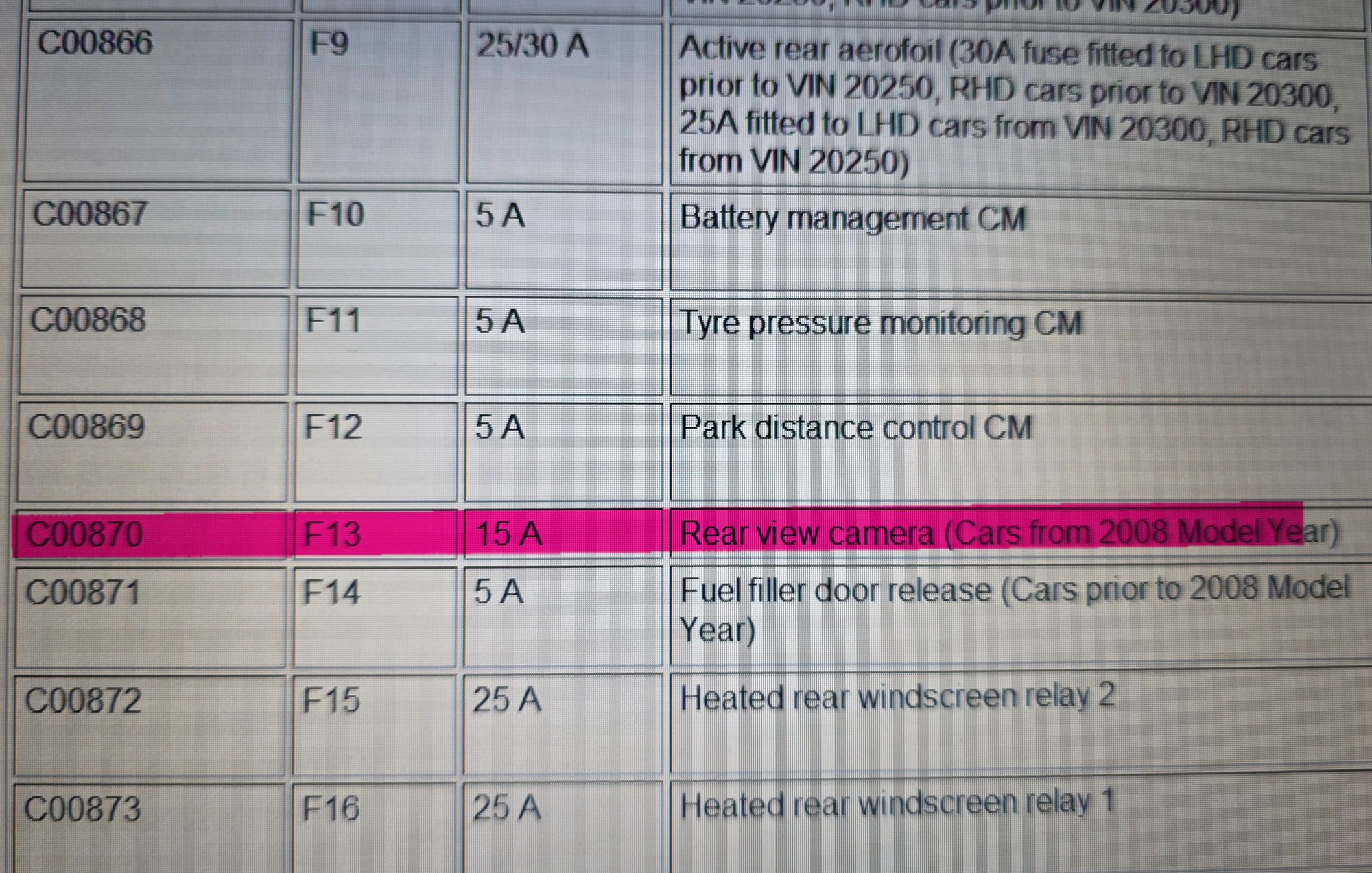

Hello @TonyQuinn ,
I take it you are RHD..
Fuse F13 in the boot on the left is for the reverse camera.
And the wiring diagram for the RVC module.
Johnny
