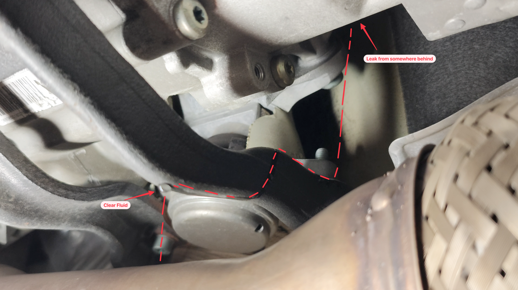

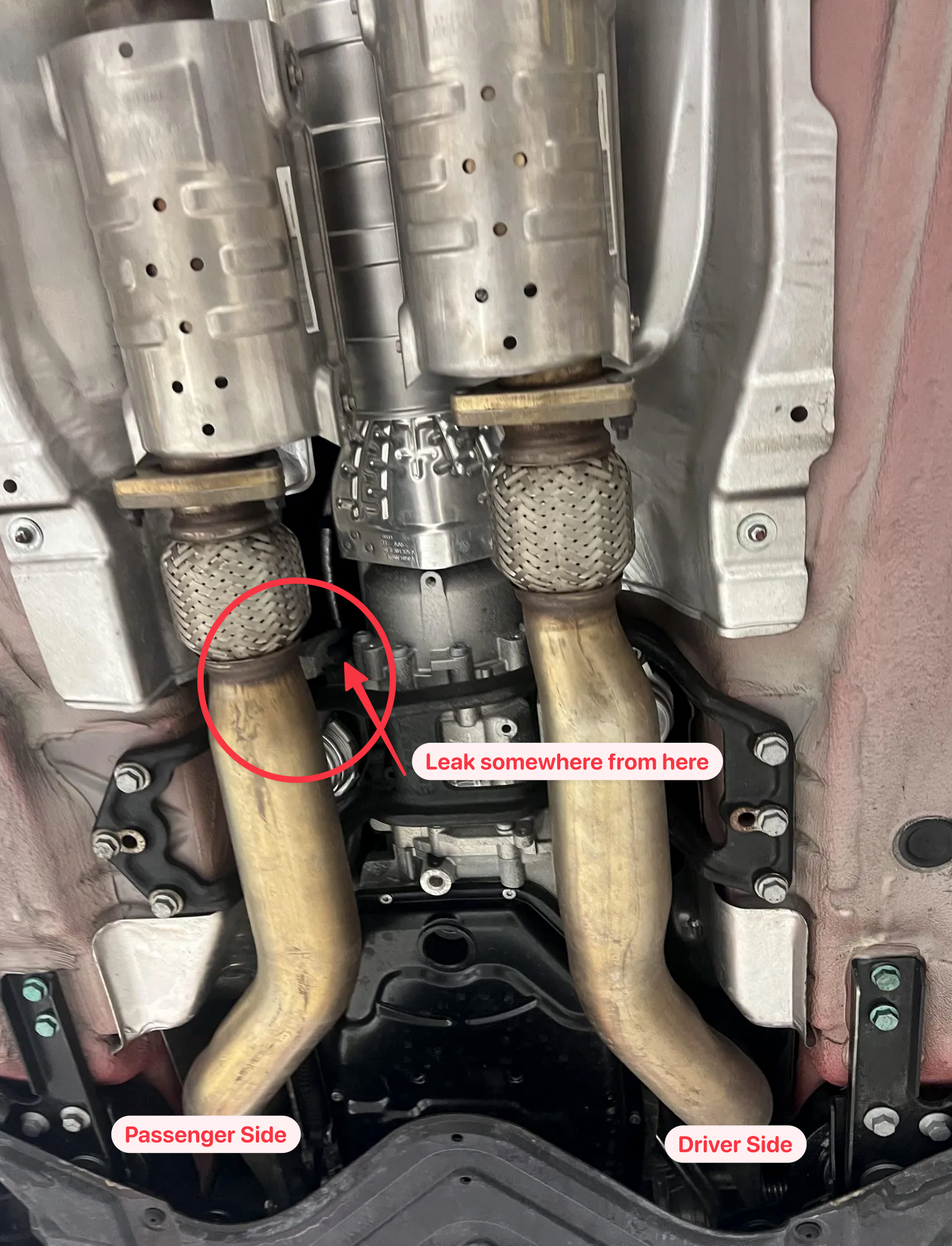

Started to notice fluid leak from my car's undercarriage.
- 2007 Bentley Continental GT
- Fluid appears to be CLEAR and NO SMELL. I think it is water.
- Leak is roughly on the front passenger side, right behind the front wheel.
- Don't think I have the leak all the time.
- For example, today I drove roughly 20min, when stopped, it is dripping at roughly 1 drop every few seconds.
- Attached photos.
Any idea what is leaking? Is it just condensation? Anything I should check or worry about? Thank you!

Hello @minming ,
Just for clarification, I believe that you have the passenger side and driver's side reversed, as you are in USA / California and would have a LHD vehicle, am I correct in my assumption ?

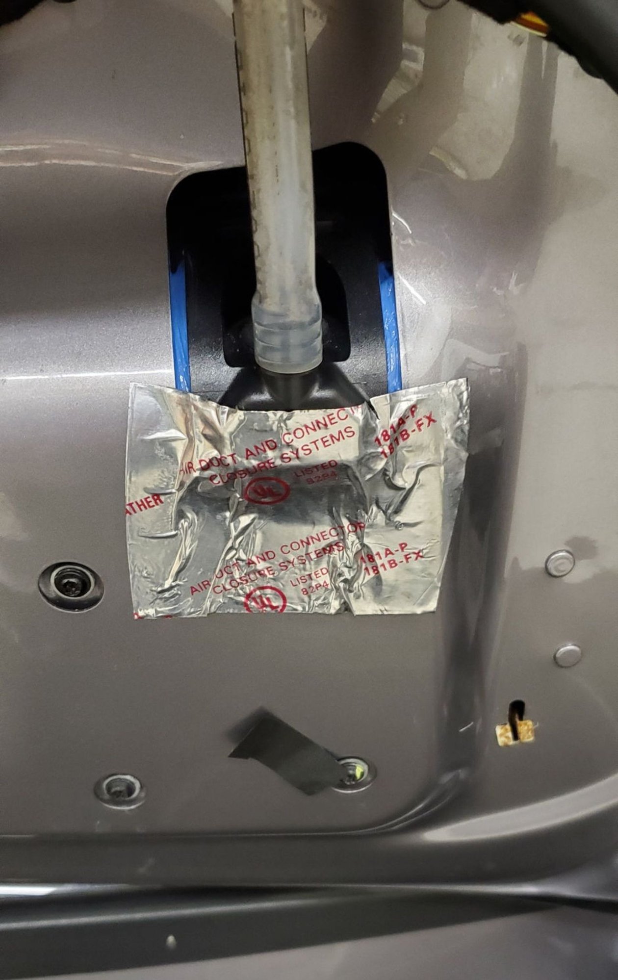

As to your concern, I would think it to be just condensation from the HVAC system drains, as you have one on each side of the transmission tunnel, there is also a cowl drain in the center of said cowl for rain water / car wash etc that drips down onto the top of the transmission, depending on the temperature in Oakland I would think it to be condensation, if it is, I would check why it is not dripping from both sides of the transmission areas, as the right side (sitting in the vehicle / passenger side) may be clogged, you can pull the carpet back to remove the rubber tube for inspection of any clogging.
Pictures of HVAC drainage tubes.
A picture of a clogged HVAC drain fitting to tube.
Pulling the carpet back to expose the HVAC drainage tube.
Generic VAG/Audi picture.
While checking the drains, might as well check the rear spoiler/bootlid drains for preventive maintenance.

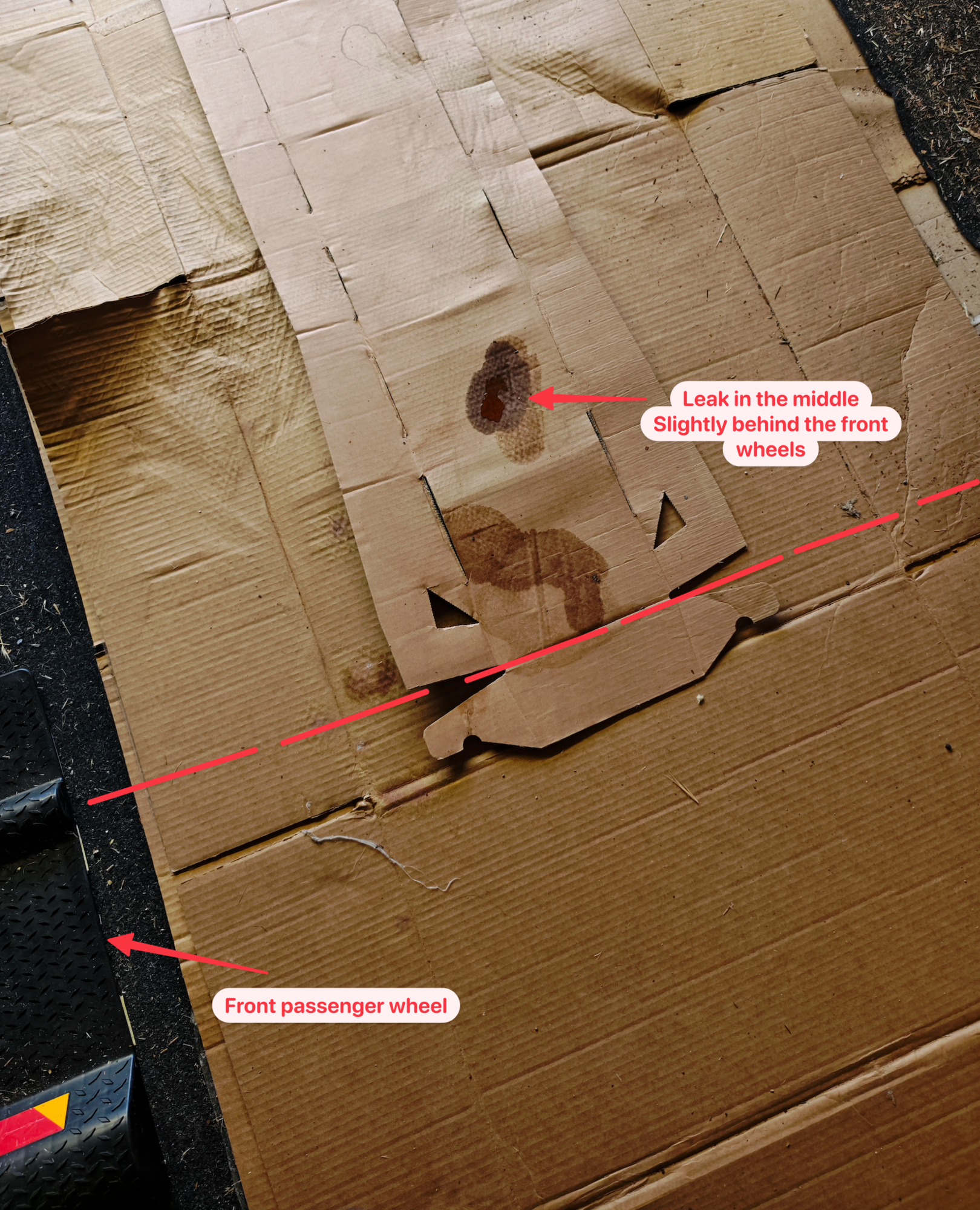

Thank you Johnny for the detailed response. I double checked the leak again on the cardboard, and today, the fluid is pink-ish color. Maybe it is coolant leak?
I suspect that maybe I've seen the condensation earlier, and I also have coolant leak issue.
Any advice on common coolant leak issues on 06 Continental, and potential troubleshooting steps?
