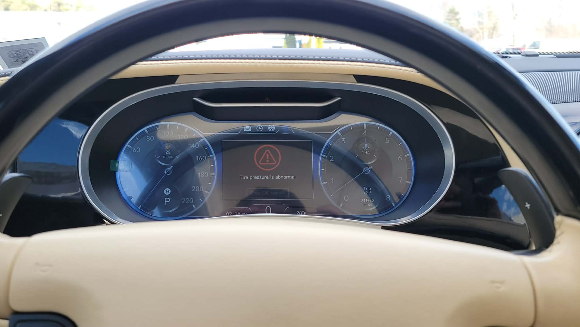

@Johnny Hotspur GT The unit came in today. You remove the motherboard and place it in the metal case. Then there is a harness that connects the two connectors from the motherboard to the new cluster and you plug the original cables from the car to the harness. The metal box gets bolted in the dash with the old screws and the new digital dash gets mounted on 2 new brackets that you install.

Install was straight forward. They sent me an older software version and just sent me an update to install. Unit comes with a USB port. When you install it please install a USB extension cord and strap it under the steering wheel for future updates. The old version of the software did not recognize my TPMS sensors. I will be installing the new software update probably this weekend and reporting back. My car is a 2010. I am also upgrading the infotainment system to something that looks and works like the 2025 bentayga .. When both are done I'll maybe create a video on both of them.
