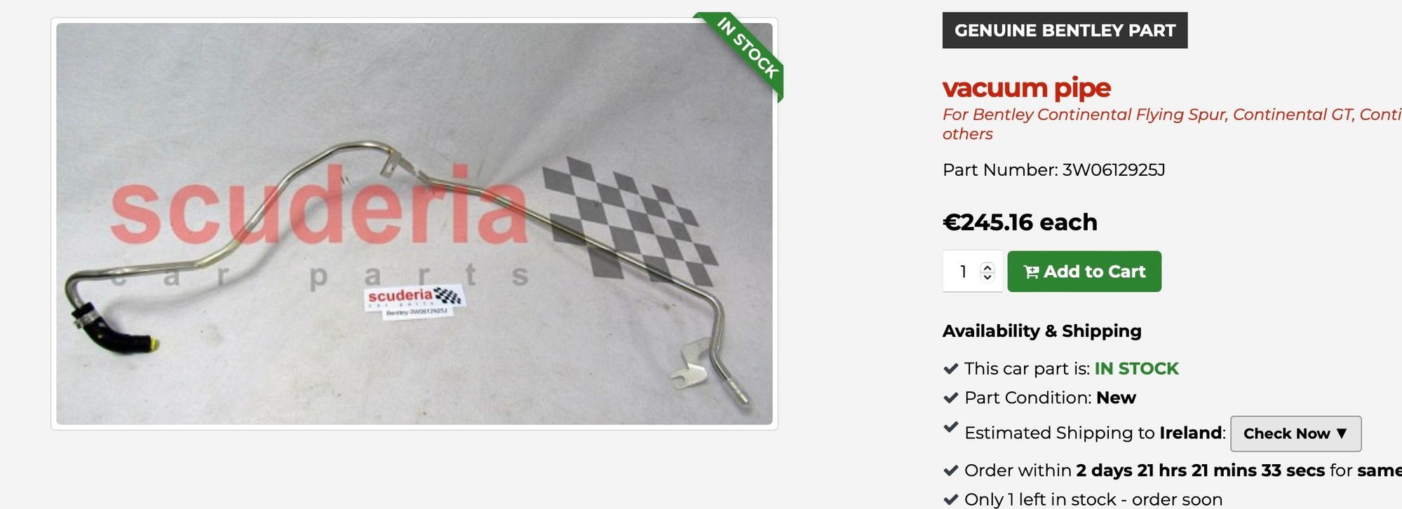

The lines were moved around 2006, so your car won't require engine-out to fix them.
At some point they also switched from plastic lines to metal. This is one of the turbo solenoid lines for my 2015:
The short bits of rubber hose on them *could* still deteriorate, but the real problem was the earlier plastic hoses splitting at the barbed connectors.

thanks for getting back to me I’ll just smoke test it and if it checks out leave them for now .
