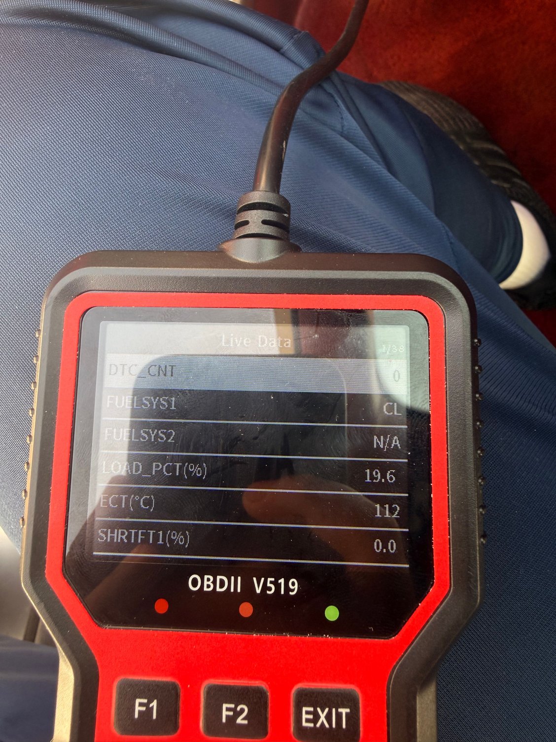

Another update
I received the car from the dealer, plugged in my obd2 scanner that has live data, while driving on the highway at 130kmh-80mph, the real coolant temp is 107-109c and when doing wot runs it reaches till 117C and on idle it is stable at 112c, is this too hot?
ECT Engine Coolant Temperature is 112c at idle and stays there.
when revving the car while stopped the temp goes all the way to 115-116c
