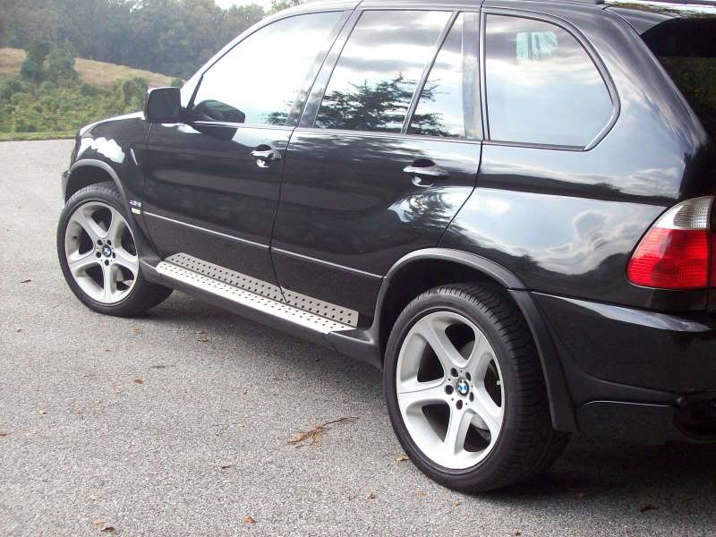

Here is my 2002 4.6 model. It is up for sale incase someone is interested.
