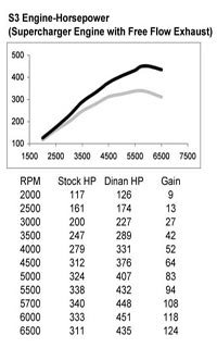

How about this?
450hp < $11K
http://www.dinancars.com/store/produ...cat=470&page=1

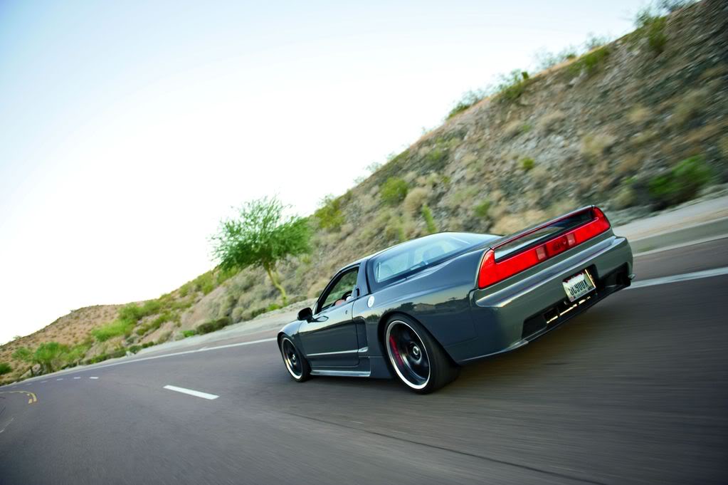

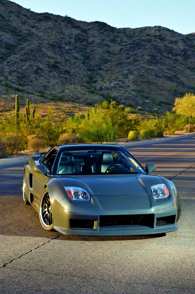

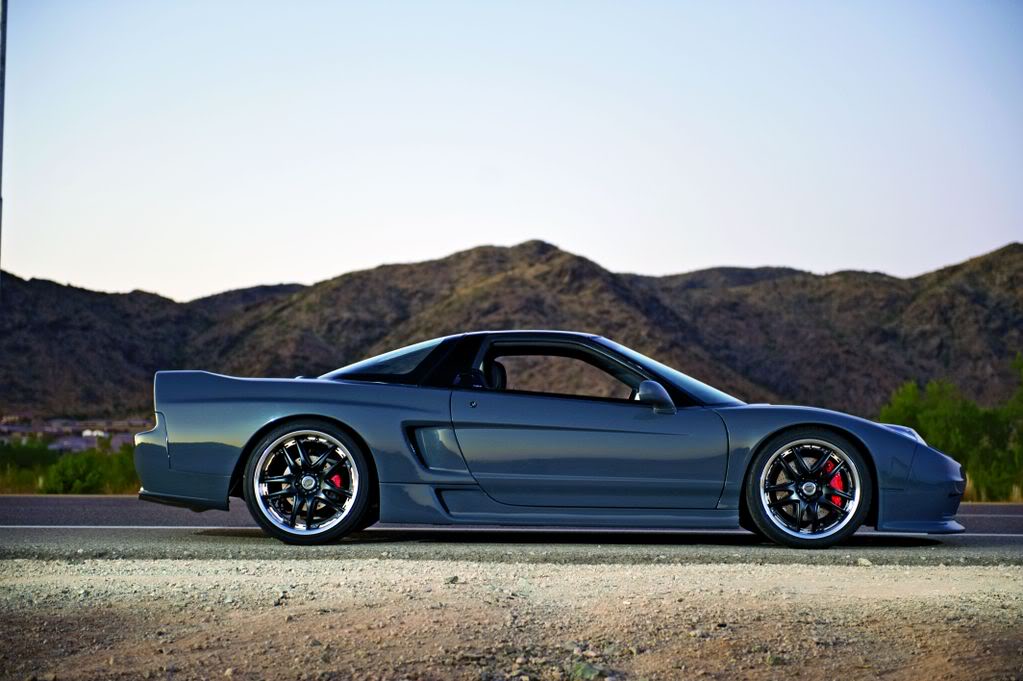

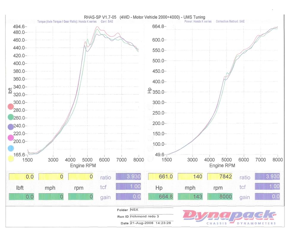

here is the last car i built...just sold it to another 6speeder
I have decided to sell my baby…It is the 93 NSX shown here in the pictures. It has been great car for me The car was bought by me from the original owner and has spent its entire life in Arizona, Florida or Dallas. I have owned it for about four years. During this time I have spent considerable time in building what I feel is the ultimate, streetable NSX. No area of this car has been overlooked…From the braking, to the body and paint to the 665 plus horsepower…..no shortcuts, no expense spared…just the best car I could put together. Now that it is finished and I have enjoyed it I would like to start the next project…The wife says I need to sell one of my toys first though…
This car was built to be driven…I drive this car between 8000-12000 miles a year and it has never failed in anyway. It handles like it is on rails and is quick enough to give your stomach butterflies.
I promise, you will not see another NSX like this, anywhere. People will stop you to talk…people will stare at you at traffic lights….people will take pictures at gas stations…it definitely draws attention.
The car is featured on the cover of the April 2009 issue Modified Magazine with a full article inside.
This car would cost a little over $120k to duplicate and while I don’t have to sell this car, I would like to see it go to a good home. I feel it is priced accordingly and fairly. I may also be open to trades…don’t be shy make me an offer.
If you have any questions you can contact my anytime, with any questions.
I have the title in hand and can help arrange shipping if needed.
Asking $58500
Exterior modifications
Cantrell Studios Wide Body Conversion Package
Cantrell Studios GT-Series Front Bumper
2002+ headlight Update kit: all factory parts:
2002+ factory style carbon fiber composite hood
Downforce 02 Style Sports Rear Valence, modded for a single exhaust
Volk Racing GT-V wheels, 18 front. 19 rear
Custom paint, color is called Grigio Telesto from a 07 Lamborghini lp640

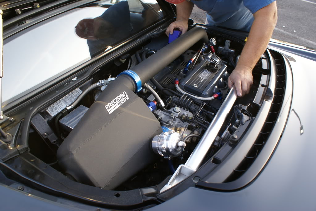

Engine Modifications
ScienceofSpeed forged low compression piston with Xylan skirt coating, rings, pins, & locks
bush small rod end for floating piston
MLS head gasket set
polished crankshaft journals
full cylinder head & cylinder block internal gaskets, seals, & bearing set
new timing belt
mill heads, valve job, & gas check
disassembly & assembly of engine, set ring gap, blueprint clearances on rotating assembly
big flange stepped sleeved cylinder block machined & honed
balanced & blueprinted rotating assembly
ARP head stud kit
sized billet chromoly steel connecting rods
ScienceofSpeed 36mm SS intake valve set
ScienceofSpeed 30mm Inconel exhaust valve set
cylinder head port work
Locking Timing Belt Tensioner
ARP NSX Main Stud Kit
ScienceofSpeed LMA Kit
ScienceofSpeed Dual Valve Springs
ScienceofSpeed Titanium Valve Spring Retainer Set
ScienceofSpeed Billet Oil Pump Gear Set
ARC Baffled High Capacity Oil Pan
ScienceofSpeed NSX Billet Camshaft Plugs
Stage 2 NSX Front and rear Engine Mounts
Engine assembled by Ffej @ Science of Speed in Tempe
PWR Radiator with built in water/oil oil cooler
Custom dual 10 inch radiator fans

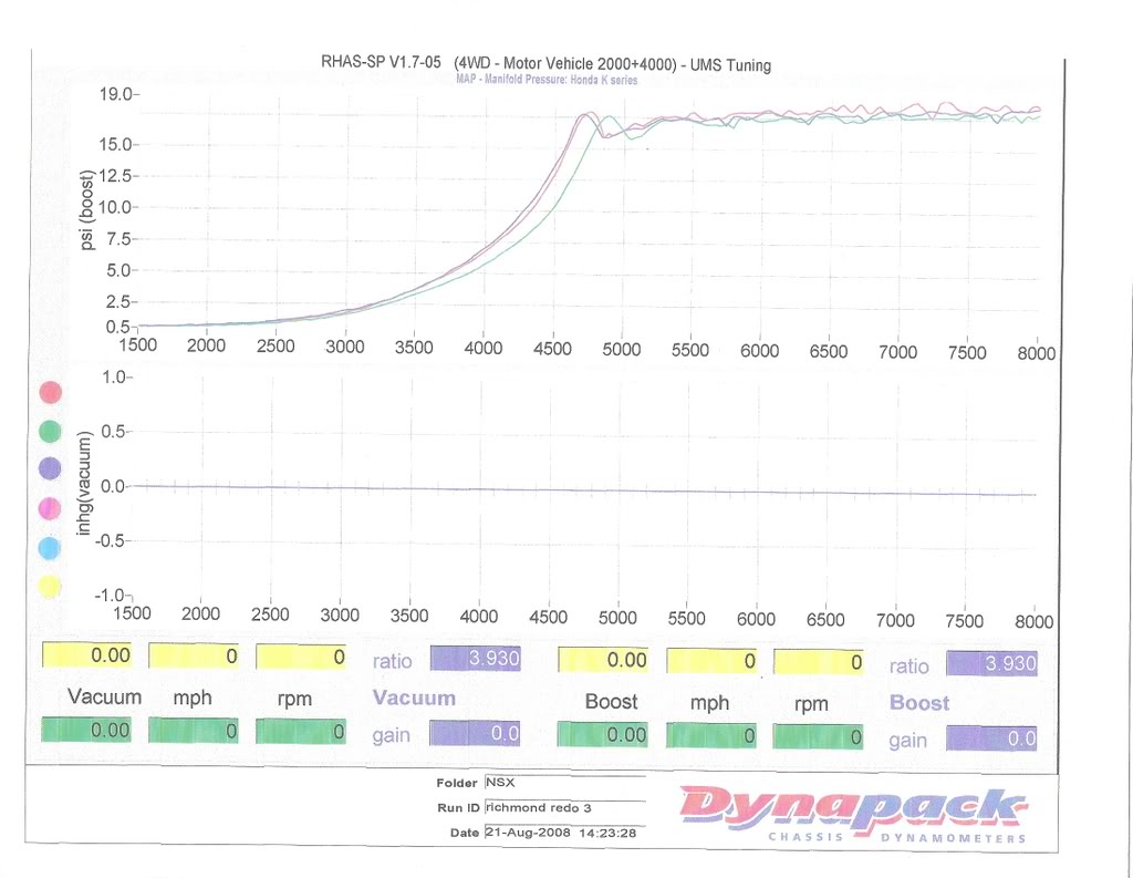

Custom built at home Headers and turbo manifold
Custom built at home turbo system
Precision Turbo pt67
Tial wastegate and blowoff valve
4 inch downpipe, 4 inch muffler, and 4 inch single exhaust.
Air to water Intercooler
AEM ecu tuned by UMS in Tempe
RC 750 injectors
Walboro 225 HP fuel pump
Upgraded fuel lines and filter

pretty car.. nice work.
