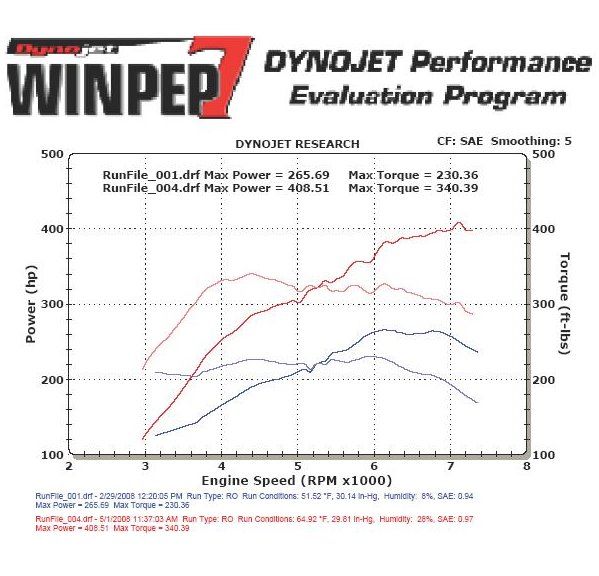

There are 4 of us on Cayman Club with the TPC turbos. RWHP runs from my "low" 408 to 423 with headers, but my peak torque comes arrives sooner. Look at the Dyno sub forum in Modifications.
I was the first delivered customer car and the long install was because of some final fitment and exhaust tip changes and their work load. The dyno is from TPC.

The TPC kit has a single friction type modified Garrett with a liquid-to-air intercooler attached to a GT3 front radiator. The ECU is left alone and a piggy-back unit controls two fuel injectors (that help with the charge cooling too) just before the plenum. The plenum intake is changed from the angled one to a 90 deg to accomodate the plumbing. There is a wastegate, a new cone filter, and a new catback.
Power delivery is surprisingly very linear because of the variocam and the exhaust sounds great. The car feels no different until 2700 rpm and then the turbo starts spooling up and the car starts pulling hard all the way to redline. Early on I was bouncing off the rev limiter because the revs were building so fast.
A Porsche shop owner said the car could be quicker than a 997 turbo...power is equivalent but the CS weighs 400 lbs less. With the original taller first gear than a 997S, I think the Cayman would have to play catch-up. I'll let you know when I come across a turbo.
New rears will be a good idea, since my Porsche dealer shop manager drove the car and grinned when he broke loose in second. The TPC owner has broken loose in third. His stock clutch started slipping after a bunch of quarter mile runs, but he can deal with the new power now with just the change to the 997S clutch. His CS was a half second and 5 mph quicker in the quarter than a 997 GT3.
My boost is limited to 5-1/2 lbs so it is easy on the engine...so I'm not worrying the warranty especially after the months of TPC testing. When you reach your goals with the TT setup, you'll gonna love it.
