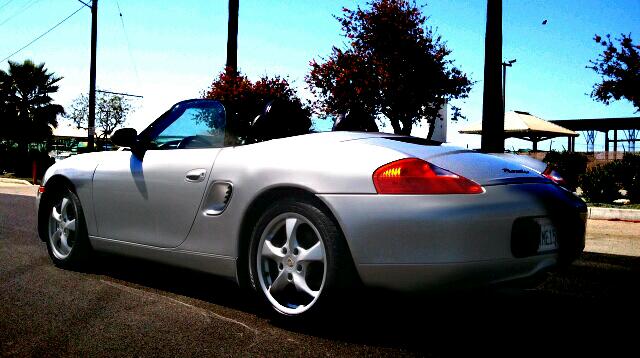

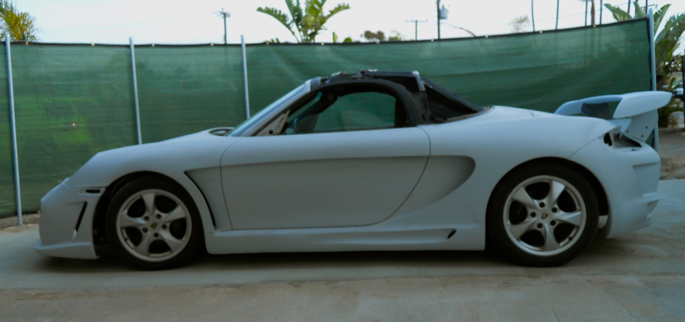

My employee had the itch to build a customer Boxster. Thought it'd be fun to add onto this older thread, and show everyone what he's decided to build. He's using a different style front bumper on his car. This car started out as a very clean 1990 Boxster w/ 66K miles, which drove and shifted flawlessly. The top was torn, so it'll be getting a brand new one. The interior will be going Ultrasuede, charcoal & what they call Regal blue with contrasting stitching. Just ordered the Ultrasuede today. Most likely the interior will be going a diamond pattern on the seats and door panels. He hasn't picked the exterior blue paint color yet... but is leaning towards a House of Kolors blue pearl. But may go for a nice looking blue they used on a Bugatti (I'm trying to talk him into that).
Below is a "before" photo of the car... and a current photo today.

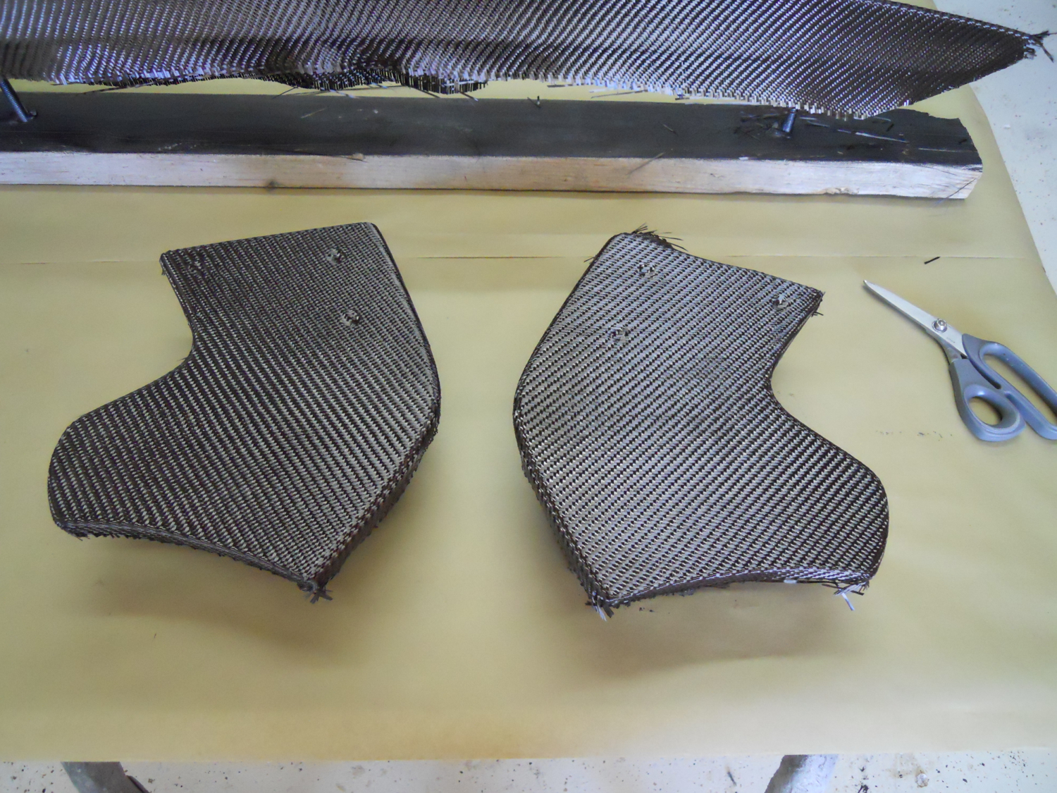

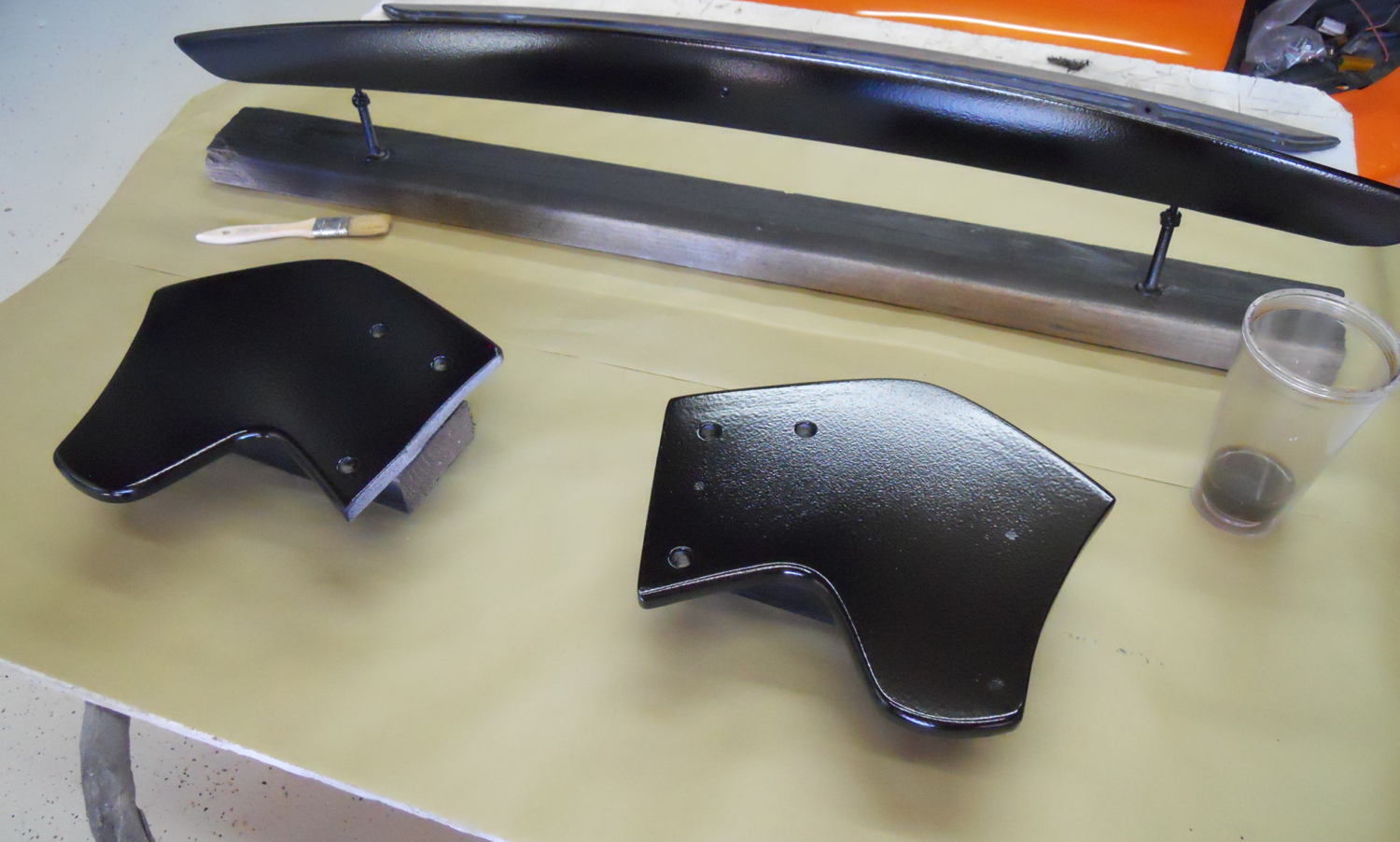

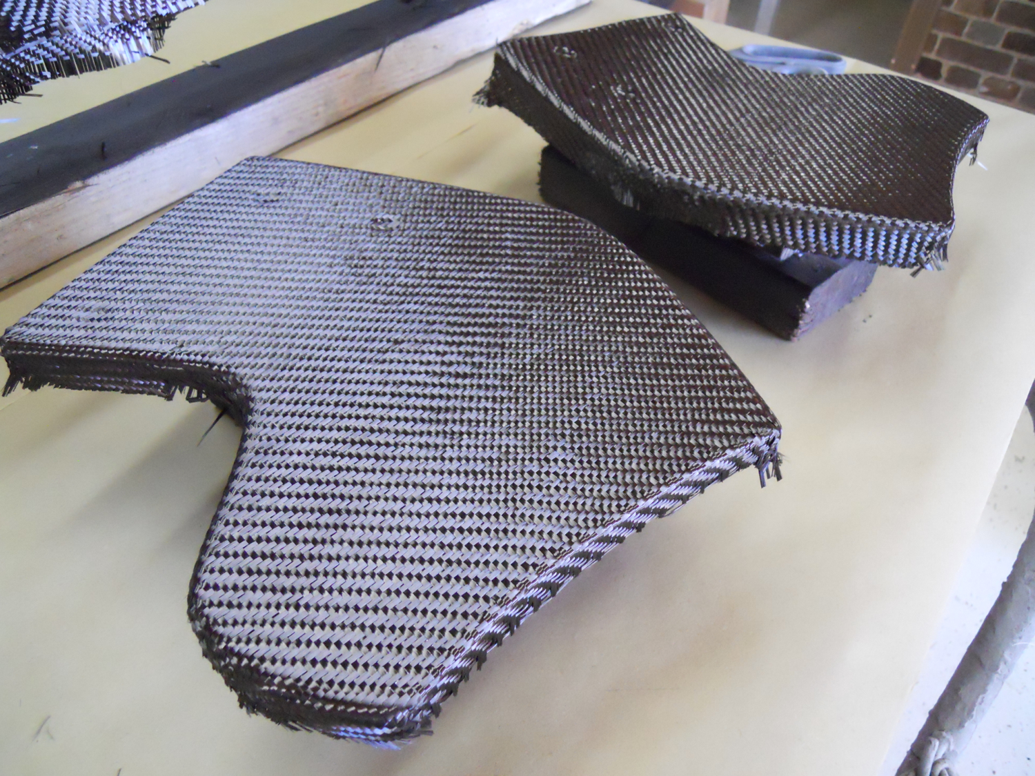

Today for a quick project we're doing a bit of carbon fiber overlay on the tail uprights. And also the very edge, (add-on blade) to the tail. Below you can see they are gel-coated black. The gelcoat works great because you can't see through the weave of the CF. And also it tacks up really nice, which allow you to gently lay the CF over the part and have it stick nicely in place. Once all the edges are laid down nicely, then it's time for the resin.

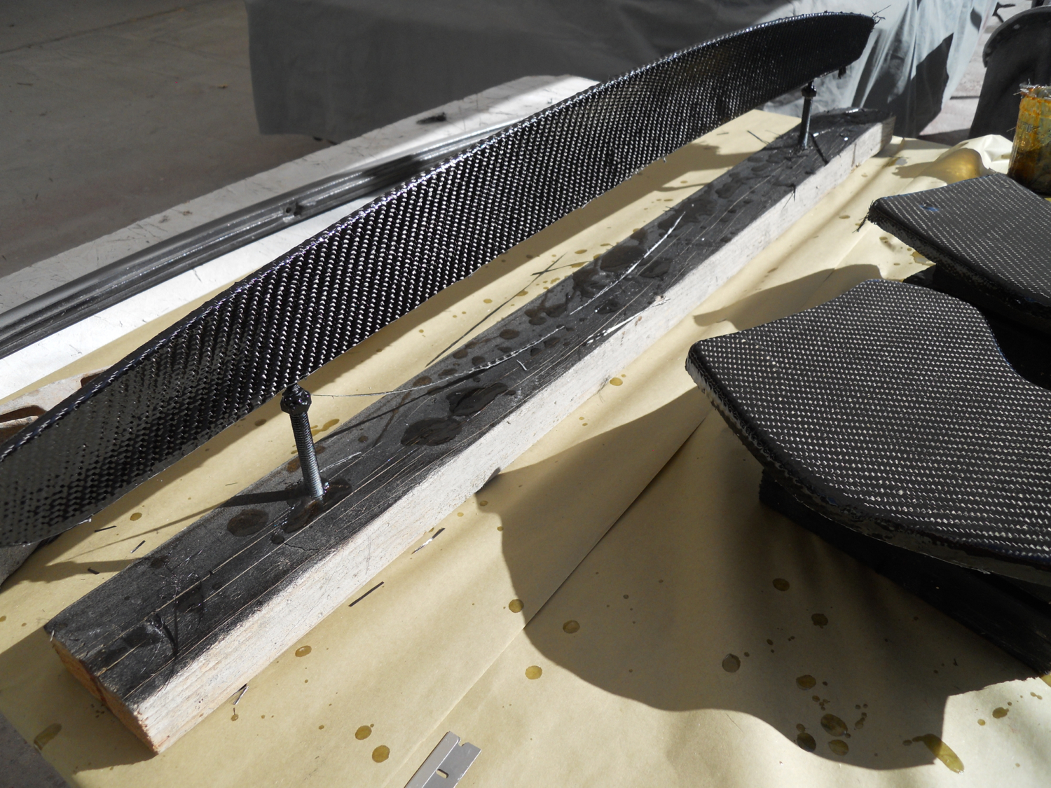

Here's the CF laid onto that black semi-sticky gelcoat.
Notice the special scissors for cutting the Carbon Fiber?

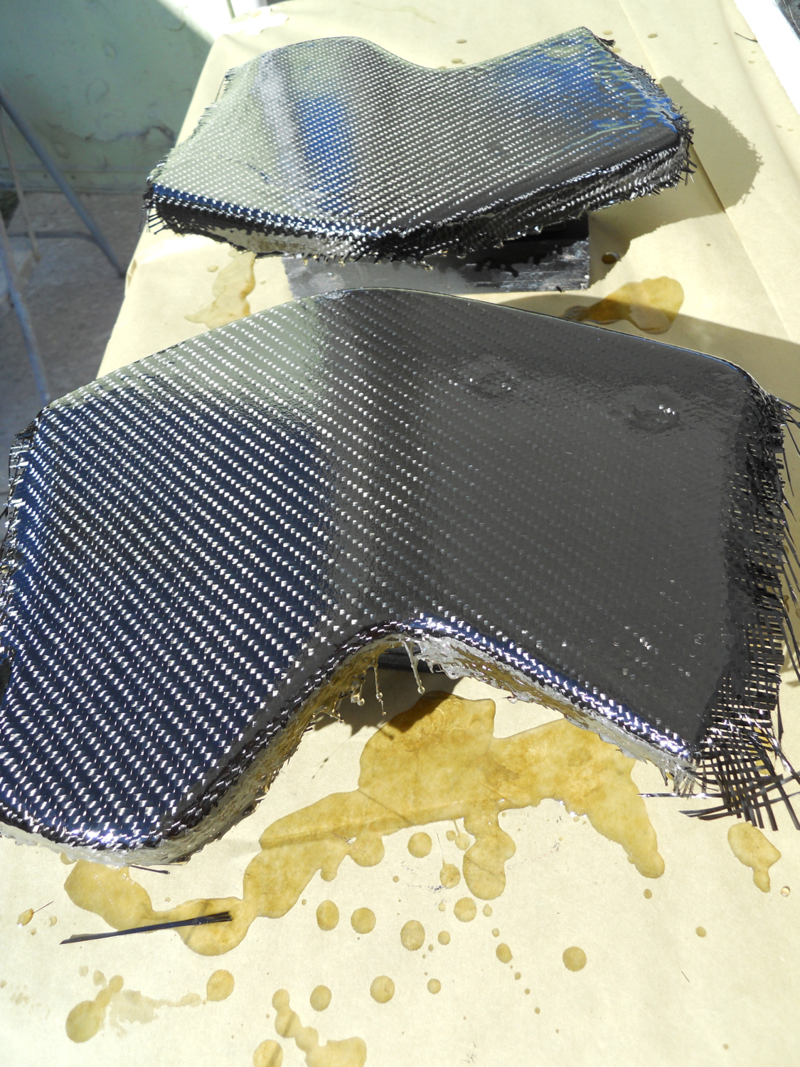

Here's a few shots of the CF with resin applied (epoxy resin).
Once this dries, another thin coat will be added to build up the
thickness of the resin a bit. The edges remain untrimmed till
the resin dries.

Here, the resin has dried. You have a bout 2 min. to catch the
resin at the correct time before it dries too hard. Then it will be
impossible to cut with razor blade). Once the edges are cut, then
it's time to sand this resin down, smooth it out. If we put the resin
on nice and evenly it should sand nicely. Then time to flip the part
over and CF the back side of the tail pieces. The tail edge blade
was done both sides at the same time. So no need to flip it and do
another side.
To sand the resin nice and smooth, we'll use 220 wet sandpaper.
Add some soap to the water makes it easier to sand smooth.

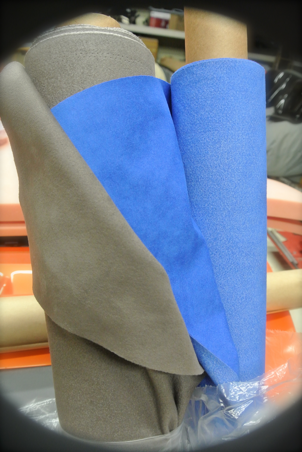

The UltraSuede has arrived!
