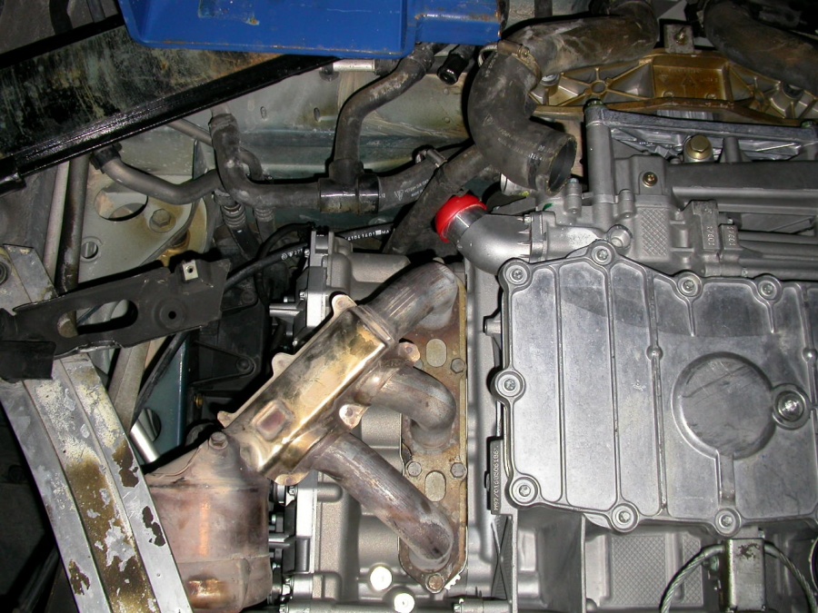

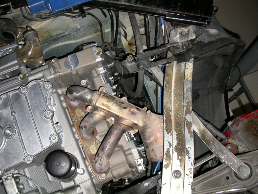

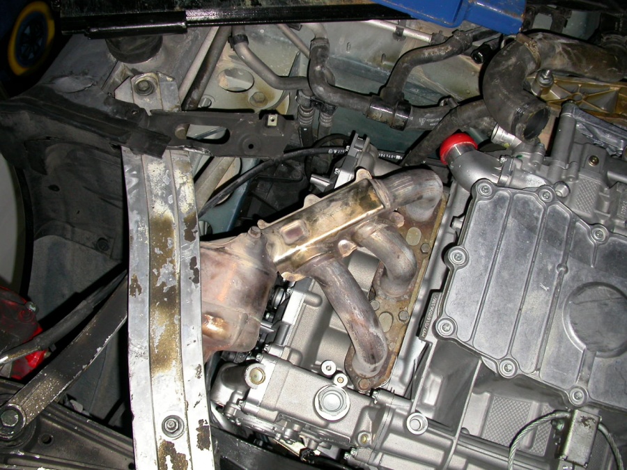

Jeremy,
Here are some pics of stock 987 manifolds on a 3.8L engine in a 986 chassis.
-Todd

Damn.... I don't know. With the cats it's going to be really close. Here is a typical 3.2 liter Blower setup we run:
Todd, you have as much experience as anyone with this - what do you think?

Originally Posted by 3.6L Boxster
You don't want to use any 986 based system with the larger motor as the port size on the 986 headers are too small for the larger ports on the heads of the 3.6 and 3.8 motors.
-Todd
I know this is true with STOCK applications, meaning you would definately be restricting your flow quite a bit with a stock set of 2.5 liter headers on a 3.8 liter motor... HOWEVER - worst case scenario they WILL fit... The Stock 3.2 liter and 2.7 liter headers will NOT clear the supercharger because of the extra cats. An aftermarket 3.2 liter header WITHOUT cats might be your best solution as far as clearance goes, and with the larger port size should also flow the most air. This would obviously mean relocating your 02 sensors to before and after the secondary cats.

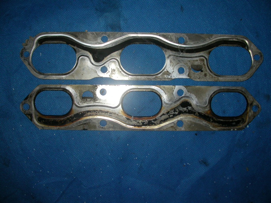

Jeremy,
You are probably correct that unless you fab your own setup you may be limited to headers from the 986 platform.
Illustrated below is the difference in port size between the early 2.5, 2.7 and 996 3.4 heads (bottom of first picture) and the later 987 3.4 and 996/997 3.6 and 3.8 heads. There is quite a difference.
Also shown is a Fabspeed 987 catless header on a 3.6 X51 in a 986 chassis that may work with the supercharger. These are very similar in design to the factory 3.8L headers from the 997 that would be pretty easy to mod to work in the 986 chassis as well.
I think the only solution is to get your hands on some of the options and see if they will work. Personally I wouldn't use any of the 986 headers.
-Todd
